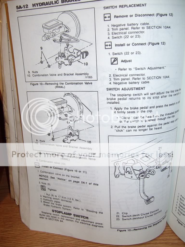

Well this should answer your how hard is it level question
remember use line wrenches on the lines so you dont strip em
also the brakes are gonna have to be bled after this repair

So not too difficult but still probably beyond my skill level, I may have to break down in the end and do it myself but that will only be as a last resort. About how long should something like this take? also how much are line wrenches? and how do you bleed the brakes?
