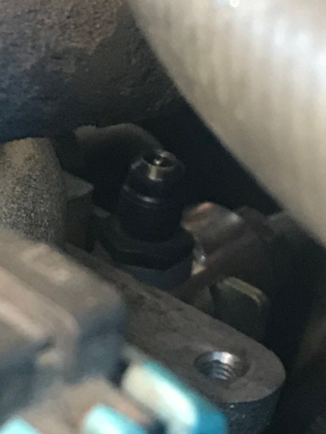

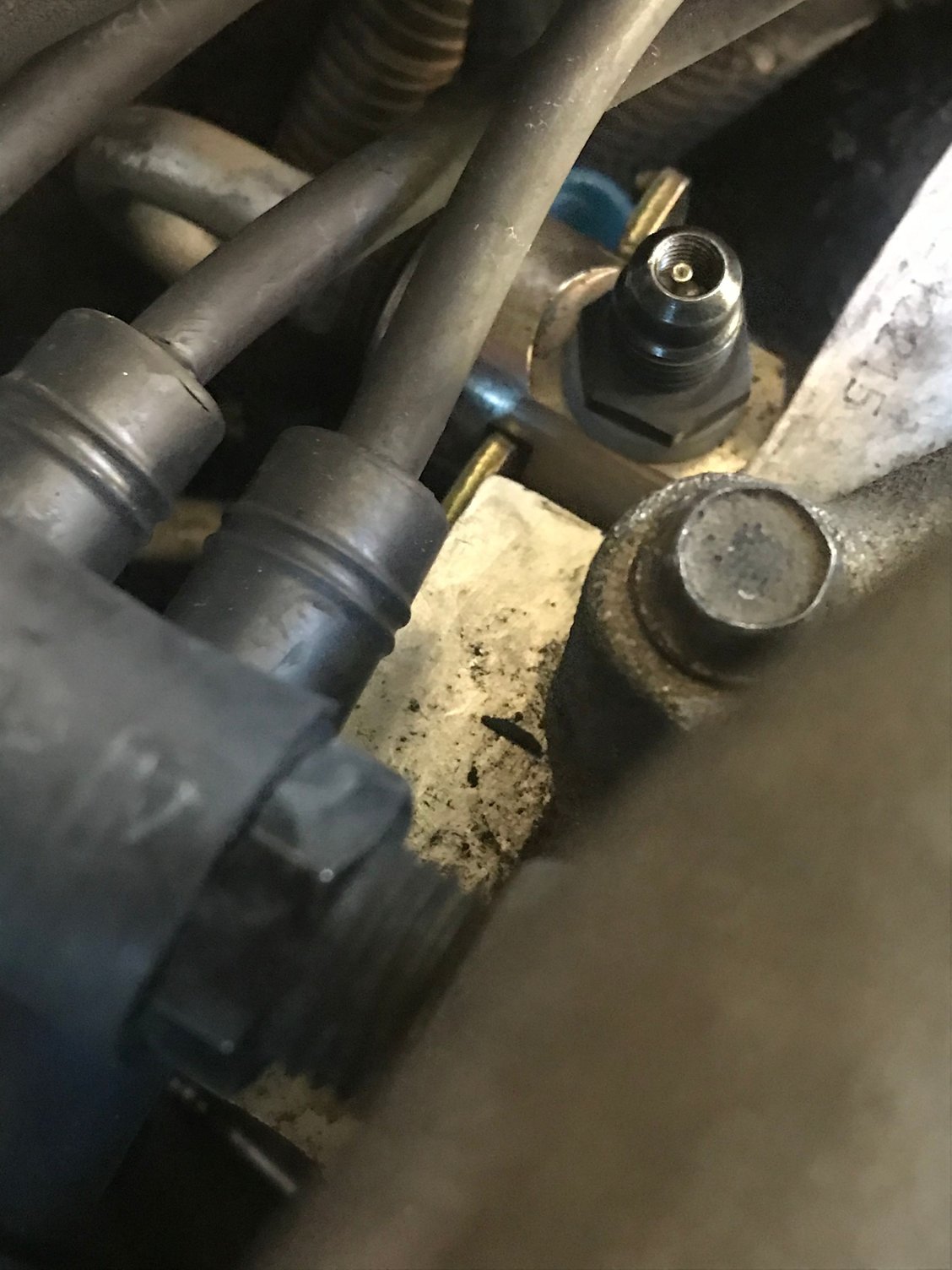

Gyumin 10-23-2019 01:14 PM
These are the best pictures I could get of the valve, it's towards the back of the engine bay, and pretty hard to reach for a short guy like me.

To me they look like standard Schrader Valves, but all kits I found in town didn't have a connector for it.

GeorgeLG 10-23-2019 02:29 PM
That looks like the garden variety fuel fitting found on all of my chevys and most of my vehicles. It’s a Schrader port and the common size is a 4AN which is 7/16-20 threaded and a 37 degree (JIC) flared end. There are other sizes and I am not familiar with every year of the Blazer but you can find which threaded nut of a known size fits those threads and confirm the port size with this article:
https://fuelab.com/understanding-fue...apered-thread/
