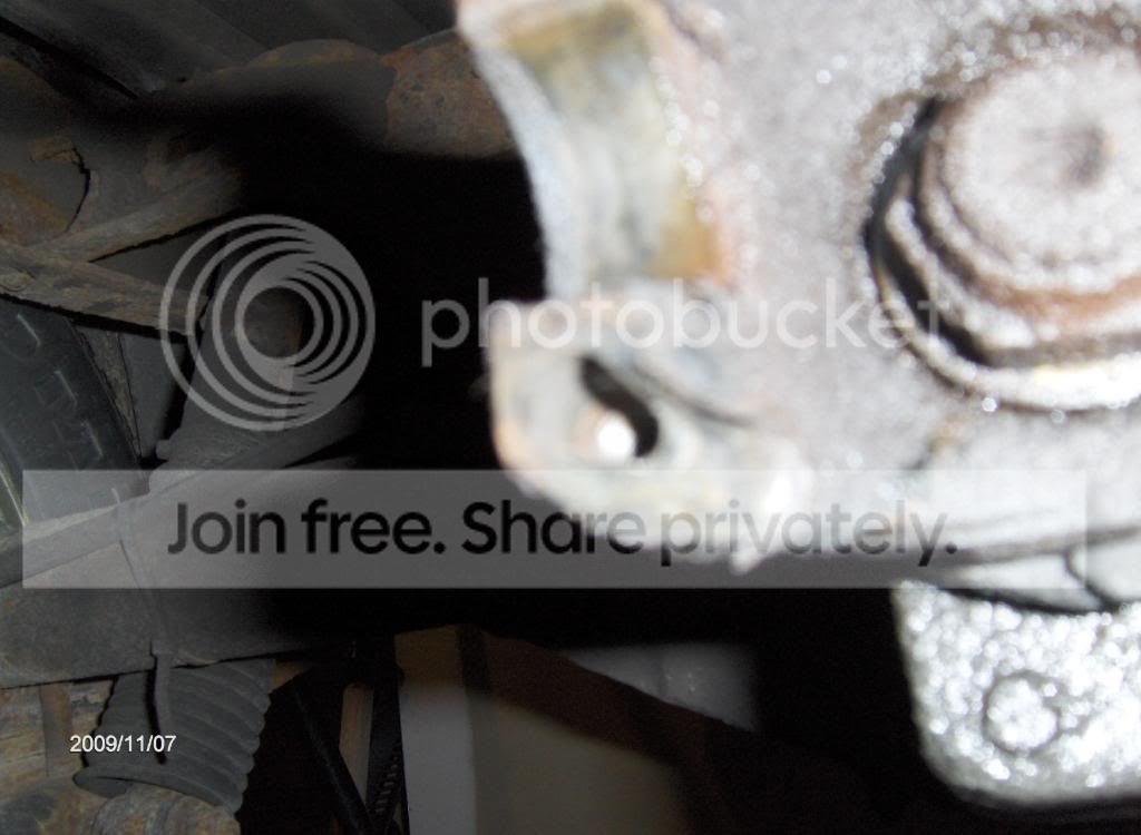

i heard the typical "clang" when shifting from "drive" to "reverse". no biggy (is that even a word?........) it's just needs a universal (so you change both of them). the problem is, when i went to pull the drive shaft on Saturday night this is what i found;
i gave him my spare drive shaft that i had from a '98 Jimmy i stripped (same O/A length, spline), but.........
my BIG question is, will the yoke from the '98 Jimmy fit on his '94 diff?
i don't want to remove the diff yoke on his truck until i'm ready to swap it, and i want to know if they're the same before i do that.

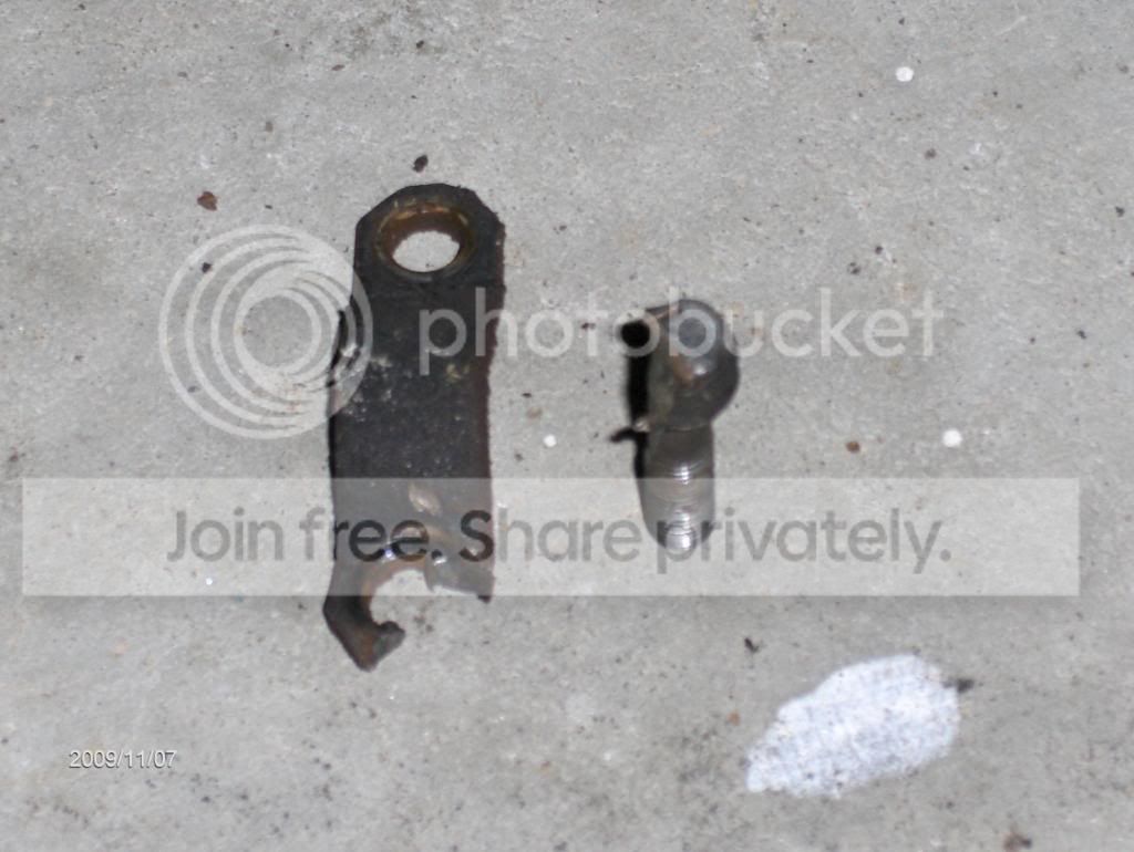

awesome same thing happen to my 1991 K5 blazer the strap broke like that i dont know if they r the same butwhen mine broke i went on ebay and bought a used Slip yoke from JUST CHEVY TRUCKS. I have bought a few things from them for my truck there Very good and know what there talking about. In case they arent the same i would maybe give them a look if ur trying to pick up a used yoke instead of paying for a new one here is his ebay site http://myworld.ebay.com/just_chevy_trucks
