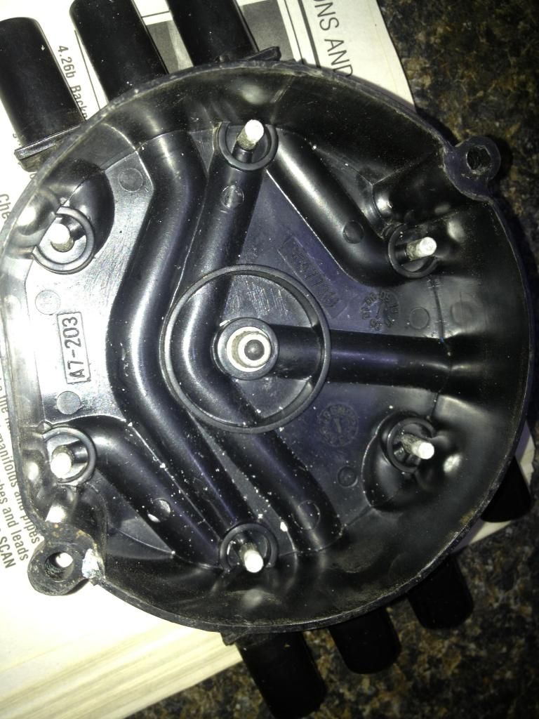

Update:
Replaced cap and rotor with ACDelco(with dielectric grease on all contacts).
Replaced plugs- ACDelco 41-993(with anti-seize lube) and Autolite pro Series Wires(with dielectric grease on all contacts).
Was not able to locate distributor vents, will try again when warmer and more light. Ran IAT and ECT tests via Car Chip Pro(I love this thing) see below.
Fuel pressure tested when it started this(tested correctly), will run again next weekend.
Found the following, #2 spark plug loose, all spark plugs incorrect gap(but ACDelco plugs mixed types[41-993 & 12607234]), after market cap(contact with rotor half the size of ACDelco) and rotor(corrosion on cap & arc marks on rotor) see below.
The vehicle did great, started in outside temp 26 degrees, did not sputter. But still going to find distributor vents, since its possible that cap was still warm and dry from changing cap.
Special Thanks to Captain!
Now onto flush and lots of other stuff.
Last edited by AcerDeucerQ; Dec 29, 2012 at 08:53 PM. Reason: spelling and added pics
Nice job! Sounds like you got it! Item #1 in the image below shows the vents. Some of the later distributors have slits instead of screens. GM TSB, (Technical Service Bulletin) instructs to remove the screens (if equipped) or clean the slits, (if equipped). Bottom line is, whatever it has, they need to be clear for adequate ventilation.
