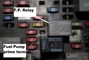

Captain Hook Sep 29, 2012 08:45 PM
1 Attachment(s)
I agree, check the ground. GM hasn't used the oil pressure sender to disable the fuel pump since the 80's. On your 2000, the fuel pump relay feeds the fuel pump directly, no other circuits are involved. If you apply battery voltage to the pump prime terminal in the underhood fuse panel, the pump must run:

Post #4 explains how to activate the pump, (your 98 fuse panel is the same). Check for battery voltage at the module connector while applying battery voltage to the pump prime terminal in the fuse panel. Also check resistance on the ground wire at the module connector to chassis ground, must be less than 5 ohms. If both are ok, the pump needs replacement.
