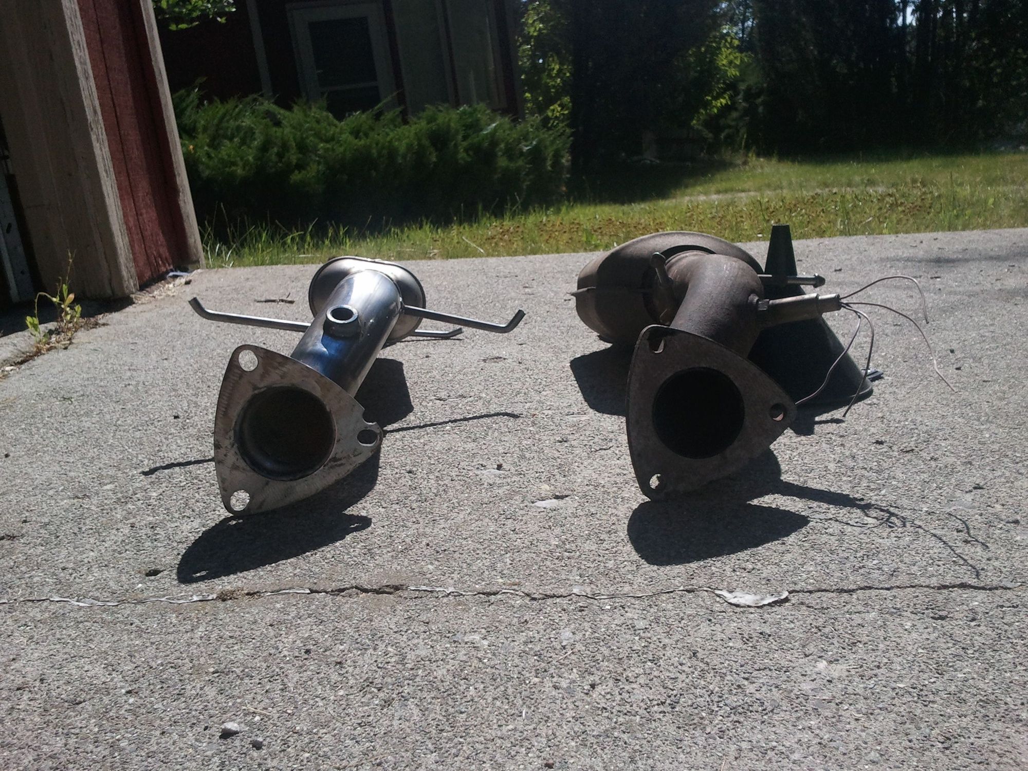

I purchased a catalytic converter for my 1999 4dr, 4wd Blazer. When I did a trial fit of the part I found that the bung for the O2 sensor was in the wrong place, on the top-side of the pipe so that when the sensor is installed, the sensor would hit the underside of the body preventing the converter from being mounted. The proper design is to have the bung situation so that it at the side. (See pictures below)

https://cimg1.ibsrv.net/gimg/blazerf...0f7eccc3cd.jpg
Underside of cats; new on left, old on right. Note how the O2 sensor needs to come out of the pipe to the side.
https://cimg8.ibsrv.net/gimg/blazerf...ec9b5ca032.jpg
Muffler end view showing the incorrect placement of the bung for the O2 sensor on the new cat converter (on left).
https://cimg0.ibsrv.net/gimg/blazerf...bcb59c714c.jpg
Top view of converters showing the incorrect placement of the bung for the O2 sensor on the Ultra Exhaust converter that would prevent the converter from being installed if the O2 sensor were in place.

Since you live where you were able pick up the part yourself, I'm curious what kind of outfit they are? I only ever got an email from someone named Najib and what the emails said made me think they were are reseller of parts, not the manufacturer. I even told him/them that they should be grateful I had spotted the imperfection so that they do not have any future unhappy customers. To that I got no response.
Because of constraints on my end, I went ahead and had it modified. I found a oil pan drain for the one hole and had an exhaust shop install a new bung for me in approximately the right location. It is not quite were I wanted it but we'll see when it cools off enough for me to install it. (100'F+ here today.)
I thought I was getting a good deal on a catalytic converter but I had to spend an additional $80 for a total of $215, including shipping on it. I figure as long as it lasts, cost-wise it is a wash. Of course that does not include the frustration factor! LOL

I would plug the top bung and then drill a hole and weld in a new one
christine_208 07-31-2018 10:23 AM
Yeah, that s what I had done yesterday. Will install it this evening or tomorrow. The extra cost was about $80. Grrrr.
