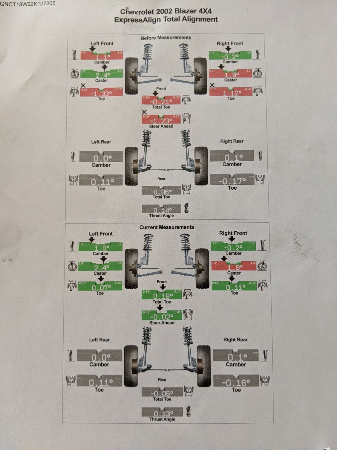

Originally Posted by error_401 (Post 725480)
What wheels (rims) are on that Blazer? OEM ones? Or some aftermarket?
These are the OEM wheels for the 2002 models that have the console shifter (which mine has). They have cosmetic imperfections, but they're still structurally sound.
Are the wheels running true? (lateral and vertical, when checking on the rims)
Do you mean is the caster alignment good? I was told that the passenger side caster was maxed out and couldn't be adjusted, but Pepboys assured me that the alignment is good. Here's the diag print out they gave me.

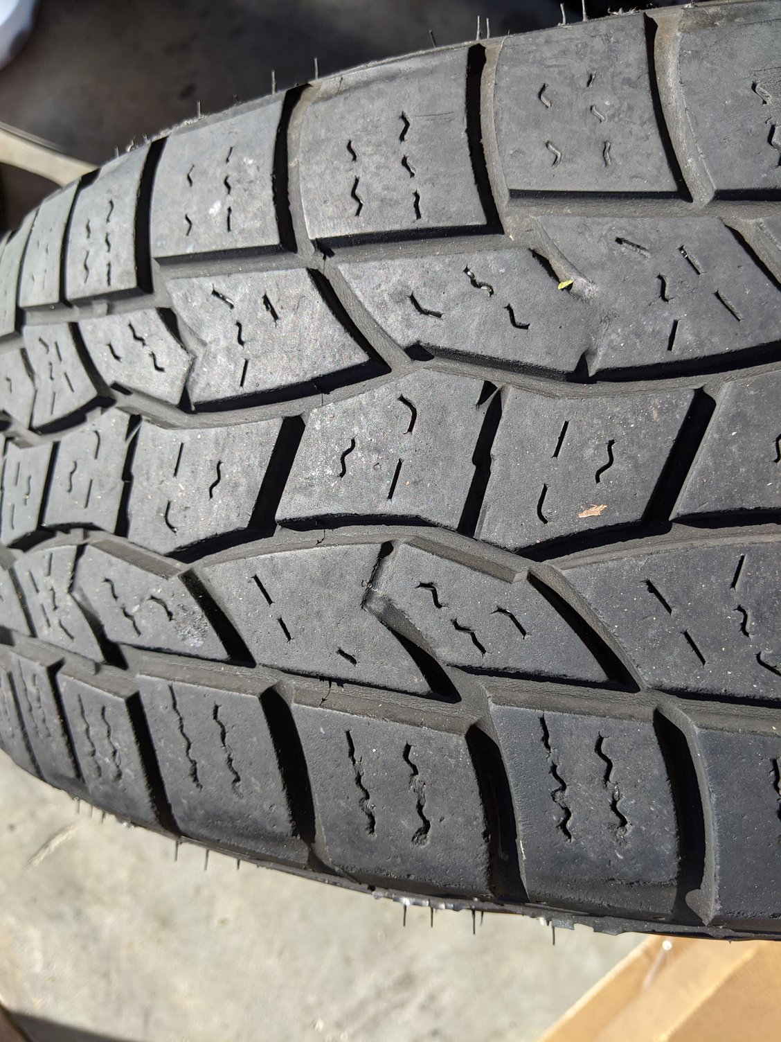

Here's the previous tires I had with the cupping. I still have these A/T tires. I'm currently running H/T tires I bought new.
https://cimg4.ibsrv.net/gimg/blazerf...326c8d9ae8.jpg
Inside tread top of image.
https://cimg7.ibsrv.net/gimg/blazerf...7bfb32366c.jpg

GeorgeLG 08-03-2020 09:51 AM
The angle on those tread wear pictures is not great for seeing the problem. Is it inner or outer tread blocks that are ramped or is it cupping spread across the entire tire surface?
George

Sorry for the bad photos. I currently have the tires stored at a remote site.
It's the inside that's cupped. It's not really visible, but you can feel it.

Is it every so many tread blocks or are they all kind of ramped?

Yes. I had all 4 balanced when I got new tires installed. Yes I didn't check mine. That's what I saw on Rock Auto for mt model Blazer. These are the OEM wheels for the 2002 models that have the console shifter (which mine has). They have cosmetic imperfections, but they're still structurally sound. Do you mean is the caster alignment good? I was told that the passenger side caster was maxed out and couldn't be adjusted, but Pepboys assured me that the alignment is good. Here's the diag print out they gave me.
https://cimg9.ibsrv.net/gimg/blazerf...46c77c6135.jpg

Sounds like you have systematically eliminated several culprits. But I know I've been tricked several times by where I thought a noise or vibration originated.
It appears to be vehicle speed, not engine speed dependent, which means that it can include all four wheels, the front suspension and steering components, and rear drivetrain.
