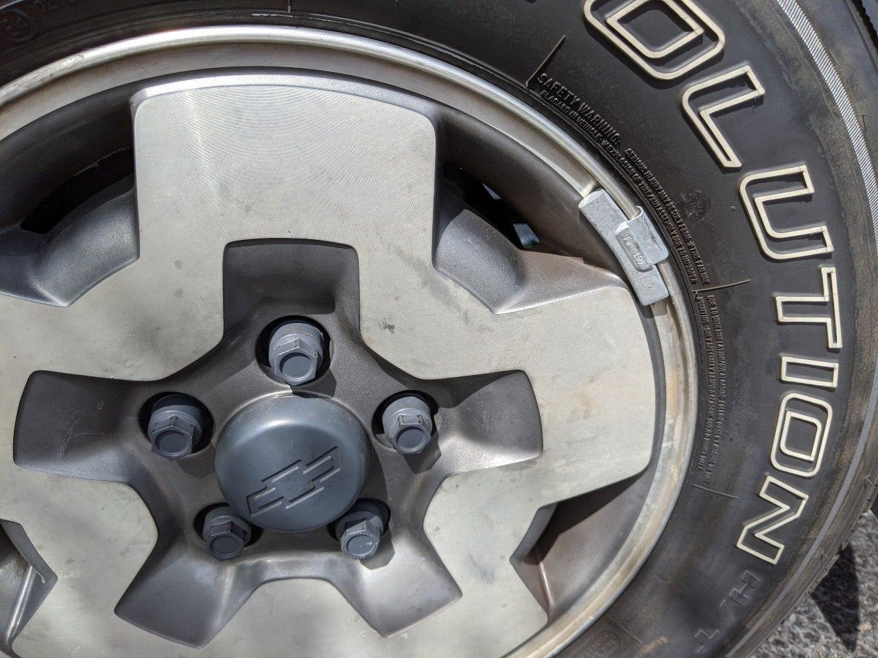

https://cimg5.ibsrv.net/gimg/blazerf...d437a1bd2c.jpg

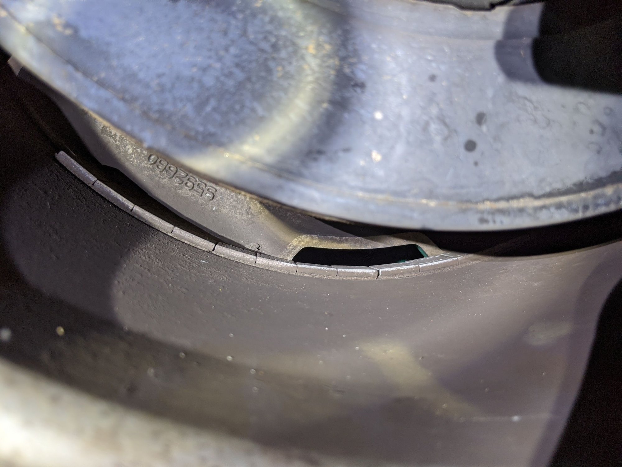

The weights before were more or less how they are now. Just only on the inside. The tech said he pulled them all off and re applied them. Seems he added more.
I'll post some photos of the weights, cause it seems odd that so many were needed. The passenger side has the most.

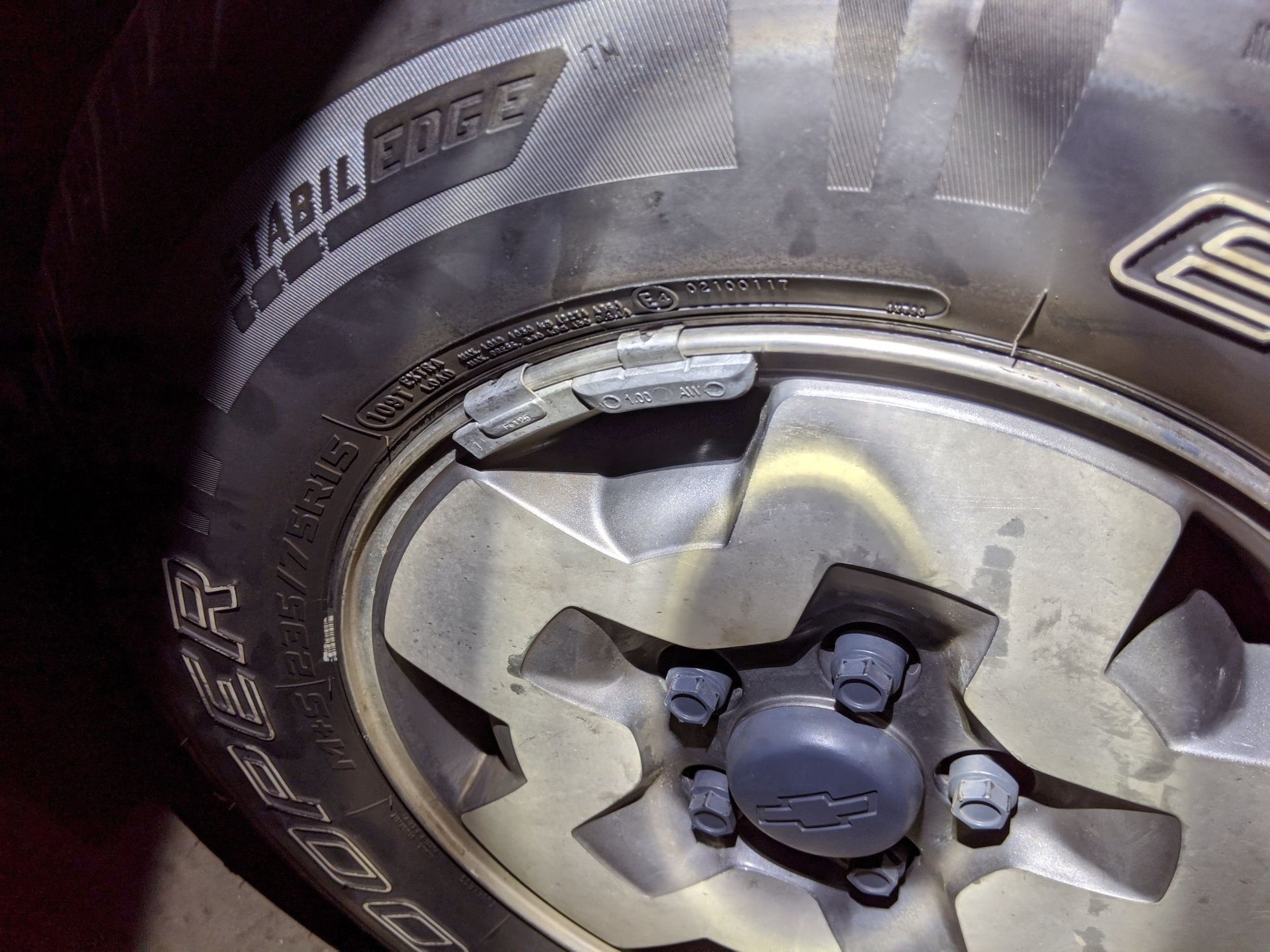

https://cimg6.ibsrv.net/gimg/blazerf...a7ff7924f0.jpg
Rear passenger with these strange inner-rim weights.

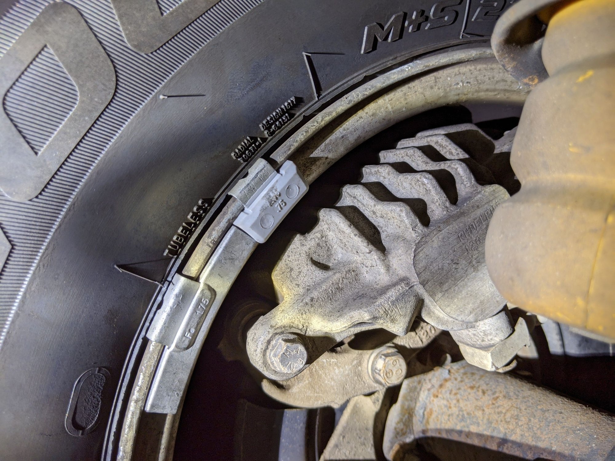

https://cimg8.ibsrv.net/gimg/blazerf...3899b48257.jpg
Rear passenger inner weights.

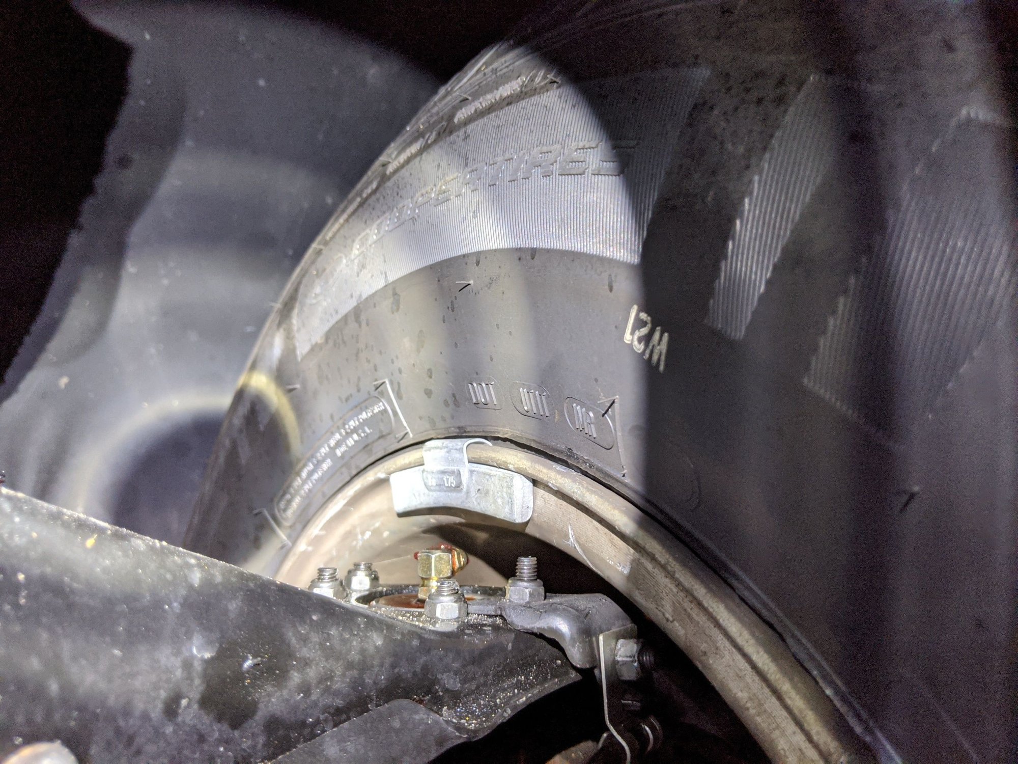

https://cimg9.ibsrv.net/gimg/blazerf...d26b1a0df6.jpg
Rear driver inner weights

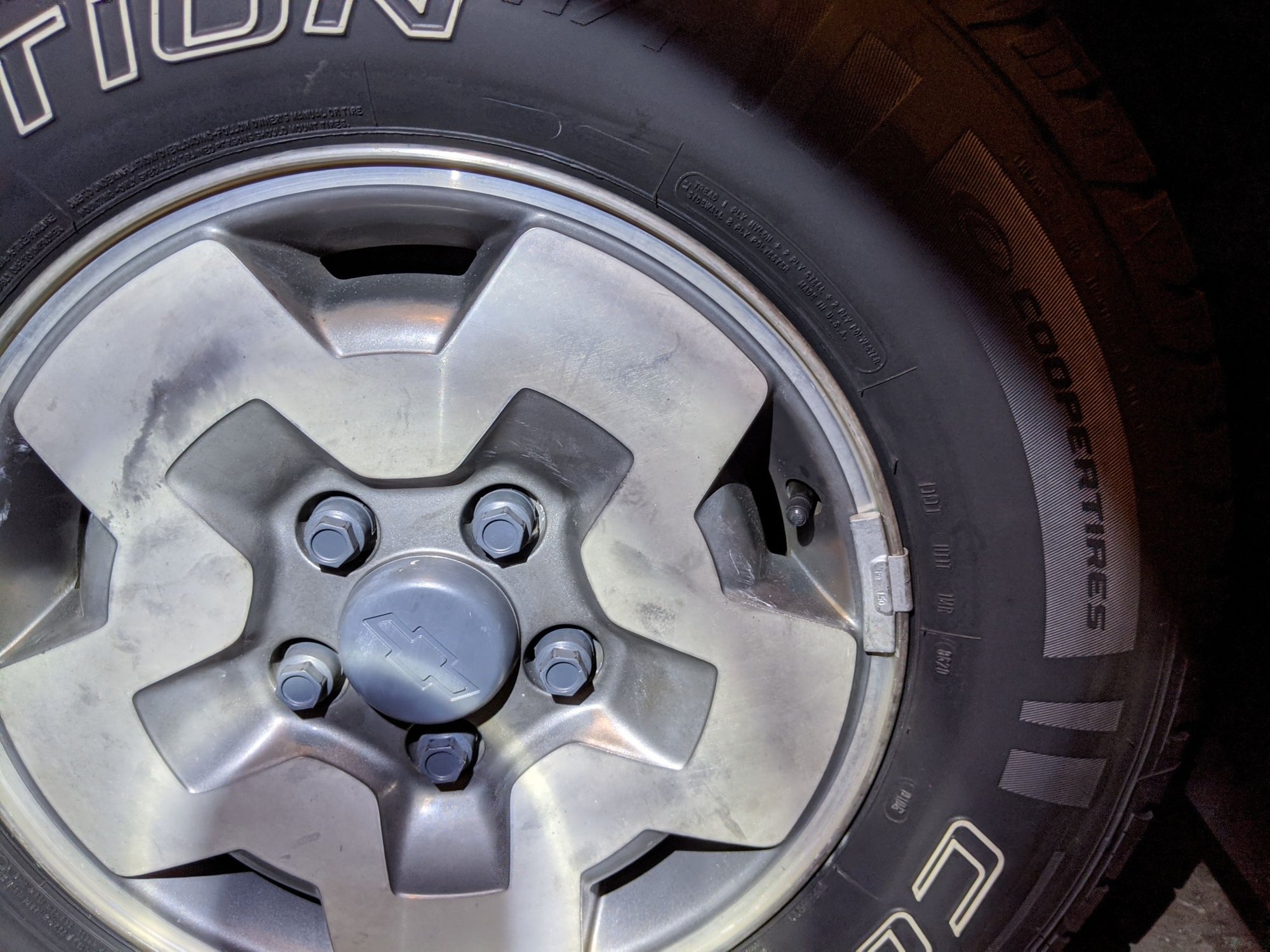

https://cimg0.ibsrv.net/gimg/blazerf...9fd0bc02a5.jpg
Front driver inner weights

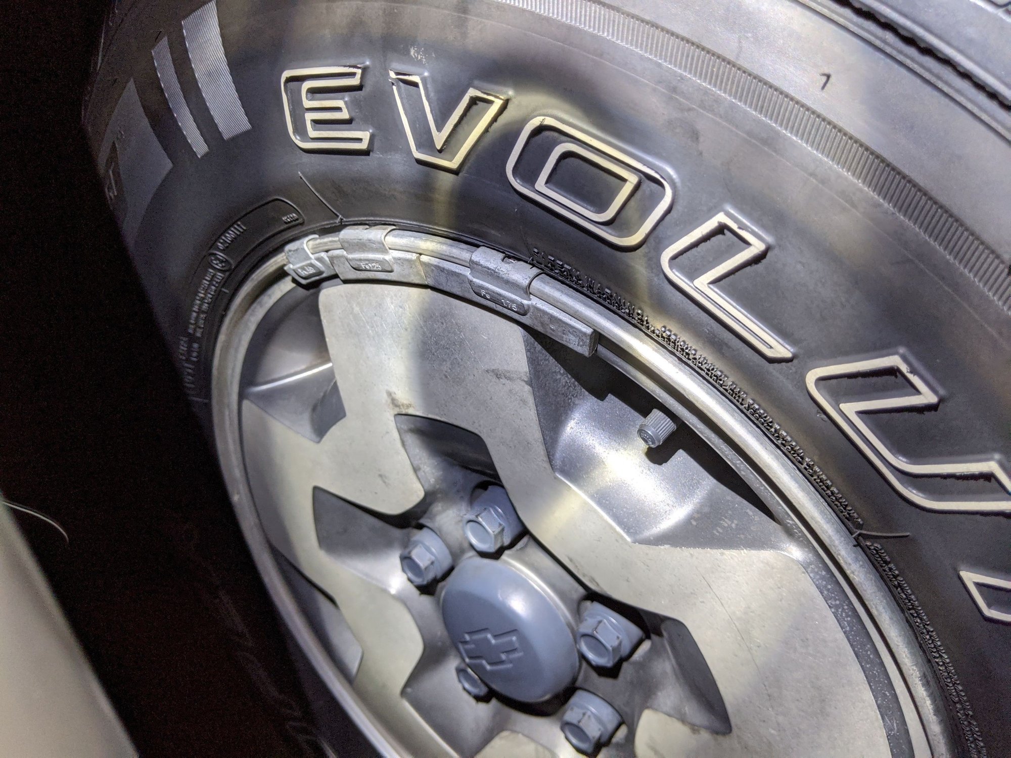

https://cimg2.ibsrv.net/gimg/blazerf...88a558ddd2.jpg
Front driver outer weights.
https://cimg7.ibsrv.net/gimg/blazerf...7ce1037673.jpg
Rear driver outer weights.
https://cimg8.ibsrv.net/gimg/blazerf...8de9a5961e.jpg
Front passenger outer weights.
https://cimg9.ibsrv.net/gimg/blazerf...b62548a14f.jpg
Rear passenger outer weights.
Billy1820 08-06-2020 03:31 PM
Wow that looks like @ss. Who the hell puts clip-on weights onto the outside of an aluminum wheel.
Billy1820 08-06-2020 04:08 PM
On a more constructive note, that is A LOT of weight. Normally tires need no where near that much to true up. I’m thinking the idiots at pep boys probably should have mentioned that to you, but it comes as no surprise.
I’ll take a bet you’ve got a problem with at least one of your tires. Excessive heat and other issues can cause the tire belts to squirm or begin to delaminate; sometimes this isn’t readily visible.
Your felt vibration may be another issue altogether, but I’d take my bets on a bad tire.
DonL 08-06-2020 04:36 PM
I've noticed that using that many weights is a cause of a) a bent rim, or b) the tire bead isnt sitting right, they should have let the air out and turned the tire 1/4 turn on rim.
