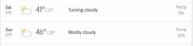

Also, looks like I may have gotten lucky
