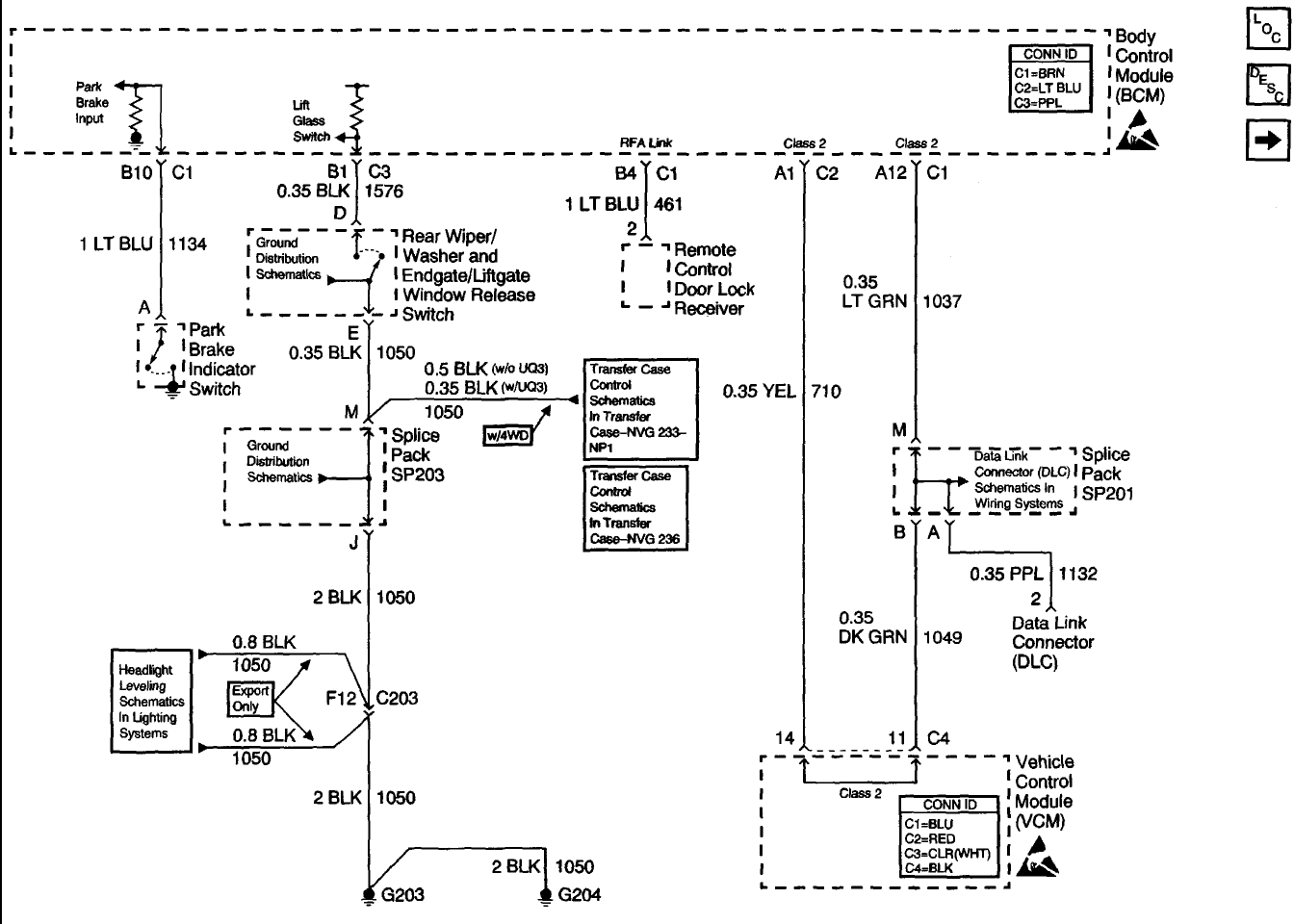

I've already checked the wiring back there and everything LOOKS fine. I've checked where the tailgate hinges, and even had the tailgate apart and checked out the wiring at the actuator. It all seems good visually, but that's why I'm trying to track down a schematic so that I can see what I should have for continuity, grounds, etc. Is it possible that it's in the actuator itself at the back? Anyone had any experience with that?

I'll see what I can pull for schematics.
Here's what I could come up with from my online references for a 2000:
http://i11.photobucket.com/albums/a1...gate_input.gifhttp://i11.photobucket.com/albums/a1...ate_output.gif
