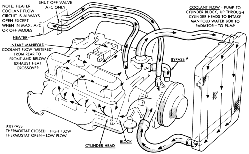

Hi. I am trying to figure out why the engine is overheating, and heater core is not supplying any heat.
When cold start, after few miles, I got heat from heater core, but when the temp gauge reaches cca 200, suddenly no heat from heater core. Also the temp raises more. I thought it might be bad thermostat, but I changed it 1 month ago, during head and intake gasket change. I preventively ordered another thermostat and radiator cap, because when the temp gauge reached 3/4, the cap let the water go out to the overfill tank.
I wanted to start from beginning, to be sure, that hoses to the heater core are plugged fine, but I did not found the scheme, or diagram. I am looking for something similar to this, but for Blazer. I am looking for it for two days, but still nothing found. Thank you for help!
Sorry for my bad English, I try to do my best :-)
https://cimg8.ibsrv.net/gimg/blazerf...eb3775183f.gif

Can you please specify the model and year of your Blazer.
Eventually also the engine version.

Hi, sure:
it's Chevrolet Blazer year 2000, 4,3 V6, 142 kW, vin W, engine code L35
Thanks!
error_401 Mar 8, 2018 01:50 AM
Try a search with "illustrated parts catalog - cooling system"
maybe here: https://www.gmpartsonline.net
