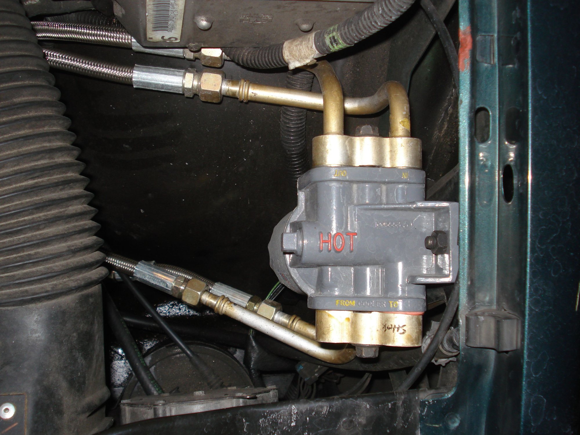

This should relate to your fix.
We used to fix that by putting fittings onto the aluminium lines and brided or rubber hydraulic hoses with appropriate fittings. Instead of a one piece (engine adapter to remote oil filter) I have a three piece oil line assembly. Hmm - have to look on the computer if i can find the pictures - found them, nothing better than to be too lazy to search and have all fixes stored on the NAS.
https://cimg9.ibsrv.net/gimg/blazerf...d84b1227c9.jpg
https://cimg4.ibsrv.net/gimg/blazerf...0d25c15eab.jpg
This fix is holding up since 11 years and not lost a single drop since.

I thought about doing the same, either flaring the tubing or using compression fittings like you did. It would work for power steering hoses, too.

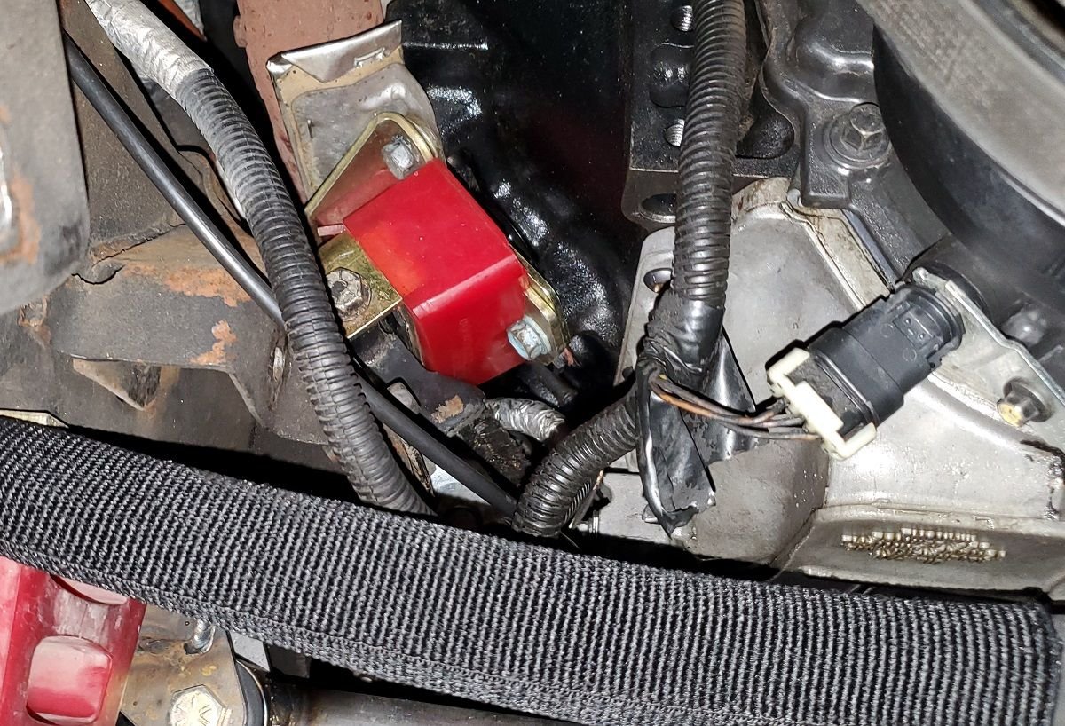

You mean like this...............
https://cimg9.ibsrv.net/gimg/blazerf...b29ea01901.jpg

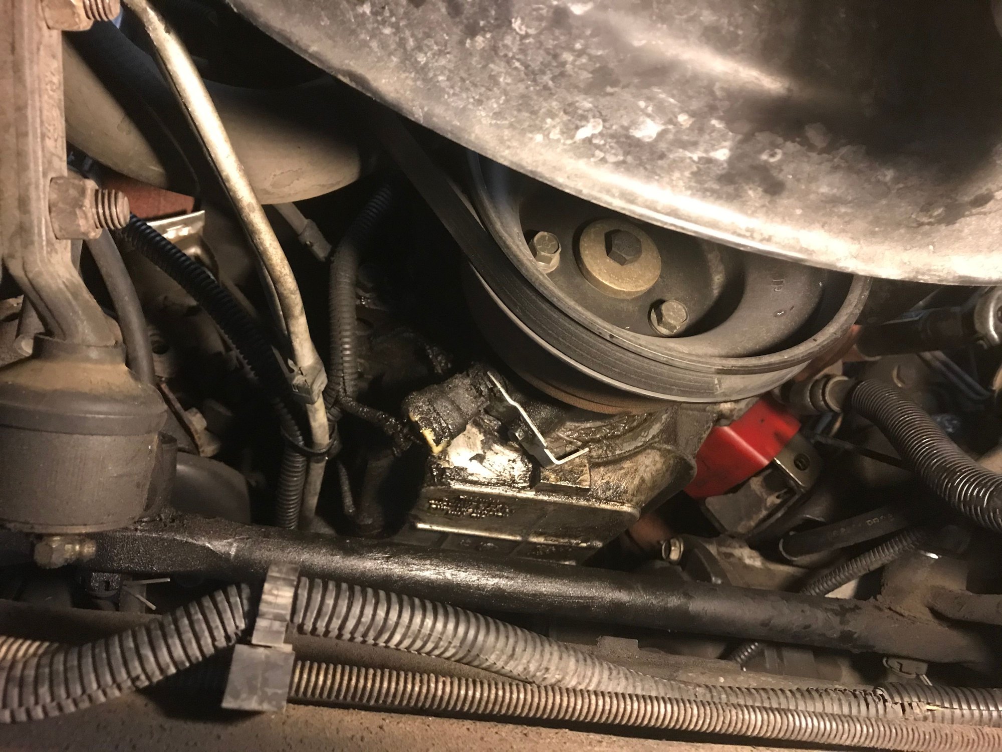

Here is the oily mess I am working with:
https://cimg0.ibsrv.net/gimg/blazerf...e76f5f2961.jpg

Today's update: have a problem with the poly engine mount. It bolts to the block just fine as shown in picture above, BUT....the other half of the mount, the one that bolts to the frame...bolt holes do not align. the poly mount would need to move forward about 1/2" to align all three holes.....I could only get the top bolt in...and that was a struggle. Soooo....these are not going to work. I get to remove the poly mount and replace with a rubber one. Not going to replace the right side mount as I am sure it is fine since it is always under compression. Which is a really good thing as I did look at those six bolts.....they are even more difficult than the left side!!
