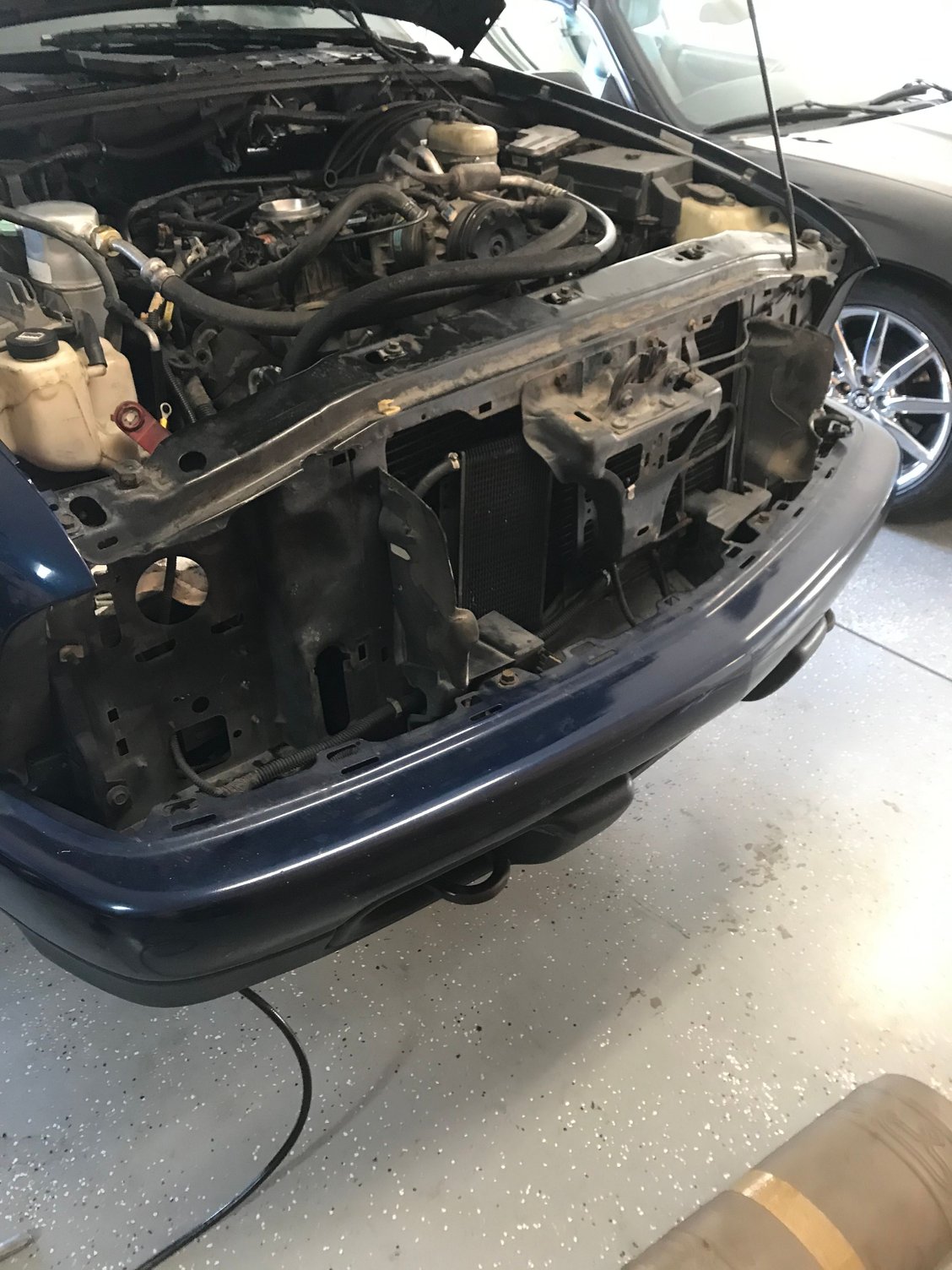

So far today I have a mess in the garage; the radiator, water pump, thermostat, crankshaft senor are all out. The timing cover bolts are out, but cover is not off. I need to let the coolant drip for awhile before getting back under the engine to see just how far the oil pan will drop down without dropping the diff. Maybe it will be enough to get the timing cover off without tearing the oil pan gasket....maybe not.
Will probably be a smart thing to do to get upper and lower radiator hoses; appears I tore the bypass hose in trying to jam the water pump pulley....so have to replace that hose for sure. I am definitely having an impact on RockAuto sales!! (I think I should buy some RockAuto stock.)

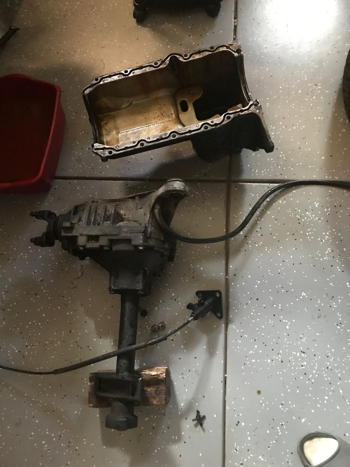

4/13/2020: Well....not exactly how I thought this would turn-out.....but.......
the pan is out....of course so is the diff.
I got the diff to drop down, but could not get the pan to come off...something was hanging it up. I tried turning the crank to different positions...but no-go. So after about 15 minutes of trying, I decided to take the diff out. So off came the spindle nuts, separate upper ball joints, removed brake calipers and rotors, removed the stabilizer drop links. Then pop-out the left axle out of the diff which I then got a visual reminder that I had not drained the diff....so I got a nice pool of gear lube on the floor. CRAP! Oh well....guess it goes with the engine oil and coolant already there....
Removed the same parts from the right side. Decided to remove the cable actuator from the axle....so off came those three bolts. Got the vent hose loose and after 15-20 min of twisting and such....the oil pan was stopping the diff....down and out came the diff.
Took a lunch break...came back to find-out why the pan would not drop. After many looks with associated pushing/pulling I found that there is a clip/clamp that holds the transmission lines bolted to the pan. I had not seen this as it was covered in oily grime....so got that off...but still would not come down. After looking around again I saw that the only thing it could be was again the transmission lines at the very rear. They was just not enough movement in them to get them pass the pan. Took a crowbar to slide them past.....and DOWN came the pan.
Sooooo....bottom line....the diff did not need to come out.
Got back under the engine to see what was holding the pan gasket from falling and found lots of RTV. Going to take me awhile to scrap all that off....plus I need to get the proper E socket to remove the two "bolts" on either end of the rear cap to get all the old gasket off. I will take a picture of all of this.
Now I have hours of cleaning ahead of me to get all of this oily grime off!!

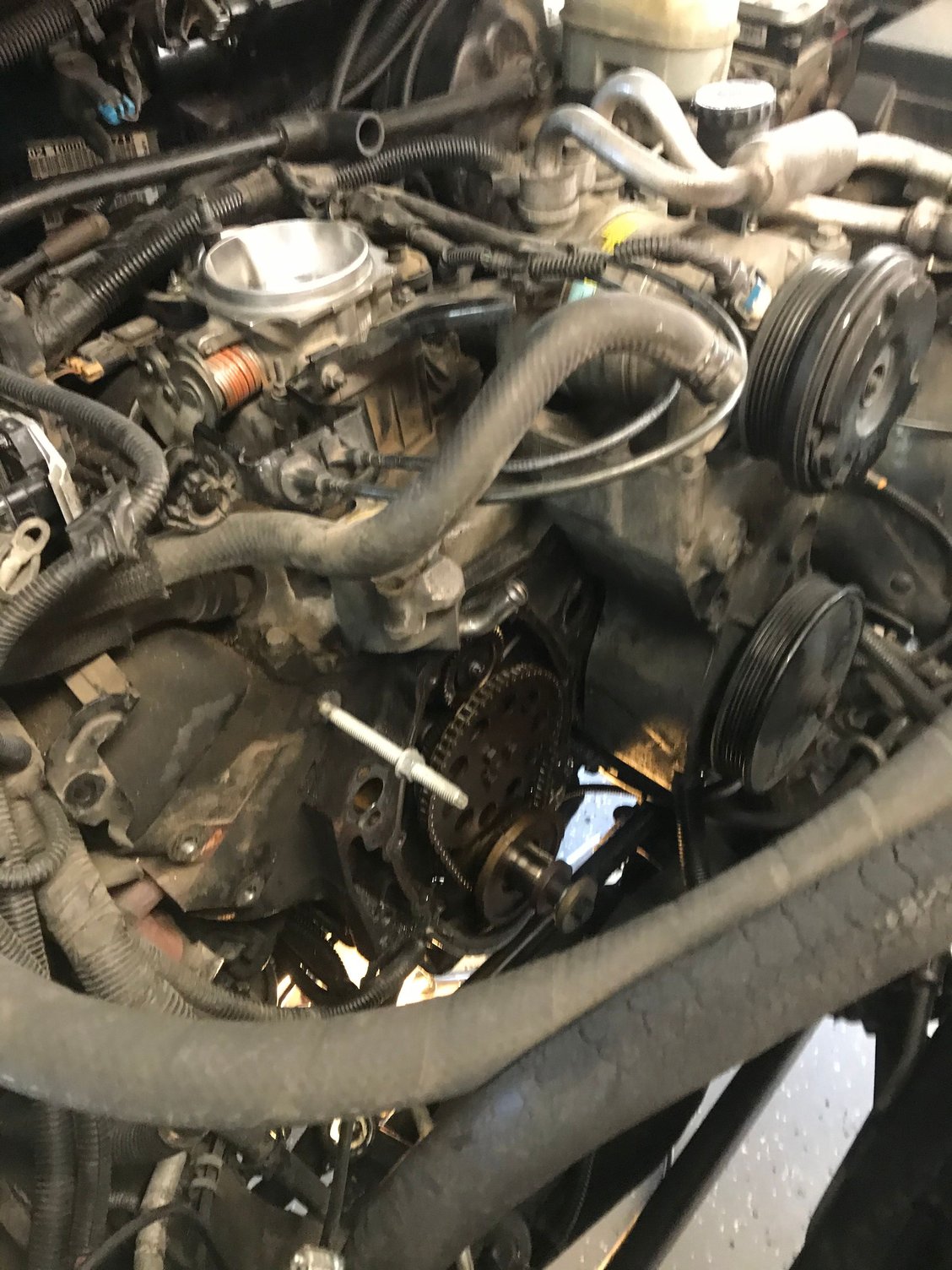

My engine does not have the timing chain tensioner, so I am going to put one on it. I have removed that reluctor wheel so I could align the crank and cam gear marks prior to removing the three cam bolts, then timing chain.
Also since I have the diff out, thought I would replace the inner seals. Might as well do something for all that added / unnecessary work I did removing it.
