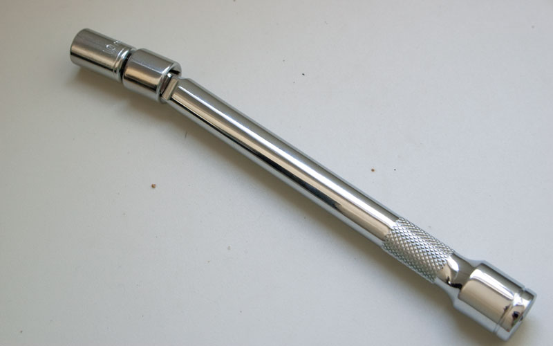

i havent had to do blazer handles before, but since they are similar to full size chev's, it should only be 2 bolts. one on the outside of the door and the other will be on the inside behind the panel. there should be an access hole and you might need a wobble extension.
http://members.modernvespa.net/fluff...gp6257_211.jpg
but other than that, it should be fairly simple. just dont bend the rods that attach the door handle to the locking mechanism. it will be a pain to bend them back to the right spot. getting the cylinder out should be simple. there is either a clip or a little tab that you might have to push in to get the cylinder out. then just repeat backwards to install.
