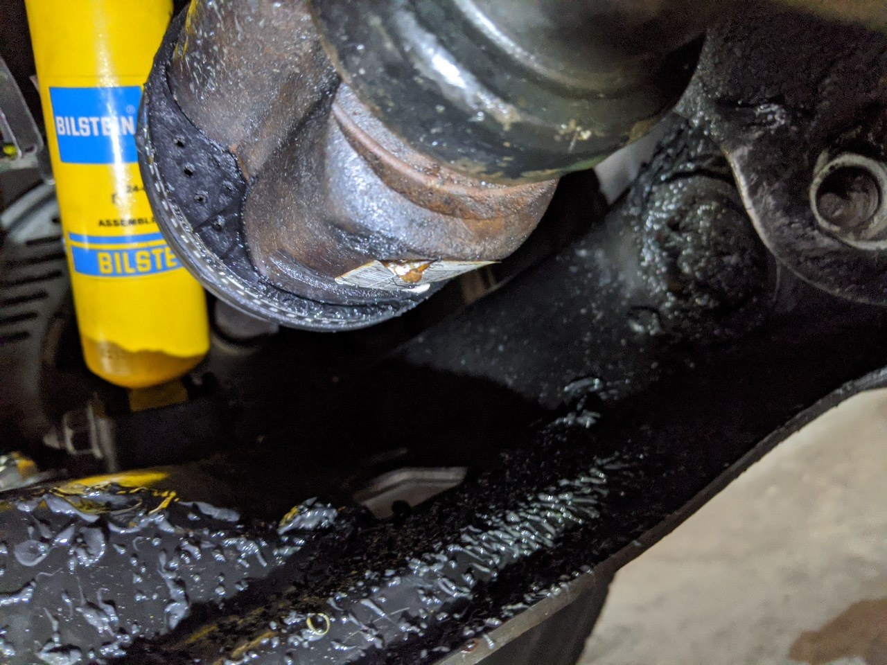

So the idler arm replacement is what made a big diference, but I'll answer this questions anyway in hope to further improve everything.
It's not RPM dependent. I've testing this numerous times crusing at 70 MPH in neutral and drivng up to 20 MPH in first gear hitting 3K RPM.
It is speed dependent but it doesn't always happen at a specific speed. Always above 50 MPH and sometimes gets worse the faster you go.
There appears to be a sweet spot, but that's been very difficult to identify. It always comes and goes after going around slight curves with various road conditions.
It will sometimes come or go after coming out of stop-and-go highway traffic.
Front wheel bearings are new. Have about 15K miles on them.
So I do have an issue with my CV joints where they are leaking grease. It splatters all over the control arms. I removed both axles when I was rebuilding the front suspension and repacked them with grease. The shaking is what prompted me to rebuild the suspension in the first place, and it did absolutely need it.
When I pulled the axles out, the dirver side was missing it's clamp, and the other side was barely hanging on. I replaced both clamps and packed them with new grease.
Since then that grease has continued to leak out regardles of how tight I have that clamp. One of the new clamps has popped off since then too and I need to replace it.

I recently repacked my CV joints with grease and installed new boots. I made sure the grease was tightly packe in there.
I also greased all my servicable joints too. Made sure that grease was tightly packed.
Blazer is riding a lot smoother now. Just as smooth as it was pre 100k miles.
So I've concluded anything that is serviable with grease, should be serviced and made sure there is enough.
If grease isn't tightly packed, I'm guessing that allows for enough play to cause things to shake.
