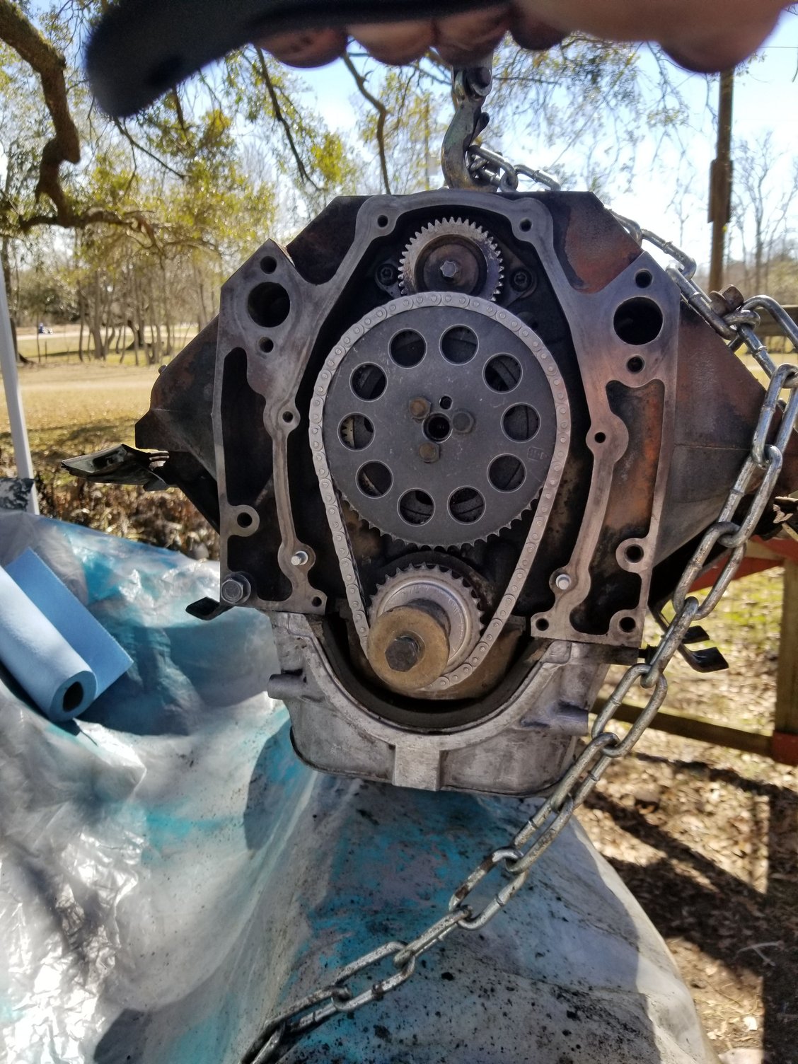

Today we installed my heads fresh from the machine shop. Shop replaced a slightly bent valve and valve seats. Worked their magic and Bam they look brand new. I found the 3 pass sequenced torque easier than the 22ft/lbs plus degrees installation. Anyways, back to my question. We were putting the harmonic balancer back on with the installation tool and when we just about got it completely seated we turned it and there was a noise that came from within. Seemed with about every half rotation of the balancer it happened. Stumped, we stopped and began removing it again. Once it was close to off we rotated it again...... No noise!! Does anyone know what is happening here? 🤔🤔
please advise..
We have changed oil pan gasket, trans pan gasket and filter, timing chain sprockets and cover. Trans front seal. Went on with heads & new bolts +gaskets today. Still left.... Spider inj, egr valve gasket, waterpump and gasket, lim gasket , valve cover gaskets ,bolts and grommets and exhaust gaskets. Etc. That noise on the balancer concerns me. My mechanic says he's never had that happen b4. Any thoughts???
and yes we did put oil all down lifter valley ( I think that's what it's called) before turning balancer. Please helpSorry so long..
it's a 99 Blazer, 2dr,2wd 164k miles 4.3 vortec
https://cimg0.ibsrv.net/gimg/blazerf...f6e06c4674.jpg
https://cimg7.ibsrv.net/gimg/blazerf...efe1450884.jpg
https://cimg4.ibsrv.net/gimg/blazerf...c8a868ece7.jpg
https://cimg6.ibsrv.net/gimg/blazerf...411b635259.jpg

Me either GeorgeLG !! They are every bit of $ 225 clean for sure. Well just got some bad news. We gotta drop oil pan tslightly , take timing chain cover back off and turn around the plate that goes in front of the crankshaft. we some how have installed it incorrectly.... yeah!!! fun!
