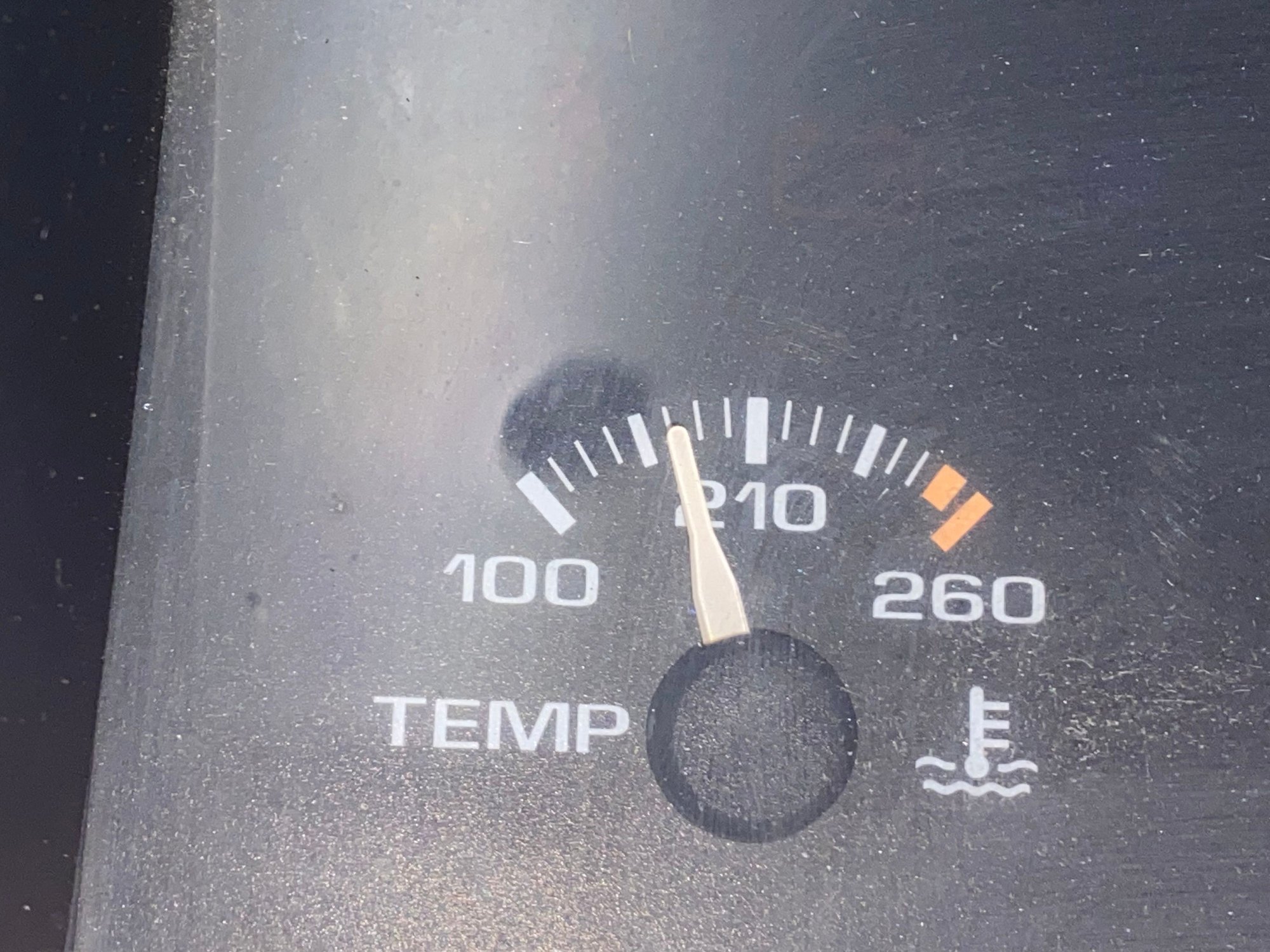

Vinci81 Jan 20, 2025 05:05 PM
https://cimg7.ibsrv.net/gimg/blazerf...02de6d1f8.jpeg
That’s about as high as it going then drops to 1/4 mark

Vinci81 Jan 20, 2025 07:08 PM
No change
