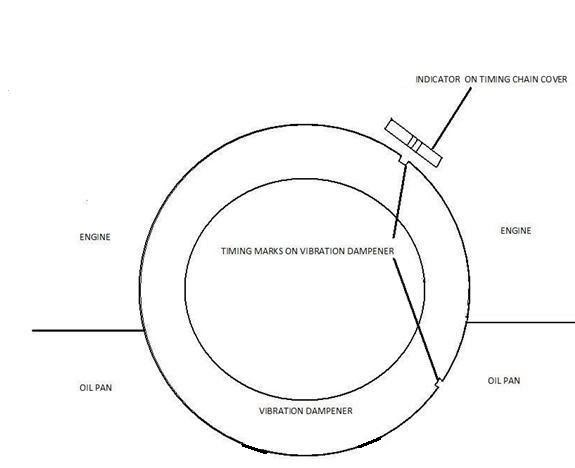

P1345 means the distributor is off at least one tooth, (at least 25 degrees). If the engine starts and runs fairly well, (no backfiring through the intake or exhaust) it's easy to fix. The timing marks and the rotor must be in the correct position simultaneously. Using a socket & ratchet, manually rotate the crankshaft clockwise until the timing marks are aligned like in the image below. While turning the crankshaft, DO NOT rotate it counter clockwise.
Attachment 31504

Are both timing marks lined up just like in the image?

The P1345 will only set if camshaft retard is off more than ~27 degrees, so, if everything above is good, and the P1345 still sets, the outer ring on the vibration dampener may have slipped. If that's the case, when you line up the marks, #1 piston is not at TDC. You can pull #1 plug and stick a plastic drinking straw in the hole. Then have an assistant manually rotate the crank (clockwise) and feel for the piston when it arrives at TDC. Then check to see if the marks are lined up. The option to that is check camshaft retard on a scan tool to see exactly where it is, and adjust accordingly.

You mentioned it runs pretty well, and no other DTC's are present, so from that, short of pulling the front end apart, we have to "assume" the timing chain & gears are ok, and that it's timed correctly. Which brings us back to a slipped vibration dampener. Which is no big deal, but we need to get that P01345 to go away. Try the business with the straw and see what you find, (more bonding time) that will tell if the dampener has slipped. OR, either put it on a scan tool and check camshaft retard, which we already know it's out of spec, or pull the distributor and experiment one tooth in each direction until the P1345 goes away.
