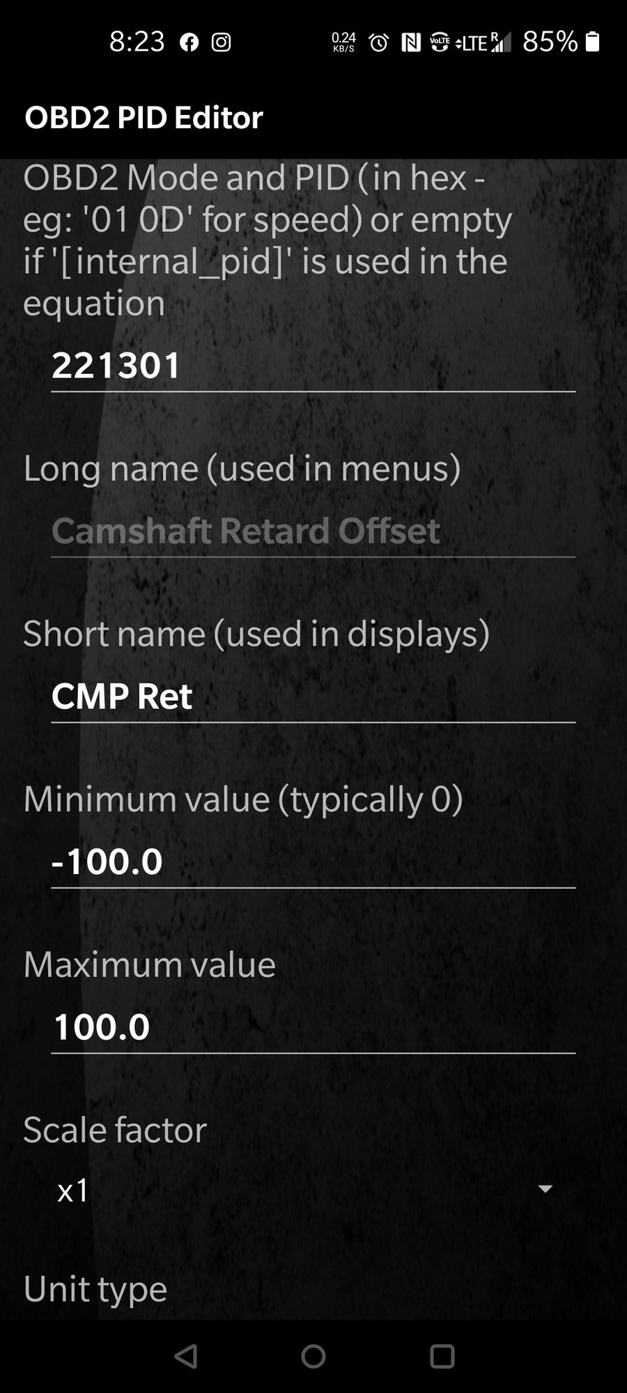

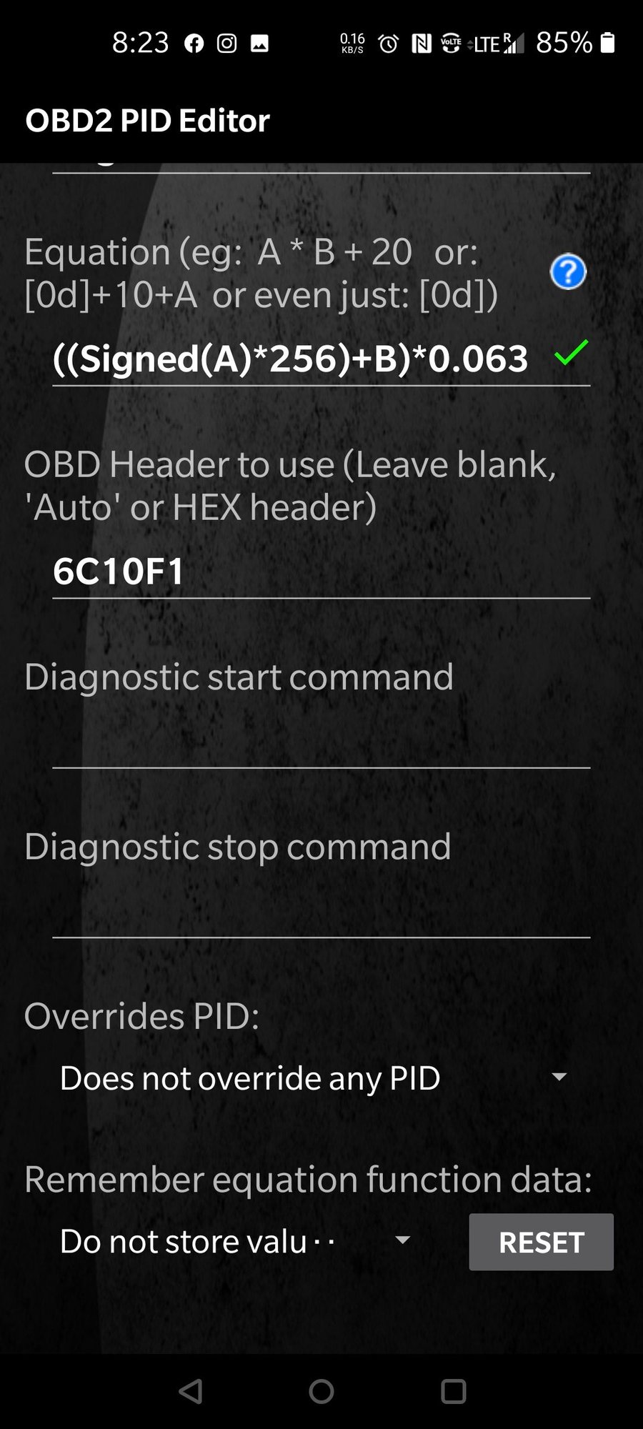

ZachC540 05-20-2021 06:04 AM
Hey, Les I found one that works on Torque Pro! This is as close as I could get without modifying the hold down.
https://cimg2.ibsrv.net/gimg/blazerf...5fe6dec2d1.jpg
LesMyer 05-20-2021 06:45 AM
Cool! VERY interesting. Where did you find the formula? Good thing to know.
Please post the formula and how you entered it and I will check it for accuracy against other software on my vehicle. I never had any luck myself getting it to work at all in Torque Pro. I believe there are different formulas for V8 vs V6, but AFAIK they do converge readings at zero.
ZachC540 05-20-2021 07:28 AM
I actually found it on a Safari Van forum, I think this equation is for a V8 but I'm sure it's very close. I'm gonna have my friend check it against his Snap-On scan tool.
https://cimg3.ibsrv.net/gimg/blazerf...c5f507361a.jpg
https://cimg4.ibsrv.net/gimg/blazerf...d5c6ad9b77.jpg
