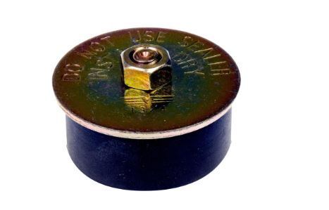

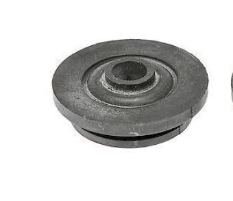

I know the thread is old but in case someone else ever does a search.
When I replaced the radiator on my 1995, the rubber mount bushing were gone. The parts store wanted $25 a piece to special order them. Although I've seen some online for $5, I needed to finish the job ASAP.
I made my owe using rubber freeze plugs. I think it cost me $12 for two. I drilled out the center so the radiator bottom pin fit. Then I turned down the bottom OD to fit inside the hole of the metal.
I'm attaching pics of a plus and the mount.
