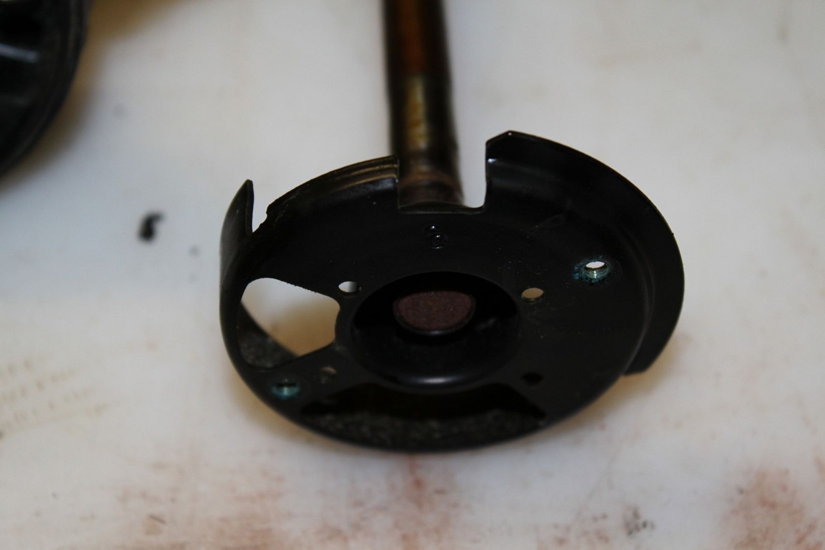

Pictures I promised everyone:
http://i11.photobucket.com/albums/a1...h_IMG_0640.jpghttp://i11.photobucket.com/albums/a1...h_IMG_0645.jpghttp://i11.photobucket.com/albums/a1...h_IMG_0646.jpg
The rotor base plate is press fit onto the top of the distributor shaft itself. This should not be a loose connection ever. On the used distributor that I have, it is solid and would prove to be quite difficult to remove if I tried.
The shaft rides in two sleeve bearings, one at the top of the distributor body and one at the bottom. On this distributor, the bottom bushing has some play in it which is likely due to the amount of use. It may be allowing for some deflection while running which could further modify timing. The distributor itself does not offer up much, if any, resistance to turning. However, the oil pump does take power to turn and being driven by the distributor shaft. This deflection can change the engagement between the cam gear and the distributor gear, modifying timing possibly outside the bounds of what the PCM can correct for. Combine this with wear on the drive gear and it can definitely become a problem.
