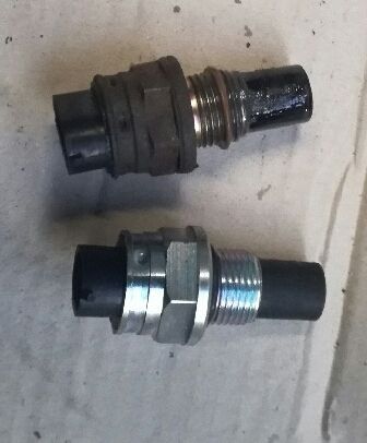

My idea is that the sensor wasn't installed deep enough, so it is not picking the rpms properly. I gave a call to the person that carried out the replacing job and the guy said, the sensor they got is not the genuine one (made in Taiwan). He says there are no shims for adjusting and dropped me the photo of these two sensors (as per attached).
Looking forward Your opinion.
Cheers, MikeGenuine, old sensor and a replacementhttps://cimg9.ibsrv.net/gimg/blazerf...27f2d2b7d4.jpg
oldeerslayer 12-11-2017 10:34 AM
The speed sensor is a set length. If you screw it in farther you'll likely contact the reluctor ring and tear the end off the sensor as the tolerance is fairly close. The speed sensor reads PPM Pulses Per Mile and isn't involved in measuring engine rpm's.

oldeerslayer 12-11-2017 11:14 AM
You could try a different Speed Sensor and also look in the hole to see if the reluctor ring is full of crap.
Mike.308 12-11-2017 02:02 PM
Thanks buddy! You're right, if there is a crap in between teeth, it will not pulse properly. I haven't though of it :)
