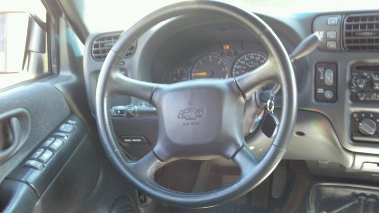

KM346 09-14-2014 05:09 PM
Originally Posted by [email protected] (Post 634581)
KM, did you retain the airbag as a working feature when you swapped out to a Silverado wheel? How much did you pay for it?
I forget what i paid for it but it wasn't much. The older silvys had the same style wheel / airbag as our trucks so it all bolted up fine... Just need to pull the SIR fuse, unclip the airbag and rent/buy a steering wheel puller to remove the wheel. Easy swap.

[email protected] 09-16-2014 09:05 AM
KM3 , that is the kind of upgrade I like. It significantly improves the vehicle's appearance, but looks like it could have come from the factory like that. The color matches the interior and everything functions as it should. Thanks for the photo.
