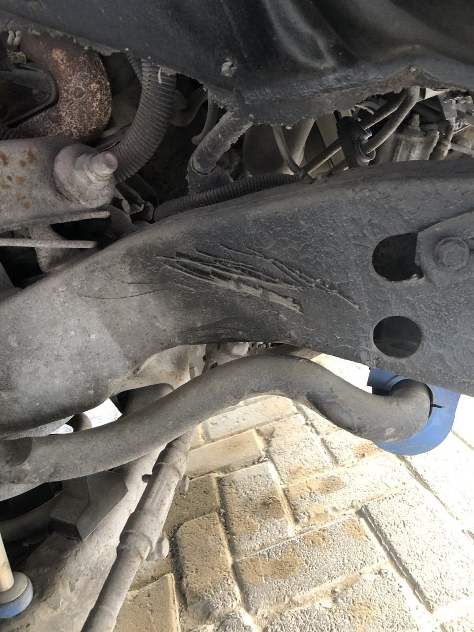

I have problem in my 2wd 00 jimmy, the front tire rubbing inside suspension components include side of sway bar. The size of tire I use is 235/75/15 but after I contact GM they find for me the RPO codes and in RPO it say 205/70/15. Now I wanna put h&r 5mm or 10mm wheel spacer to eliminate this problem but I hear that wheel spacers will damage the wheel bearing,steering components, more width of wheel spacer more damage will occurs but I don't have any idea about wheel spacers and if this true or not this my first time I will use them.
So, if anyone have idea about them or can suggest another method to keep wheel away from suspension components please tell me

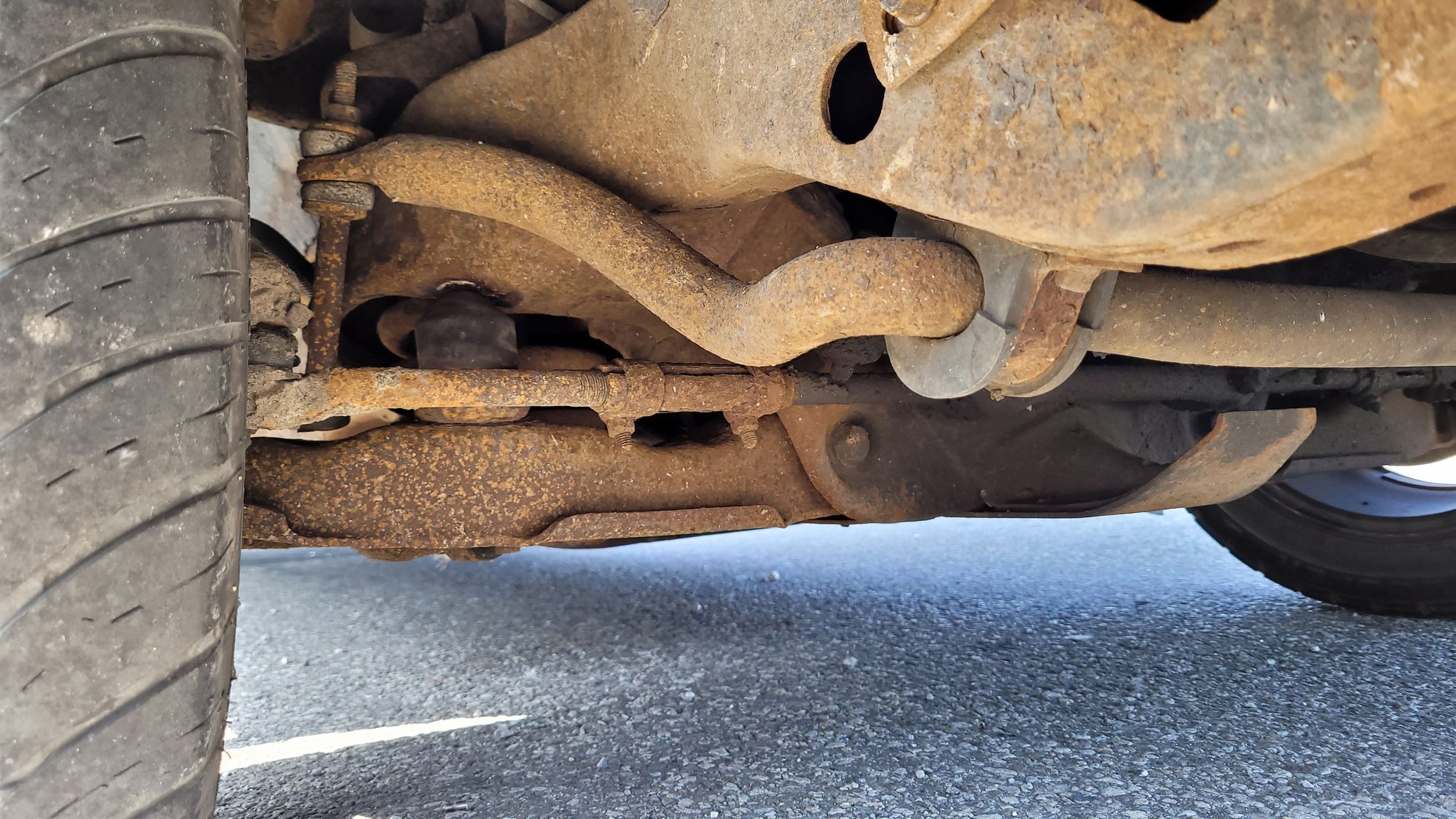

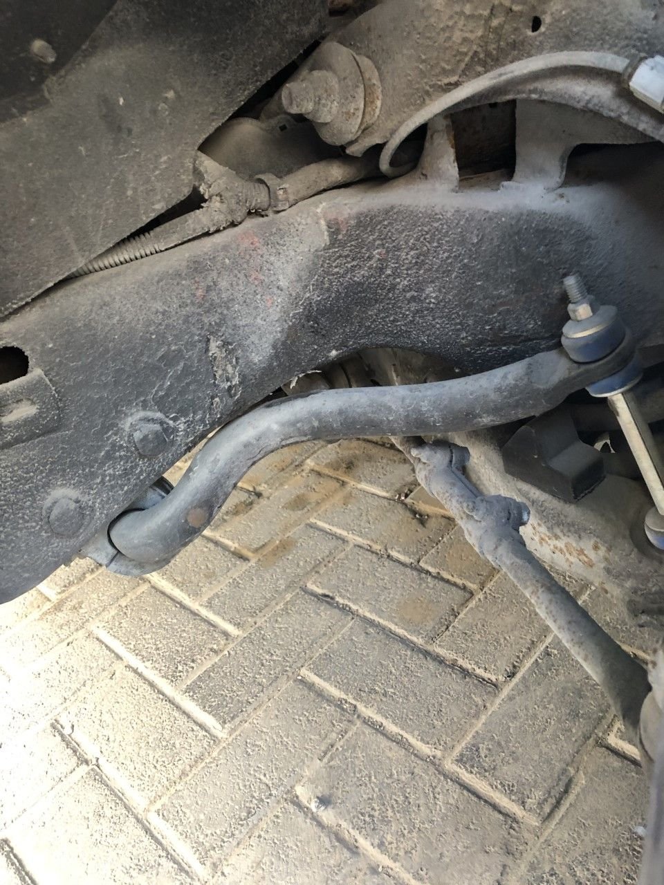

Here is a few pictures where rubbing places
https://cimg8.ibsrv.net/gimg/blazerf...edd1c1f7dc.jpg
https://cimg0.ibsrv.net/gimg/blazerf...aa50cd7d9c.jpg
https://cimg1.ibsrv.net/gimg/blazerf...9e9fdfc08d.jpg

Ummm I don't know that about rims. But now I remember one thing that I flip my sway bar up down because I think it was installed in wrong direction can anyone confirm that the way I installed sway bar is correct ?

I think you have the front anti-sway bar upside down. Flip it around. I have 255 tires on my stock suspension with no tire rubbing at all...even at steering lock.

For the sway bar itself I'm not sure it it's not symmetric. But turning i upside down could help. Have to put that on my to-do list for the Blazer.
El_Beautor 04-08-2021 11:36 AM
I could be wrong but that sway bar looks installed wrong to me. Doesn't it normally sit below the tabs on the control arms? I think it's either upside down, or just installed wrong.

So in the wofes sonoma, the bar is installed the same way. As far as I can see, it's never been touched by p.o.
But not too sure. But I'm running 245/50r16(wider then stock, but about the same size) and it doesn't rub at all.
https://cimg9.ibsrv.net/gimg/blazerf...cc168b6462.jpg

Just noticed that your sway bar is flipped.
https://cimg4.ibsrv.net/gimg/blazerf...111ffcbaee.jpg
