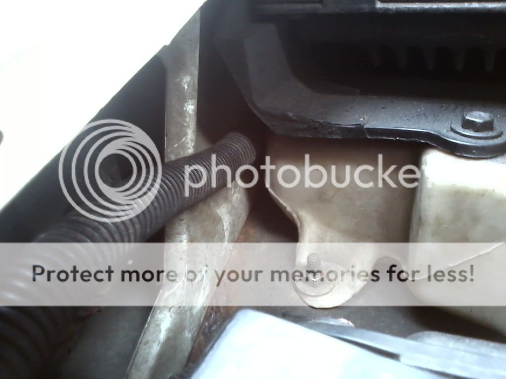

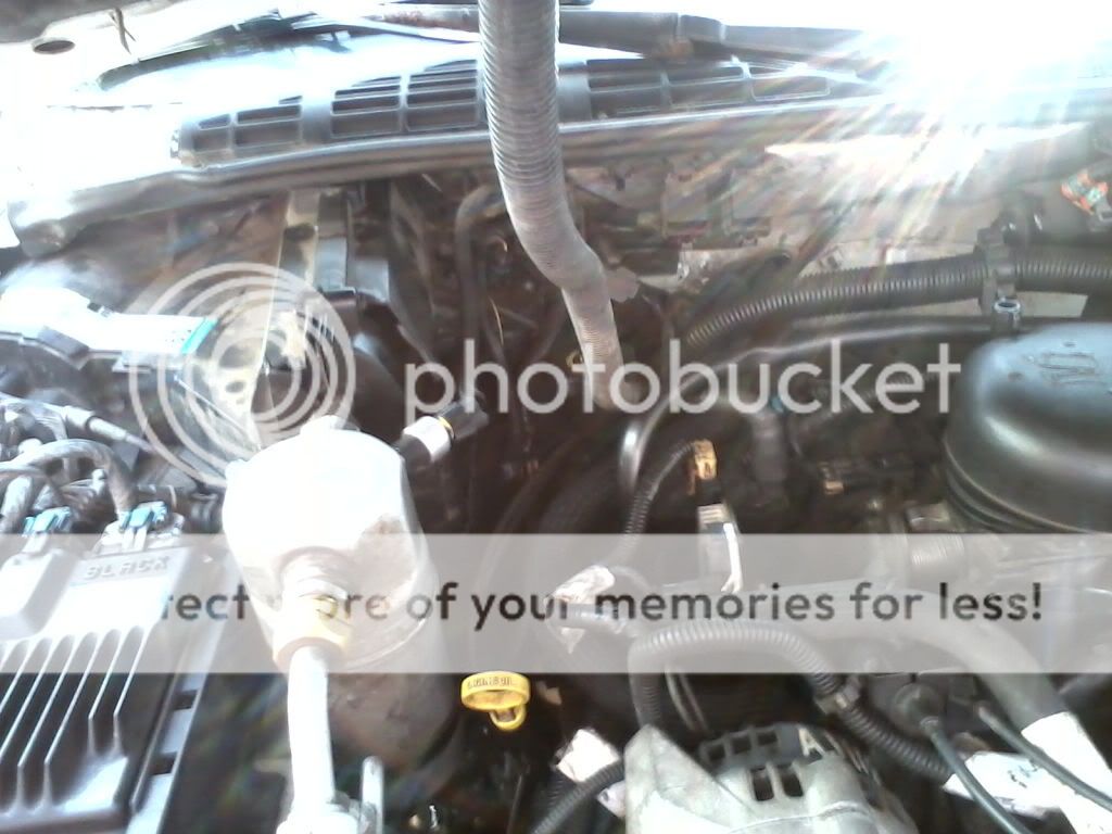

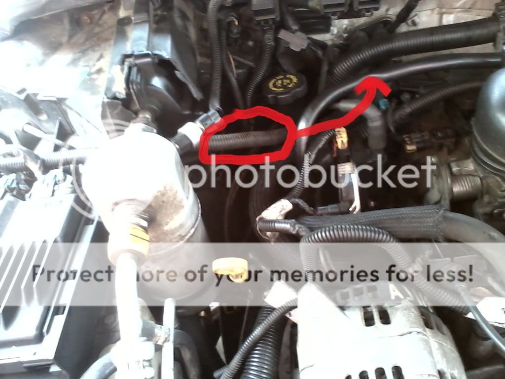

the wife is home and i climbed into the motor to get some pictures. Upon doing this, i traced it into my firewall under my heater hoses. I also unrouted it and took a picture of it unrouted from the fender..
http://i1184.photobucket.com/albums/...hi09/where.jpg
http://i1184.photobucket.com/albums/...711_135903.jpg
http://i1184.photobucket.com/albums/...82711_1400.jpg
http://i1184.photobucket.com/albums/...711_140001.jpg
This is where it leads under my heater hoses into my firewall.. traced it with my finger after unrouting it from the fender and felt it go into the firewall..
http://i1184.photobucket.com/albums/...82711_1354.jpg
But when it is routed like i said it comes out at the battery area and from there i see nothing for it to plug into..
