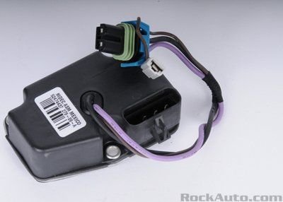

CLICK HERE for the replacement AC Delco blower motor control module courtesy of RockAuto mainly to show the image below: https://cimg8.ibsrv.net/gimg/blazerf...81adb11c10.jpg 1998 Replacement Blower Motor Control Module - ACDELCO 158752 Note the wiring. Replacement fans should have a spade off to the side of the electrical connection for the ground attachment. So basically, they did simplify it in the later years and made it backwards compatible to the earlier years. It just wasn't very clearly detailed. Hopefully it is now. |
