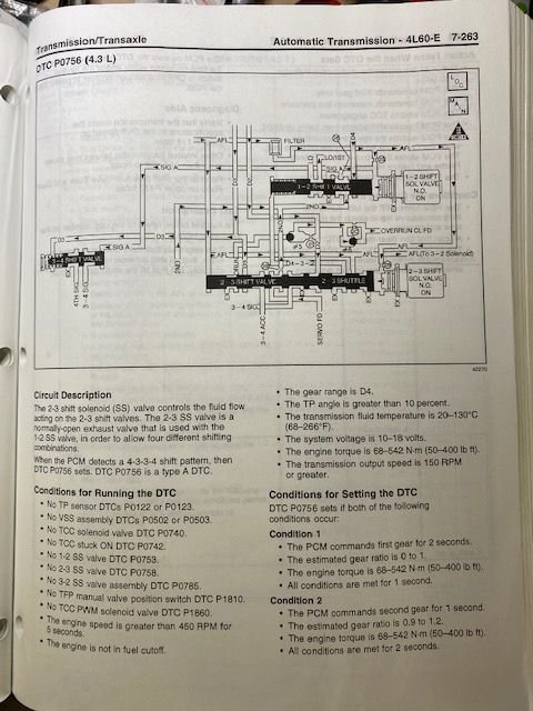

GeorgeLG 03-23-2021 04:32 PM
Here's the shop manual 411, maybe this will help:
https://cimg2.ibsrv.net/gimg/blazerf...72dba64653.jpg
https://cimg5.ibsrv.net/gimg/blazerf...eec750ebef.jpg
https://cimg7.ibsrv.net/gimg/blazerf...e179b65616.jpg
George

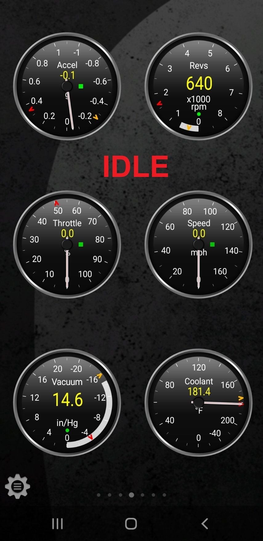

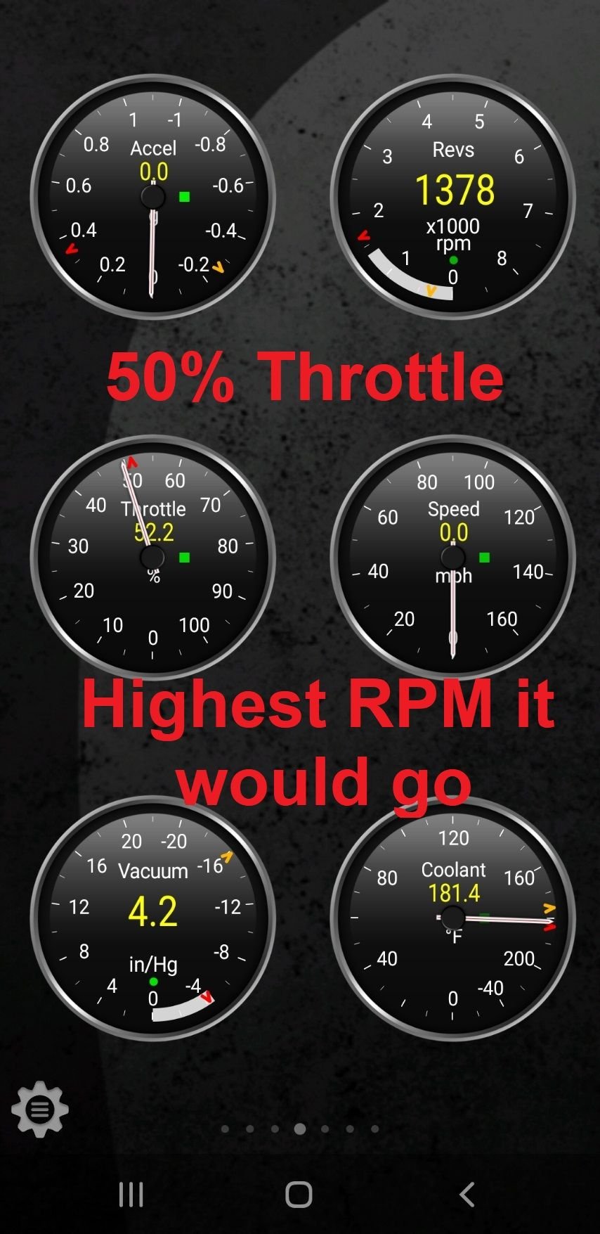

Still running rough, smooth up till about 1200 RPM then it gets really rough and won't go any higher than 1300-1500 RPM, took some shots of the reader while it was running.
I'm going to start tracking down all the vacuum lines tomorrow since the vacuum dropped off dramatically, really at a loss here.

GeorgeLG 03-27-2021 09:35 PM
Its fuel, spark or air/vacuum.
Vacuum is a possibility and worth checking out. Fuel trims can help you confirm a vacuum leak because its unmetered air and will show as a rich (+) fuel command in fuel trims at idle. It would also be good info to see what fuel trims are doing when it starts running crappy. That can help determine if its fuel delivery related. Look at my article in my signature,
Have you performed the fuel pressure tests in the sticky?
Can you read CMP retard?
Do you have a misfire counter by cylinder so you can watch that while its rev limited? That can help determine if its spark related. See my misfire article.
George

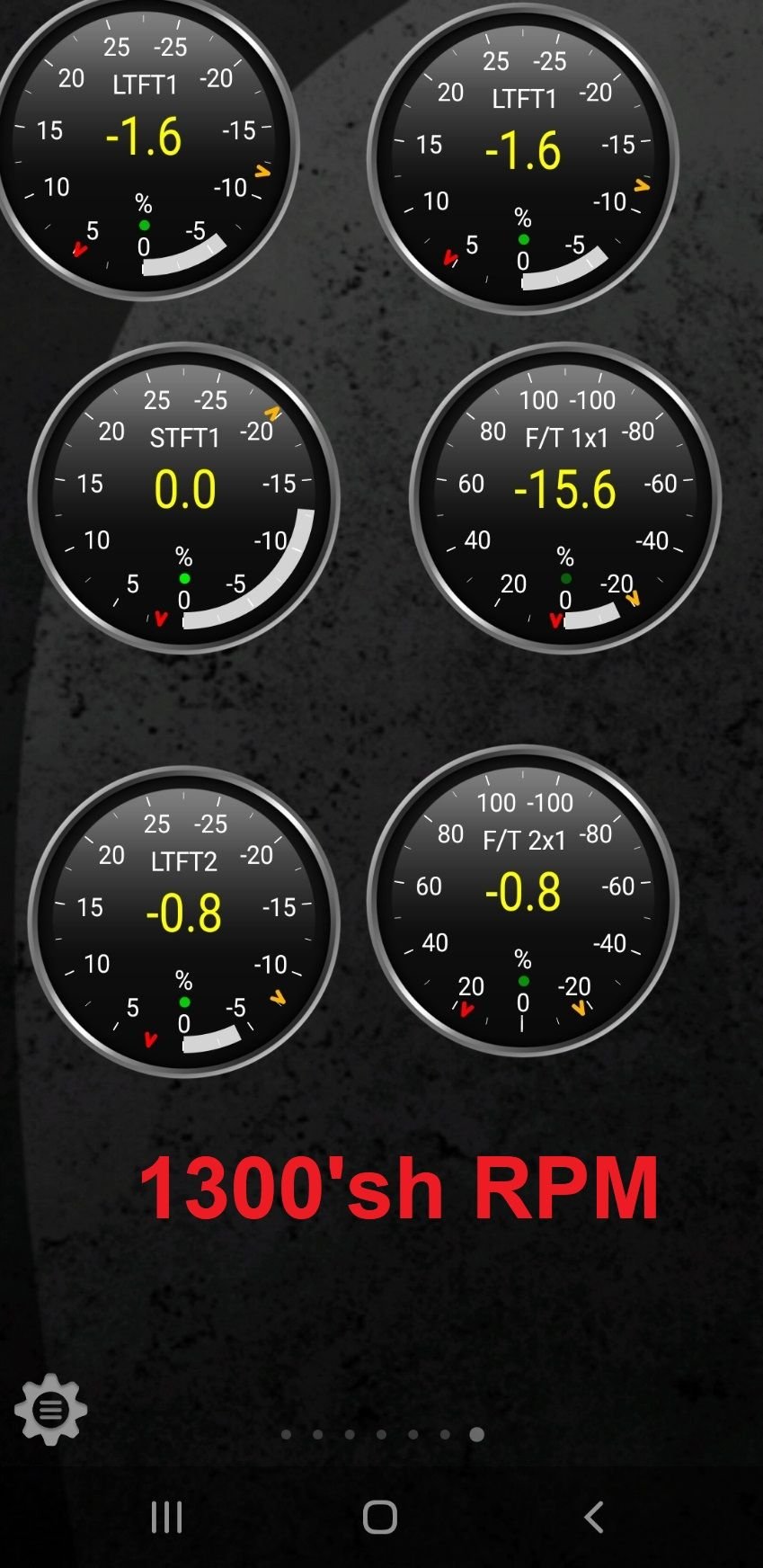

FUN-V 03-28-2021 12:50 PM
Here are the fuel trims, I'll be honest, I don't know how to interpret them though.
https://cimg3.ibsrv.net/gimg/blazerf...4bb8036eb9.jpghttps://cimg4.ibsrv.net/gimg/blazerf...51949c2da6.jpg
GeorgeLG 03-28-2021 03:38 PM
You can read the fuel trim article in my signature to get started, We need LTFT1, STFT1, LTFT2 and STFT2 for the complete picture and we only have both values for bank 1, the drivers side bank. I do not know what the F/T A x B parameters are. You always add LT and ST together so your bank net numbers are -0.8 at idle and -1.6 at 1300 rpm. This means that the computer is reducing fuel delivery very slightly at idle to compensate for a perceived rich condition at the O2 sensors and at 1300 the same compensation is slightly higher. These are not big numbers and tell me that an engine completely rev limited at 1300 rpm probably has an ignition problem and probably not a fuel delivery problem. Now this is a first order conclusion because faulty sensors for instance could be in play but for now lets keep it simple.
So now what?
Get your bank 2 fuel trims just to check but lets assume similar numbers.
Look at the 6 misfire counters at idle and 1300
Mist around all the ignition components in the dark with a water sprayer and look for arcing.
Pull a plug wire and look for 1" of strong blue spark with a smooth cadence at idle and watch what it does at 1300 rpm.
Look for carbon traces under the distr cap
Whats your CMP retard?
Fuel pressure would not hurt but your fuel trims suggest ignition.
