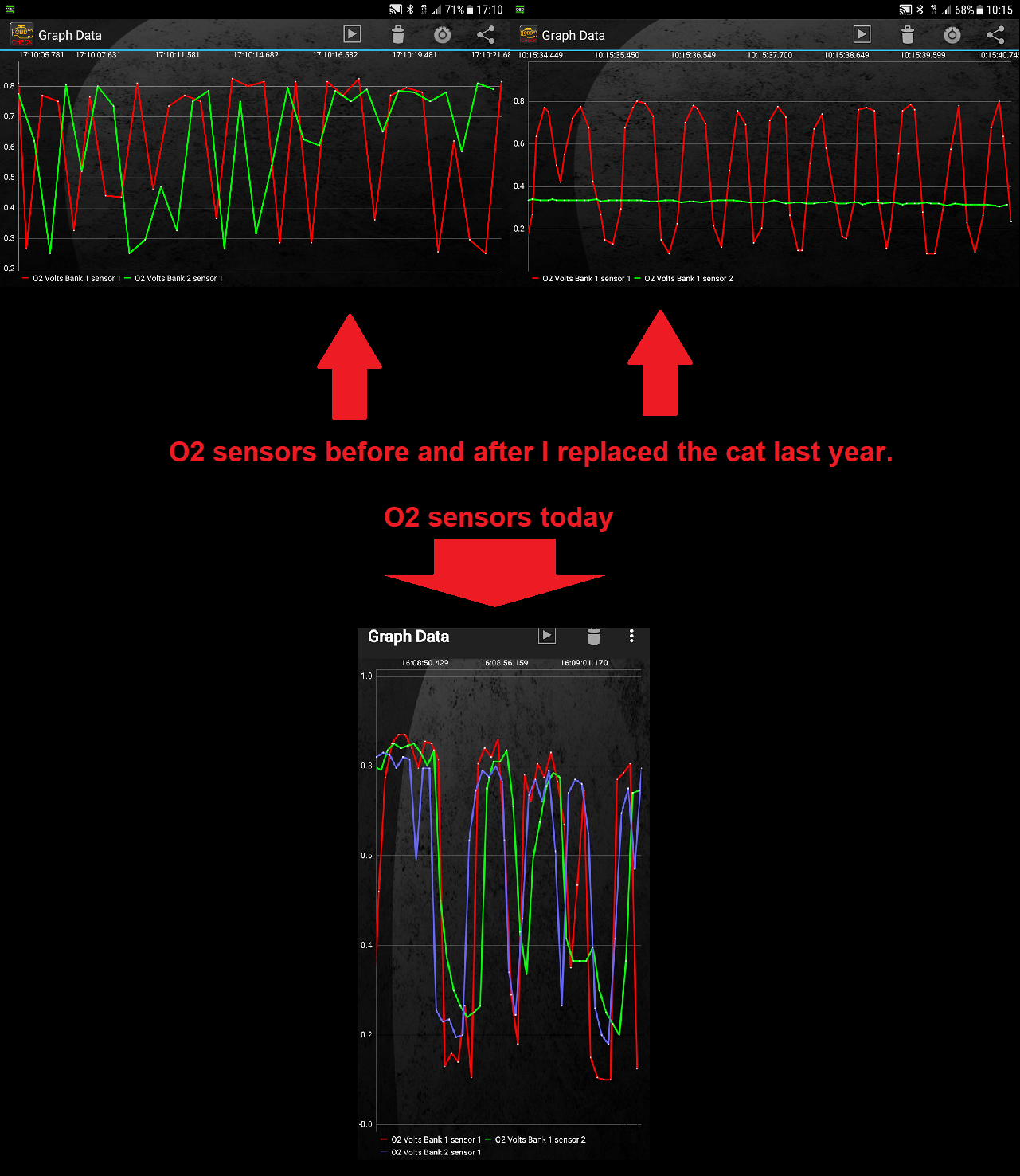

So, fuel pressure leak down was good, thew the O2s on scope again, and wasn't happy at what I got
exhaust restriction from a bad cat can cause your symptoms and running rich can cause a bad cat. What is the decode on those graph colors?

red and green are the two upstream and the blue is downstream

It sure looks like you might have a bad cat. If that is confirmed the question then is why? The biggest causes of premature failure is:
Physical damage
Burning oil
Coolant leak
Unburned fuel (running rich)
Poor quality replacement
You will need to get to the bottom of why your truck is killing cats.
