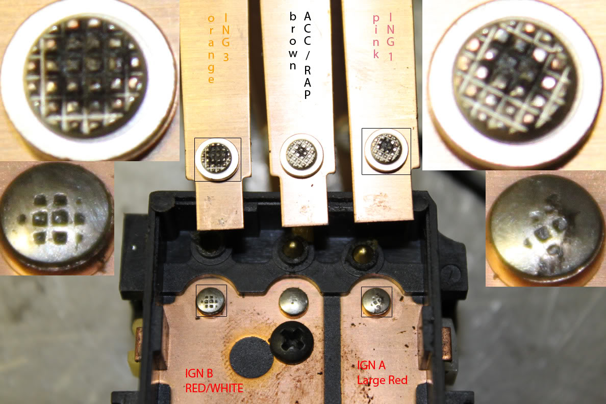

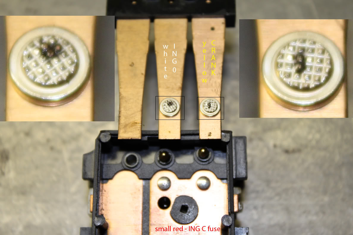

So what does it all look like?
The first two pictures below are of the two contact sides of the ignition switch. All of the protective covers have been removed and the wiring has been cut short to allow for better photographs.
https://blazerforum.com/forum/attach..._switch_01-jpghttps://blazerforum.com/forum/attach..._switch_02-jpg
The next two photos show the contact arms removed from the switch housing, revealing the contacts themselves and displaying the charring that will eventually cause the switch to fail. I have zoomed in on the contact surfaces showing the most charring on each side.
https://blazerforum.com/forum/attach..._switch_03-jpghttps://blazerforum.com/forum/attach..._switch_04-jpg
As you can see, the IGN 3 contacts are showing the most damage with the IGN 1 contacts starting to show the affects of age as well.
The IGN 3 contacts are the most heavily loaded of all of the contacts in the system and it also is the contact which is opened and closed the most during the life of the truck. Lets look closer at what this contact goes through on a normal start sequence. In a typical start cycle, the key is turned from LOCK, through OFF and RUN, then to START, and finally back to RUN once the vehicle is started. As the key is turned from LOCK to RUN, the IGN 3 contacts close. When the key is then turned to START, the contacts open back up. Once returned to RUN, the contacts close again. This is why it is vitally important to hold the key in the START position until you are sure that the engine is running. The more times you go to the START position, the more life you take away from these contacts.
So what happens when the contacts go bad?
For the 98+ trucks, the most common issue is the "security" light on the dash illuminating. But the problem can also manifest itself as an inoperative fuel pump, unresponsive cluster, ABS and/or SIR lights being illuminated on the cluster, as well as a no start condition (either related to the inoperative fuel pump or a failure of the starter to turn over). The ignition switch can also cause PASSLOCK issues.

I took part of the Switch apart since I could not see any burned or loose wires and here is a pic of what I found.
(I would have liked to post a pic here, but I cant!!! I will put it in my album for anyone interested...)
swartlkk 08-11-2009 06:22 AM
Remove the two screws.
LINK TO overseachevlover's album with more photos of ignition switch contacts.
From the looks of the tarnish on the contact arms, they have gotten hot. I would definitely suspect that the contacts are burnt quite badly.
overseachevlover 08-11-2009 08:57 AM
I took off the screws and added those pics to my album aswell... They are quite burned...
Is there any way to prevent this from happening again???
And, could I just change the contacts and revive the old switch??? (Maybe a silly question, but I like to have spare parts close by...)

You could clean up the contacts and it will likely work in a pinch, but I would not use it long term.
