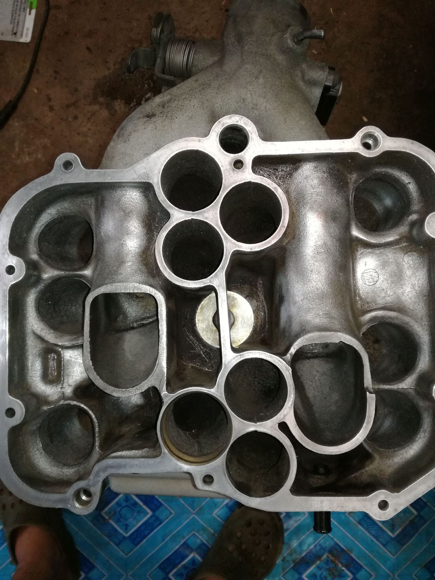

First, I took the plenum off to replace the fuel injector blocks. I've replaced the spider injector and these parts a few years back, so I'm somewhat familiar w/ the process. I had not planned to replace the spider, since it's only < 5 yrs old. The first one made it > 15 yrs before replacement. However, when I looked at it, the hoses had nearly rubbed all the way through for at least one port. Here's some pics:
https://imgur.com/okOYIKX
https://imgur.com/XnNcgBJ
https://imgur.com/6Kro48P
https://imgur.com/MLyhPc3
https://imgur.com/4gnyiCw
Here's some more tips for those replacing their spider: don't do what I did: I incorrectly assumed the torx screw that secures the mounting plate for these two injector blocks here:

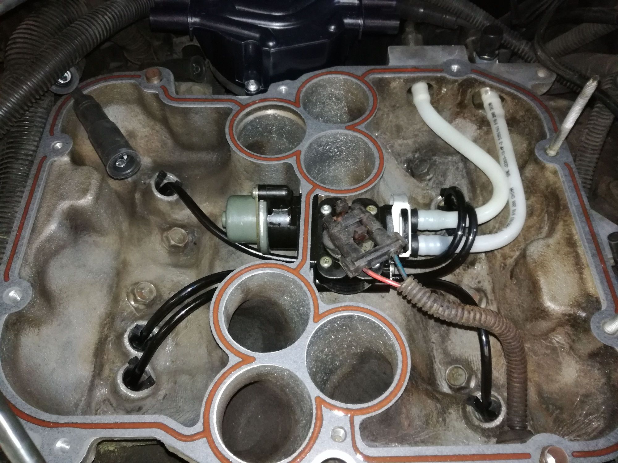

Krnt 05-22-2018 09:07 PM
Nicely written, I was looking for info about the Energy suspension engine mounts, I probably have to replace mine because there is a "thump" sound whenever I gave it hard acceleration, I'm glad I found this. I think the part number is different for 95+ blazers, 31144, also I think I need to replace the transmission mount.
Everything seems pretty good, the only thing that is bothering me it the wedged are plugs and the electric tape inside the plenum, bad idea, they are going to get sucked by the engine eventually.
I just replaced the spider in mine, I had to clean everything, it was a mess.
https://cimg1.ibsrv.net/gimg/blazerf...3f6a48626f.jpg
https://cimg0.ibsrv.net/gimg/blazerf...01ce292553.jpg
Now my next problem is a leak in transmission and engine oil.
