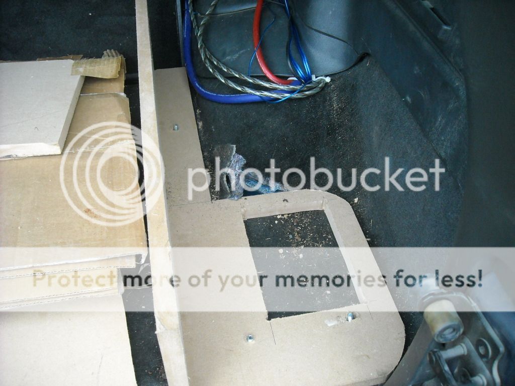

altoncustomtech 04-21-2015 09:22 AM
In the image there, that's a DSP (Digital Signal Processor) and not an amplifier. It controls the signal and has inside of it EQ's, crossovers, time alignment, phase control, and a few other bells and whistles that far exceed the signal controls on all but a handful of head units. There's almost no amplifiers that are as small as this device, as previously mentioned.
I re-read your original post and noticed you have a '95 which is kinda like the odd duck of the blazers. They had a lot of new features over the first gen models such as an upgraded fuel injection system. There's several of those features that didn't carry on to the rest of the blazers in the second generation for whatever reason so the rear of your truck may not be like mine. However here's a picture of the area I'm talking about, it's in the rear passenger side corner of the cargo area, specifically where you see the small rectangular hole in the board and to the right of it in the picture.
http://i889.photobucket.com/albums/a...1.jpg~original
That area where the leg of that board with the rectangular hole in it which goes between the wheel well and the rear of the truck is the place I was talking about bolting a board down to. Then have a board attached to the one that bolts down which goes up, at 90 degree angle, the side between the floor and the window. There's enough space there for a fair size amp and with a little creativity it and the wires could be pretty well hidden from any outside view.
It's about the best location I can think of that's not going to require a false floor or just screwing it to the back of a seat.
