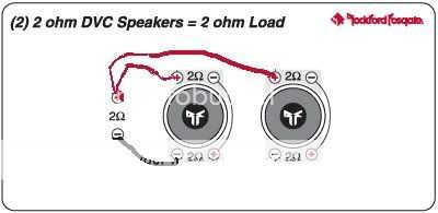

Here's the basic wiring
If ya need help with that let me know I'll break it down as a step by step.
And no need to thank us. It's what we're here for.

k... thats much easier... so I connect both positives to the same terminal and both negatives to the same terminal...... so I bridge them both on the same terminals? like I was bridging one sub on 2 channels? the amp shows wich positive and negative to use to bridge...

exactly. welcome to the great world of subwoofers.

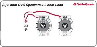

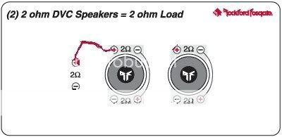

First we run 1 power line from the + on the amplifier to the + on the first sub.
Next we run 1 more power line from the + on the amplifier to the other + on the second sub
Now time to run a line from the - on the amp to the - on the first sub
Now we do the same thing for the second sub
And we connect the - and the + on the first sub. Thusly raising the ohm load on this voice coil
And do the same thing on the second sub to achieve 2 ohm's

I always thought running a wire between the + and - on the speaker would short something out.... if the subs are 2 ohm subs I still have to do that? so i would basically have 3 wires on each sub...
one from + on sub to + on amp
one from - on sub to - on amp
one from + on sub to - on sub?
on both subs?
just making sure I understand this correctly

yep. 3 wires.

Nah doing it like that wont short something out. Cause in the first place theres no signal going through them basically.
And like he said yes 3 wires
