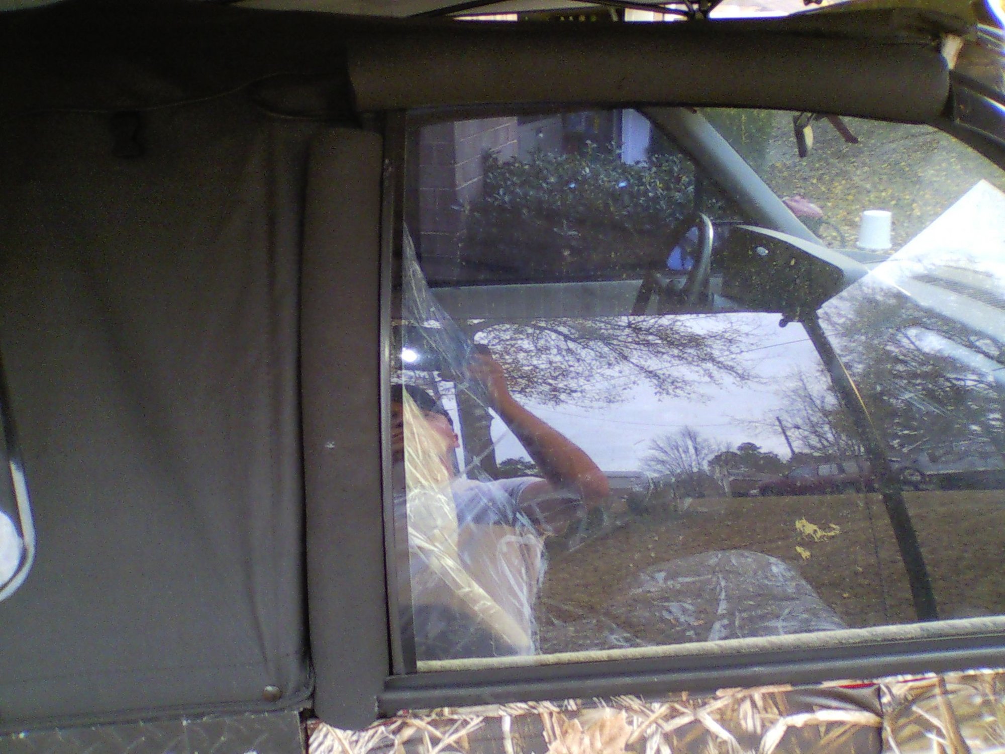

Here are several pictures of my fiberglass hard top project. I wanted to make it look like a HMMWV slant back gun truck. I attached a pic for those who don't know what that looks like. I didn't want it to weigh 300lbs though because I couldn't take it on and off by myself. I also thought having a 4 ft truck bed cover would be sweet too like the other configuration of a HMMWV. So I went and bought 8 or 10 8'x4'x1" pieces of foam insulation, wood glue, razors and sand paper. I'd glue them together as needed, cut, sand, fill with foam gap sealer, and repeat. After I got the whole pink foam mold made, I covered the entire thing in aluminum foil because fiberglass resin eats foam like heat melts butter. Then I slowly glassed the pieces inside and out, layer after layer, until I made my own slant back, bed cover, cab, and extended cab. The cab and extended cab can be put on individually or together with or without the back glass part. Then you can add the bed cover or the slant back if you want. This whole thing took several thousand dollars and all available spare time from September to February. When I took a hiatus in Feb, it was all done except the sanding, bondo, paint, and weather stripping. Sorry there are only a few pics. Eventually I'll upload a video walk-around to youtube and vids driving. It took forever, but it looks really cool and will look even better. I plan to put this on and leave it on in cold weather. Unfortunately, it took me all winter to make this and I didn't get it done in time to use it. I'm not tired of the project. Just taking time to reflect, plan, and enjoy driving the vert as is right now. Let me know if y'all have questions or suggestions. Sorry these pics aren't the greatest, but my battery was dead for a long time on the blazer so I couldn't move it, not to mention I had the various stages of the top on it. It's hard to show the whole project in 13 pics, but it's what I got. This wasn't supposed to be a build thread; I was just doing it to see if I could and because I thought it'd be awesome. When I finish the top totally, I'll take better pics.

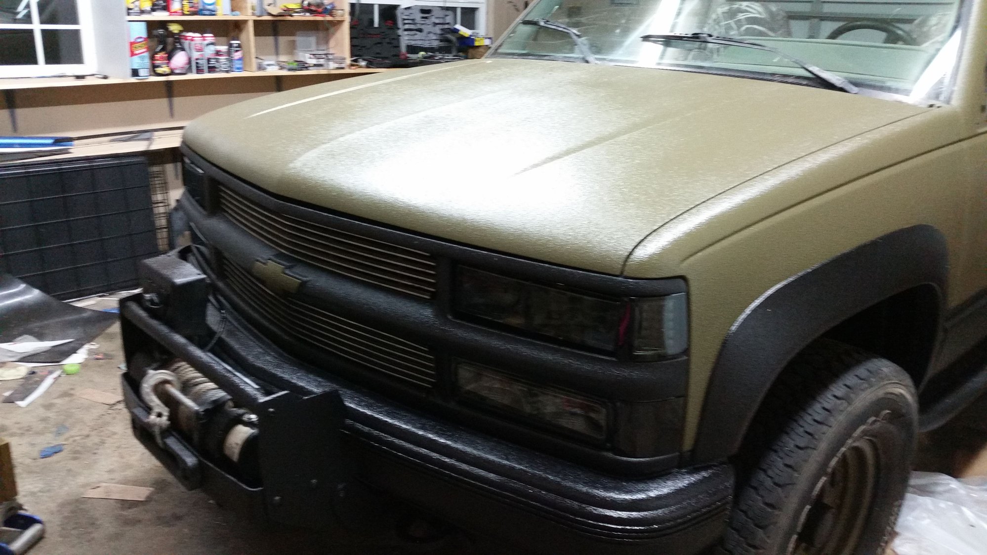

I never finished the hard top project. It just didnt turn out as nice as I wanted. I haven't abandoned the idea, but as I'm sure you understand, life got in the way. My next iteration of the hard top, I think I am going to get a real Blazer hardtop and use it as a mold. I moved a couple times, had a couple kids, etc. In 2016, I removed the vinyl wrap and painted the whole thing with Raptor-liner. Put in LED tails, made a hammock stand for the trailer hitch, got some new wheels. I have an LS ready to go in this spring because I'm bored with the 350 TBI. I will probably leave it N/A and just do a cam, springs, intake, exhaust 4.8l. I've really just been driving it and enjoying it, but I still have it and am tinkering with it as I get time. It's one of those that will never be done. Thanks for asking about it.

Here is a better side view. I have black wheels now, but I drive it all the time.
I put a ton of work and money into that hard top. In the end, I just roll with a soft top and some roll bar padding...aka pool noodles. I watch Full Custom Garage religiously and Ian Roussel gave me some ideas about how to use a Blazer hardtop as a mold one day.
