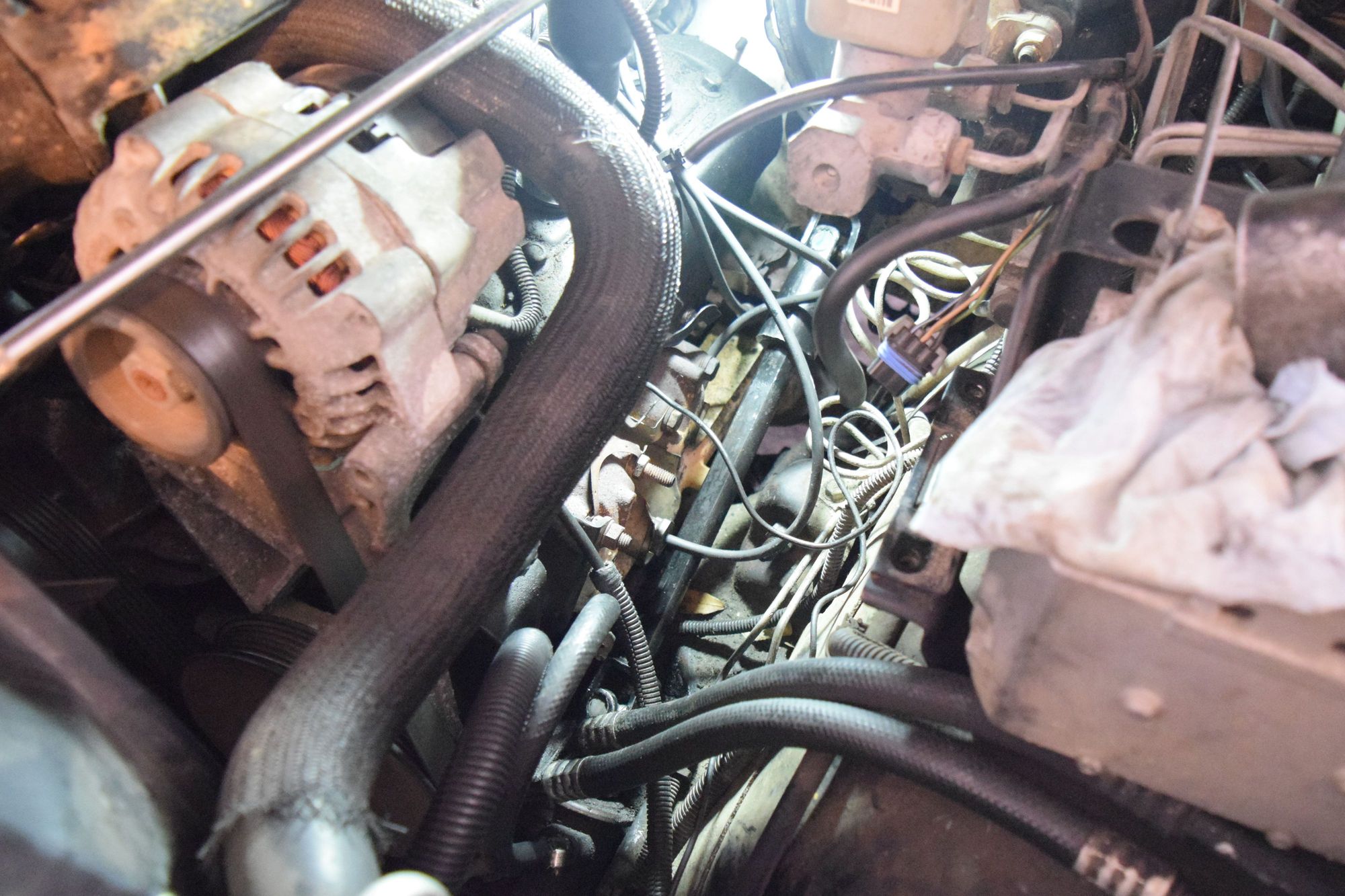

Well now I've totally snapped the old knock sensor off the stud. Not sure how I'm going to get that out of there. No luck with Chisel & Hammer, Vice Grips, or Channel locks. I have some larger extractor bits, but I'll have to drill into the stud to be able to use them.
If not that then I could try to tack weld the old stud to the stud on the new sensor. . We'll see. Lol I'm ignoring it for now.
