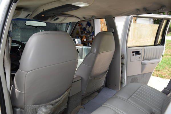

Finally took a couple more interior pictures.
https://blazerforum.com/forum/member...3143-32248.jpghttps://cimg8.ibsrv.net/gimg/blazerf...e3eb984468.jpg
https://cimg9.ibsrv.net/gimg/blazerf...9ad7f636f0.jpg
https://cimg0.ibsrv.net/gimg/blazerf...b3bdfb1bd8.jpg
https://cimg2.ibsrv.net/gimg/blazerf...1543f9f938.jpg
https://blazerforum.com/forum/member...3142-32249.jpg
Got a cheap carpet mat set off ebay with the one piece rear mat, but they're all a little too bit. . meant for a full size suv. You can kind of see them in the pictures. I think I can make them work though.
