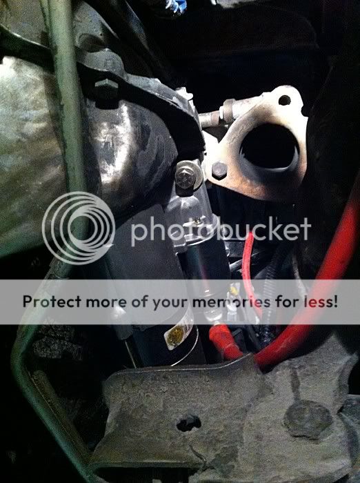

So after the dash went in, the started kicked the bucket. If its not one thing....
So I decided to be cheap and pull the starter fron my parts Blazer and us it for now.
I learned that the 4.3V6 starter works BUT with the LT1 the solenoid is in the way of the exhaust. sigh. So I bought a new starter. It was MUCH smaller than both of them so it should work great for the truck.

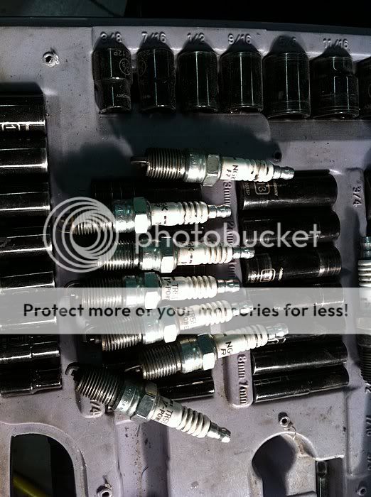

After that, the truck STILL wouldnt start, so I pulled all the spark plugs out and cleaned them. It fired right up after that!

So the plugs fouled again and trying to start it I broke the starter with a little backfire/kickback. sigh... So luckily we buy so many parts from them through my shop I got it swapped out with ANOTHER new one. I also bought a set of NEW plugs this time. and again, it fored right up. (that was a one month process to do all that by the way).
