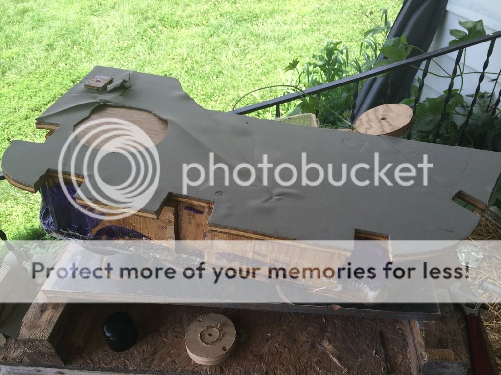

To start off with, I applied CCF (closed cell foam) to the backs of the enclosures to keep any possibility of a rattle between the back of the wood enclosure and the sheet metal of the door panel to a minimum.
http://i889.photobucket.com/albums/a...B.jpg~original

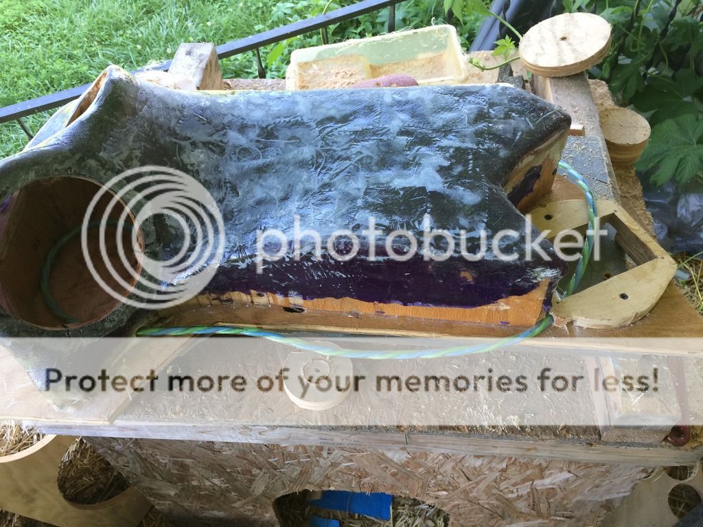

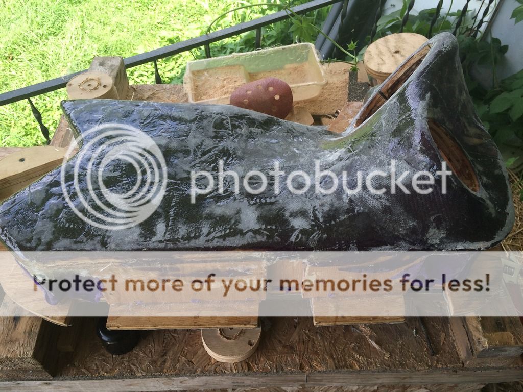

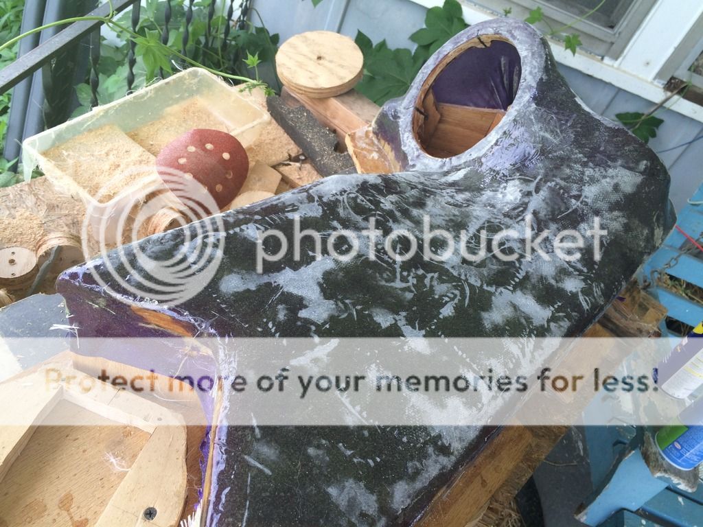

Here's how the enclosures turned out.
http://i889.photobucket.com/albums/a...E.jpg~original
http://i889.photobucket.com/albums/a...7.jpg~original
http://i889.photobucket.com/albums/a...8.jpg~original

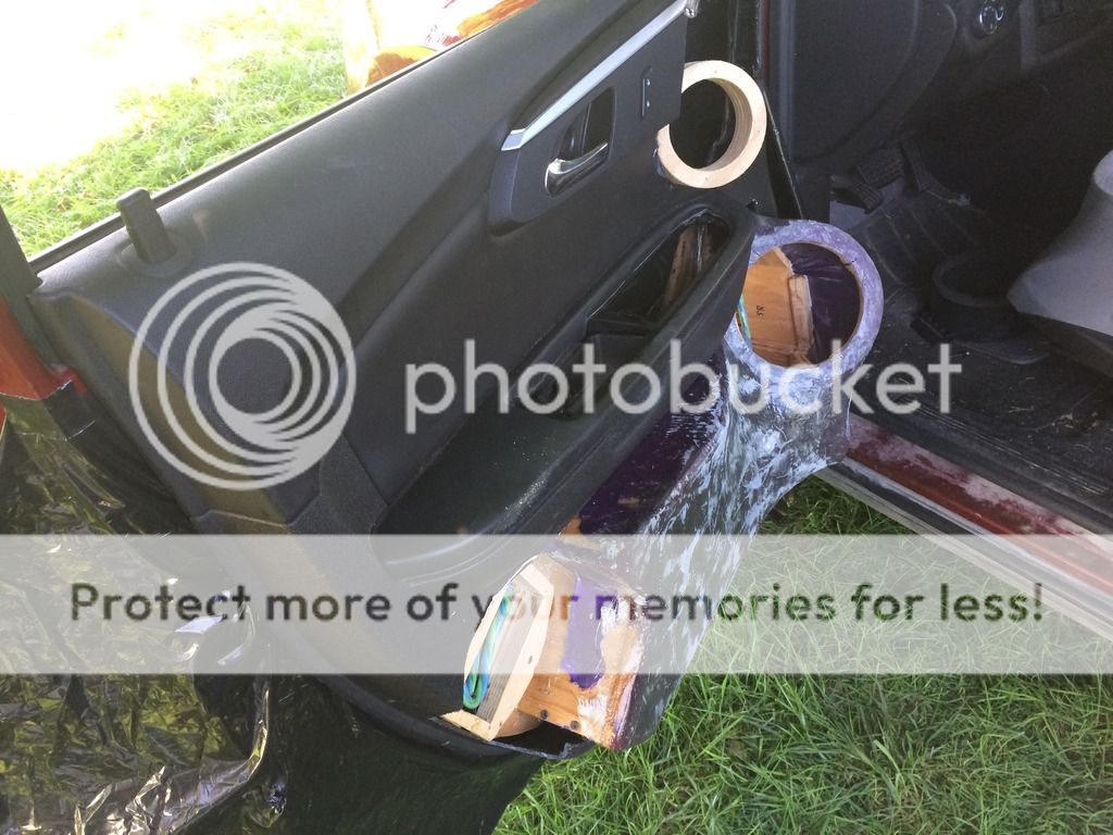

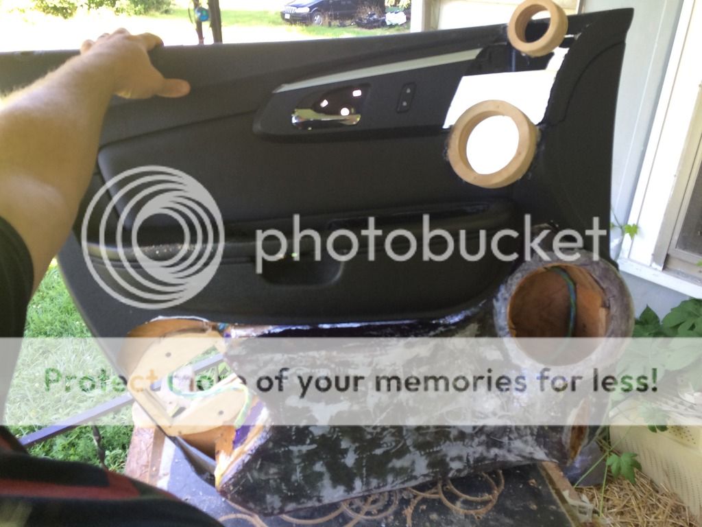

Here's what the door card looks like with the enclosure resting in it.
http://i889.photobucket.com/albums/a...4.jpg~original

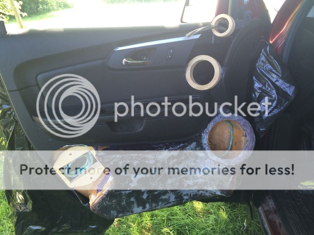

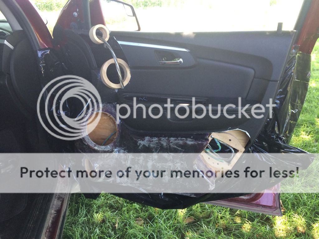

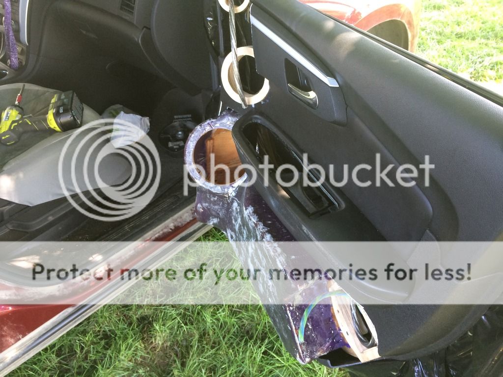

Here are some shots of the doors with the door cards and enclosures in place before applying the foam.
http://i889.photobucket.com/albums/a...D.jpg~original
http://i889.photobucket.com/albums/a...0.jpg~original

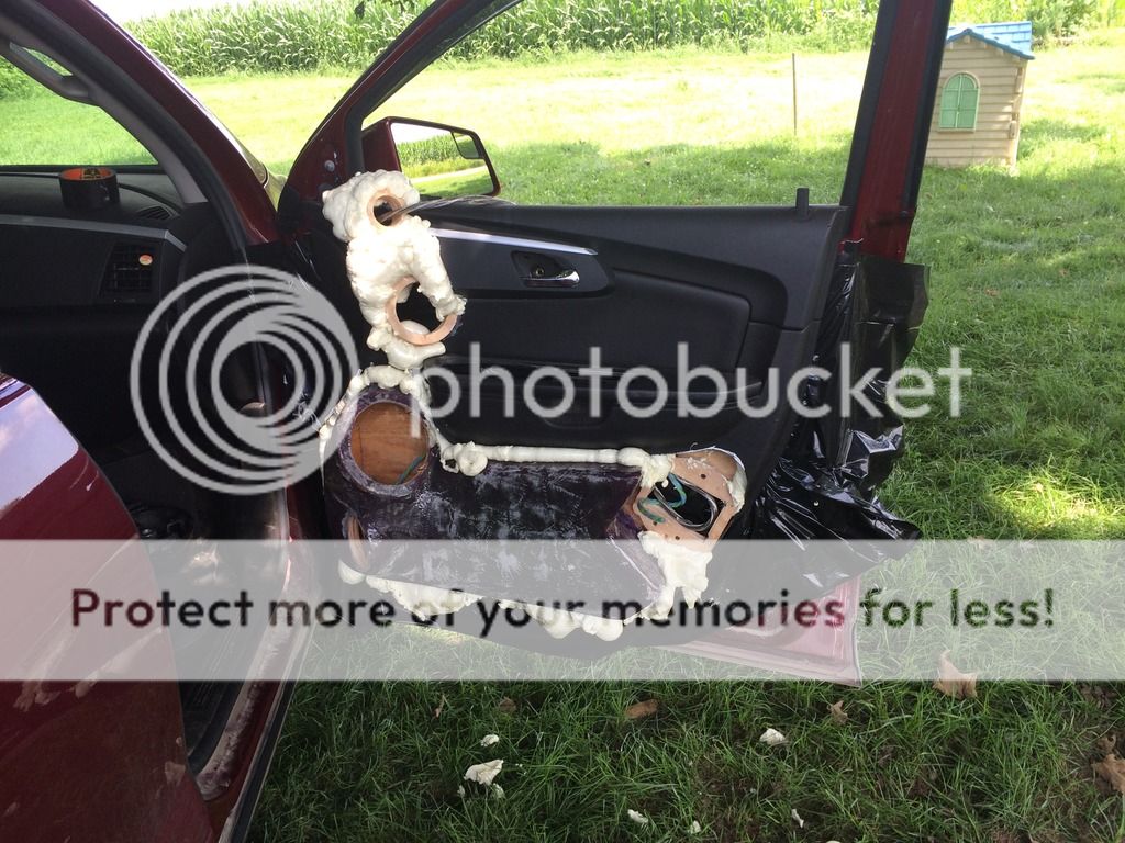

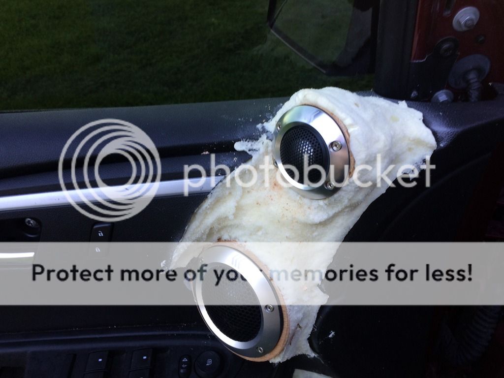

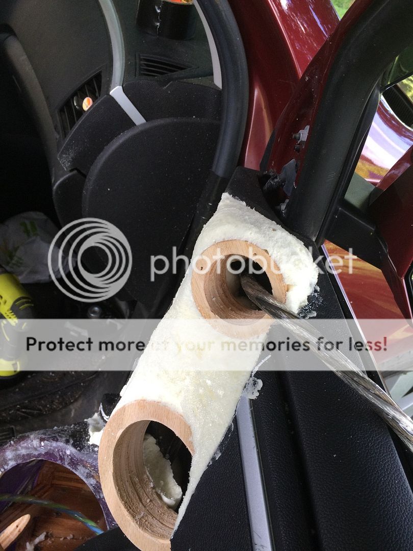

These two pictures show the doors after I've applied the foam. I used just regular old Great Stuff expanding foam in the can that any person can pick up from Walmart, Lowes, Home Depot, etc. I had originally planned on using crafting foam but when I tried to cut and apply it in the irregular locations of the top of the doors with the tweeter and midrange rings in the way I just couldn't get it to go without a LOT of trouble. I decided to just use the expanding foam to do the shaping around those speaker locations along with setting the enclosures in the door cards. Right now they look pretty bad, lol.

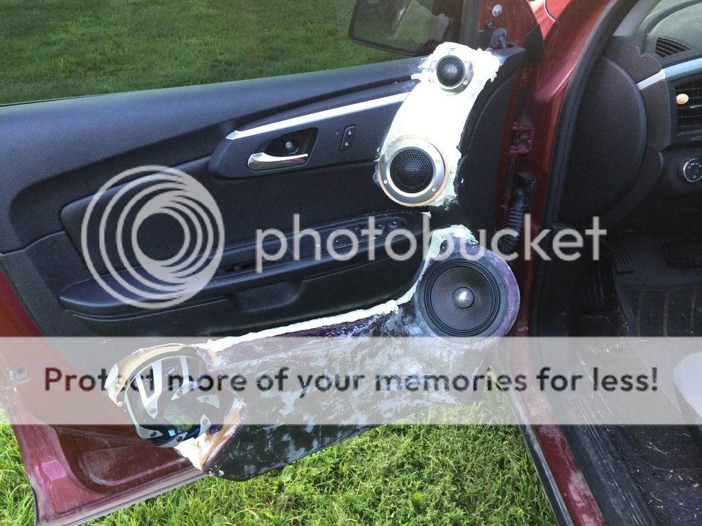

And finally here's what they look like with a little work on shaping the foam and with the speakers installed. I only worked the foam enough to get the basic shape and to get everything out of the way for the speakers to mount and the door to close. There's still more foam that needs to be applied, shaped, and then finally the fiberglass can be applied over it.

So, the speakers do sound fantastic even though I still need to do a lot of work to get everything dialed in and most of that work can't be performed until the false floor amp rack is installed so that the Harmony DSP and amp are there to run the speakers with. They have an amazingly natural sound and the staging and imaging are almost spot on. Still the most impressive part is the bass response with these enclosures, we'll barely even need the subs.

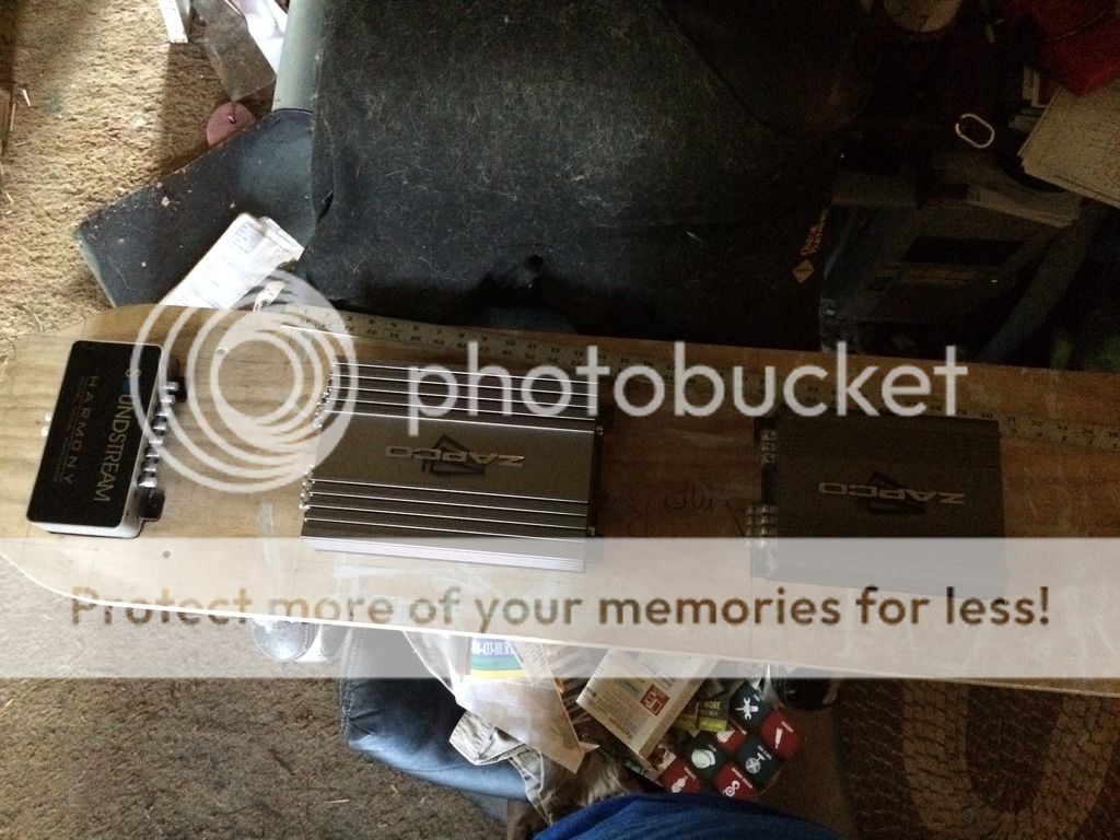

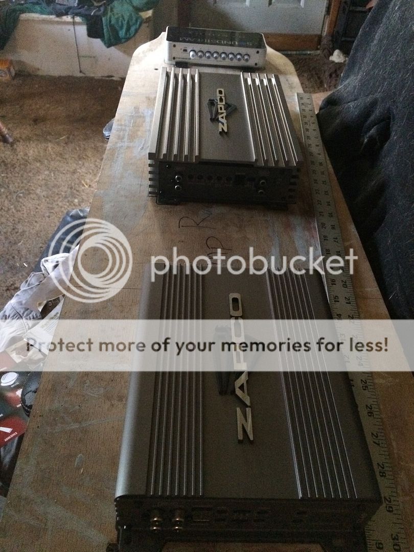

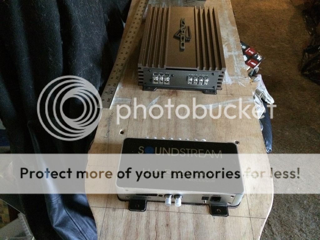

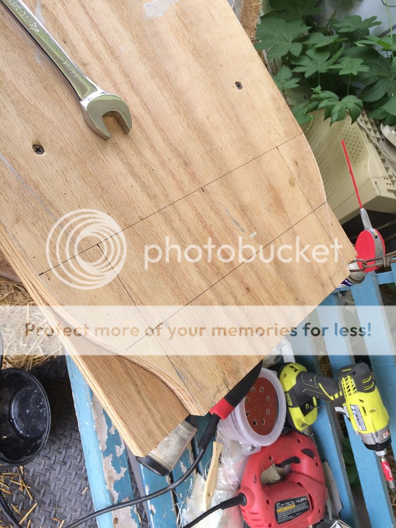

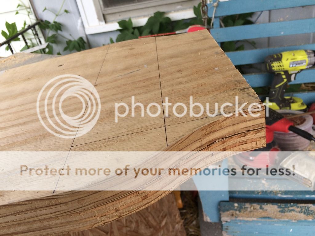

I got a little work done on the amp rack today. So far I got the shape of the front of the amp rack/false floor down and the placement for each of the amps and the Harmony DSP. The more we listen to the speakers the more unreal the bass response is. Two friends that I've played them for thought the subs were already in the truck. It's going to be a real treat to get the amp on them and feed them what they're begging for! Onto a few pictures of the amp rack/false floor.
I am narrowing the front of the amp rack/false floor to match the width of the arm rest. That way it looks a little more natural being there. I used my flush trim bit on my router to match the boards up so they're both exactly the same.

Here's the layout for the amps and DSP. I have the sub amp in the center so that the power and ground wire runs are as short as possible to it since it will be drawing the most current. The DSP is at the front to get the signal from the HU and distribute it accordingly to the amps.
