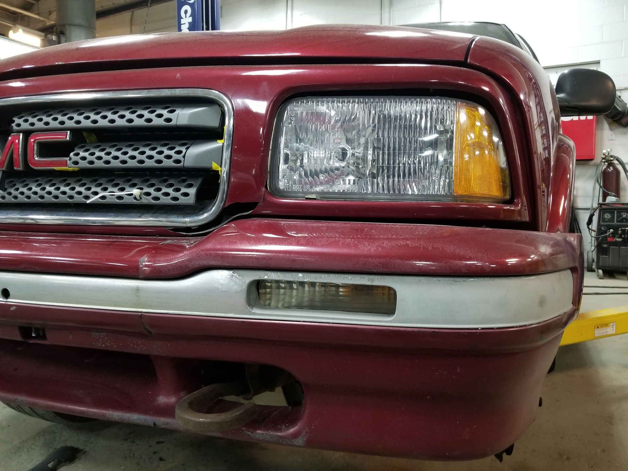

I gotta figure out something to do with this front bumper, it definitely took a light hit before.... possibly an envoy bumper swap if I can find one cheap... You can see how far off it is in this picture. Under the headlight and in the corner
https://cimg5.ibsrv.net/gimg/blazerf...a02f318d26.jpg

Unfortunately buffing it made me notice all the bodywork that's been done to the nose, and all these chips down the passenger side..but at less than 500$ total invested for a reliable running driving 4x4 truck- I still have no complaints.
https://cimg6.ibsrv.net/gimg/blazerf...24d5d8ced9.jpg
Decided in definitely going to try and find an envoy front bumper for it...I'm going to call around to junkyards and parts suppliers tomorrow

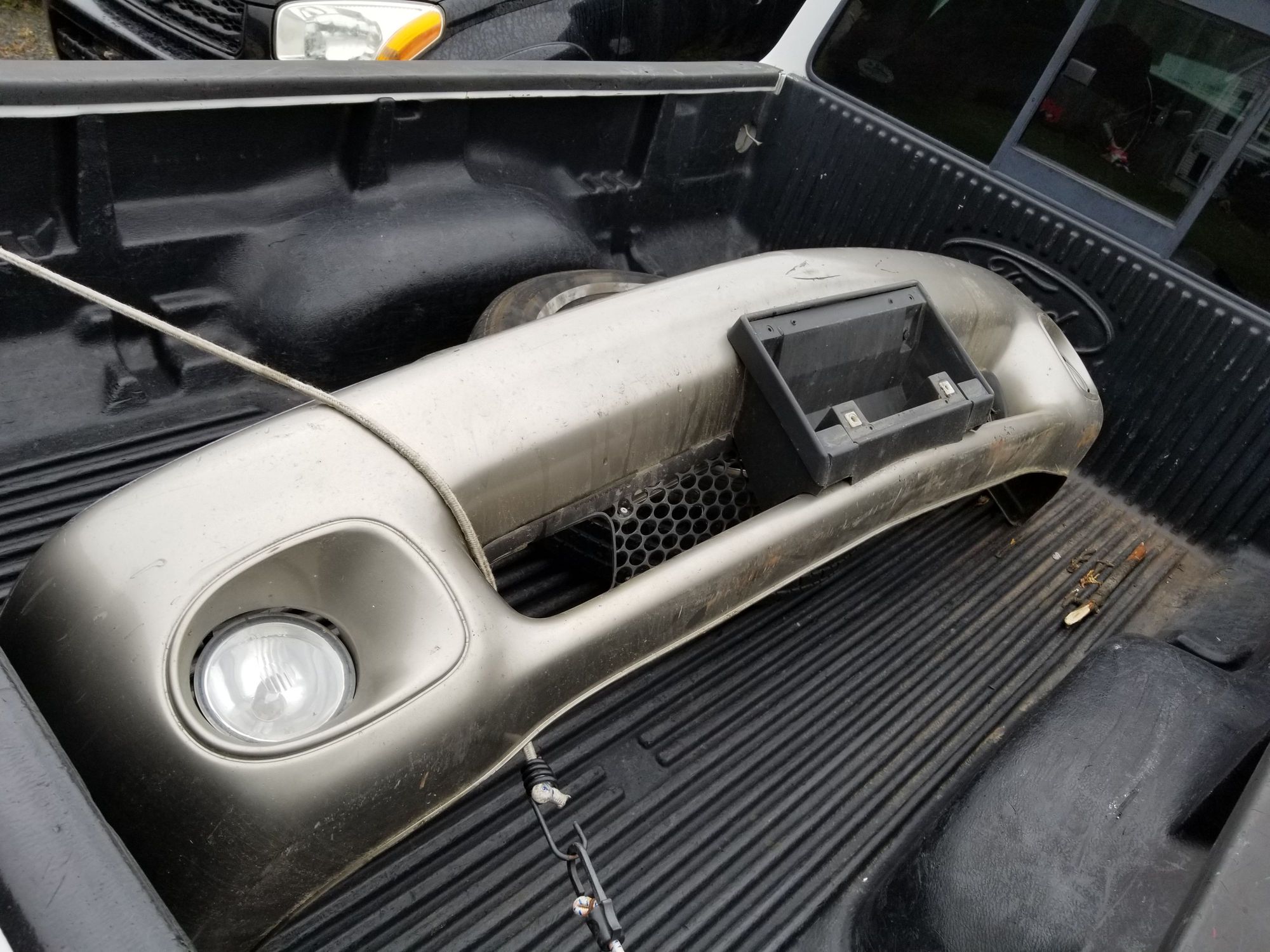

Edit: forgot to add, I found a local junkyard with a 98 envoy, they are supposed to call me back tomorrow morning after they check the condition of the front bumper and rear spoiler- so I'm crossing my fingers- because it would look pretty sweet with that bumper, and spoiler(which I would paint body color)
chevyriders 11-15-2017 08:02 PM
So it's been a minute here, my blazer was taking all my focus for a while.
The envoy bumper/spoiler fell through- they had me come up to look at the bumper before they pulled it off the truck to make sure I was happy with the condition...when I got there- they didn't even have the envoy they said they did...they were all the new body style...so that was annoying.

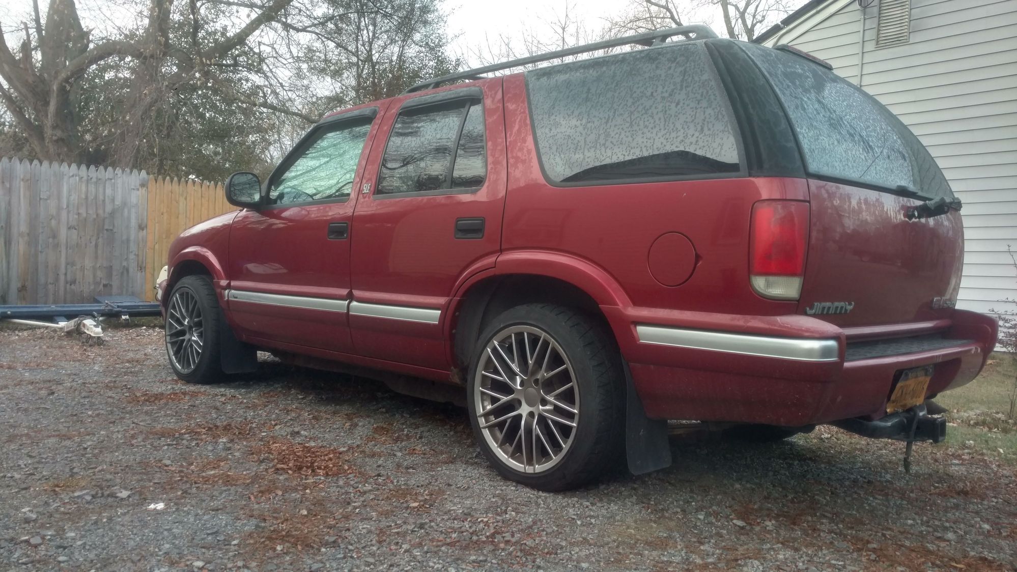

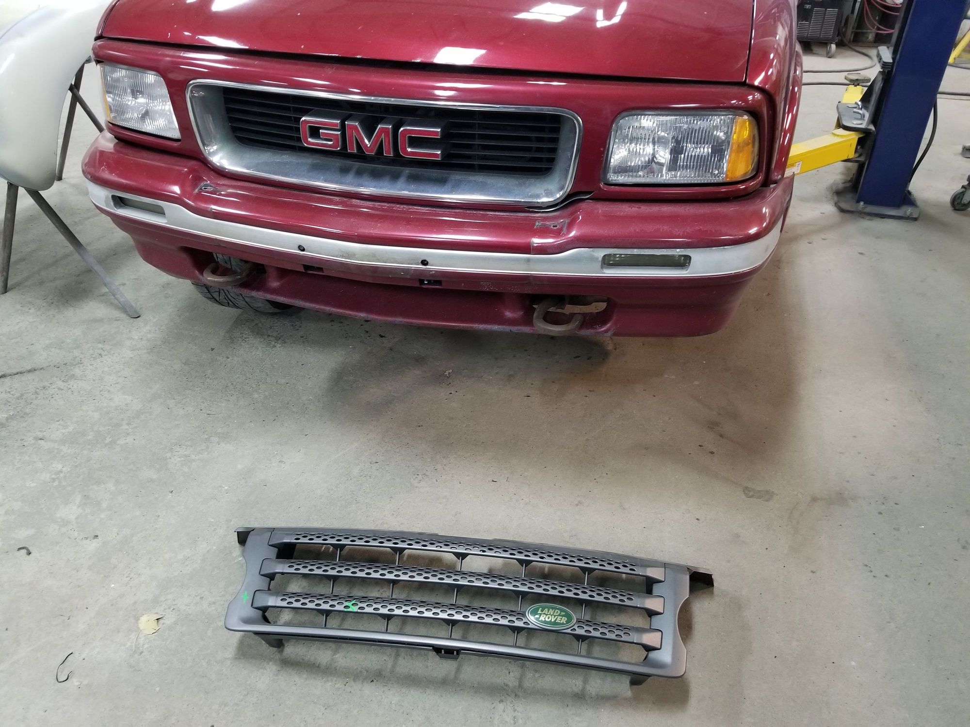

My woman kept saying how she couldn't wait to get a new truck this coming year so she could get one with a remote starter...since I got this as a winter driver for her, I decided to surprise her and order a remote starter for it.
https://cimg2.ibsrv.net/gimg/blazerf...b129efb033.jpg
Also should be getting 1.5" spacers for the rear wheels by next week.

chevyriders 11-19-2017 06:32 PM
Yeah...she was more like"why are you putting Corvette wheels on before winter?"....so today I went and got a set of blizzak snow tires for them:icon_goofygrin:
https://cimg6.ibsrv.net/gimg/blazerf...0499821f54.jpg

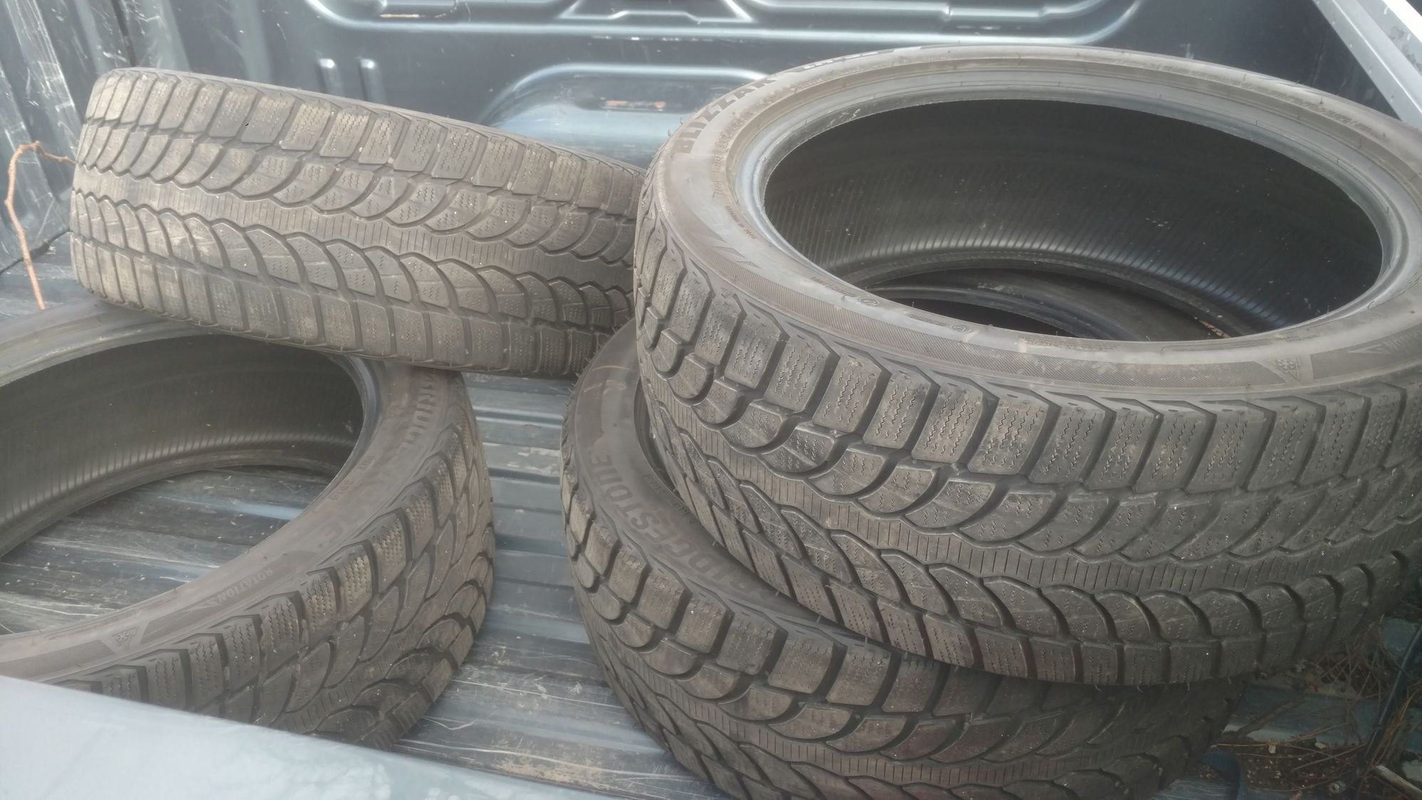

These tires are slightly taller than the 2 that came on the wheels...so it should fill up the wheel well a little better too. So for a total of 375$ I got a nice set of wheels and tires...pretty good deal i think....but I still cringe when I realize that's pretty much the same I paid for the whole truck...:icon_denk:
Got these today too for the rear to even up the wheels a bit.
https://cimg6.ibsrv.net/gimg/blazerf...c244ed90ef.jpg

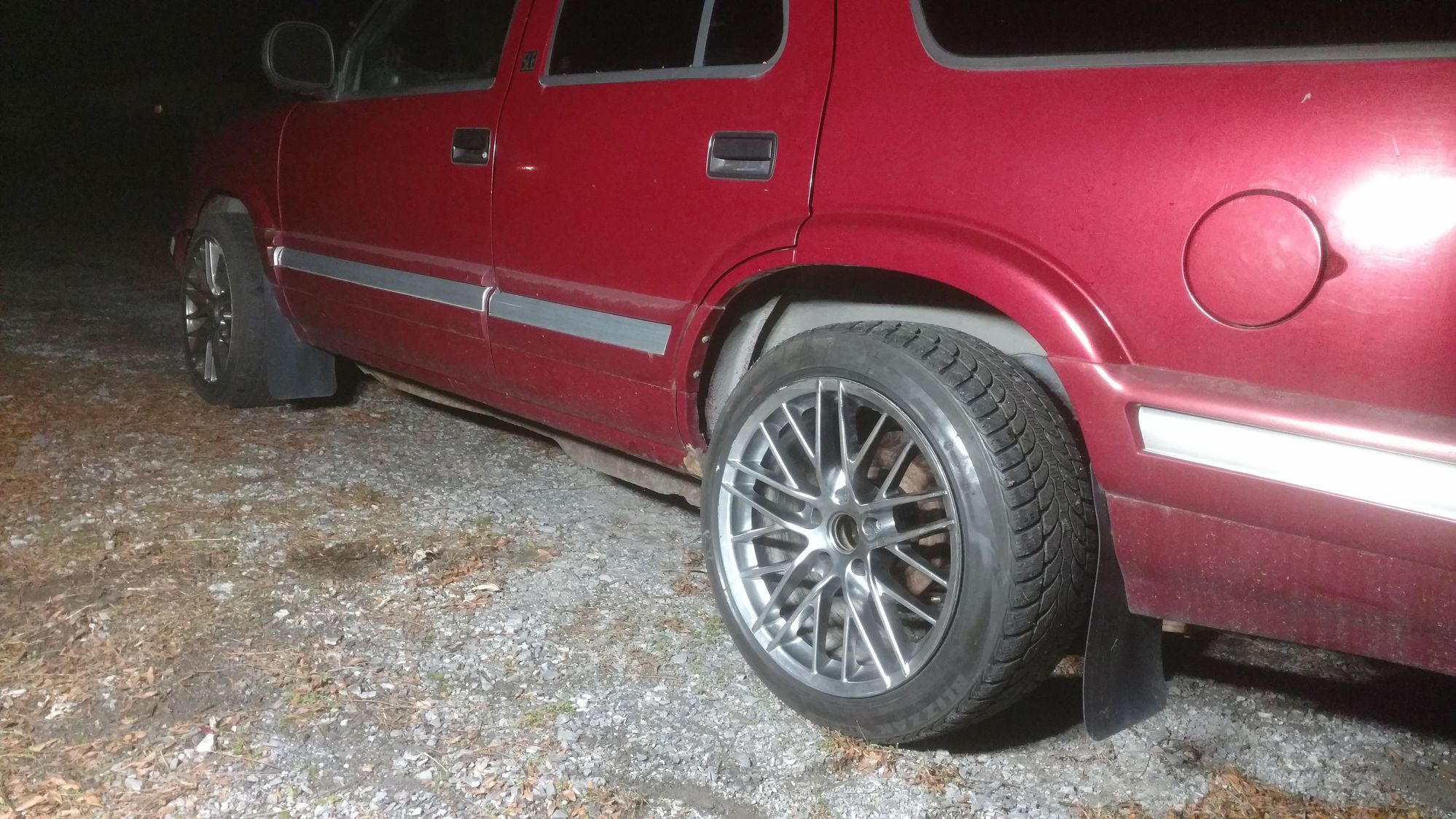

chevyriders 11-22-2017 05:06 PM
So I got the spacers on the rear, mounted 2 of the blizzaks on the empty wheels and got them on the truck.
https://cimg8.ibsrv.net/gimg/blazerf...4ed3274df1.jpg (for reference the truck is not sitting on that little garden edger block lol)
https://cimg4.ibsrv.net/gimg/blazerf...9692ce7f3c.jpg

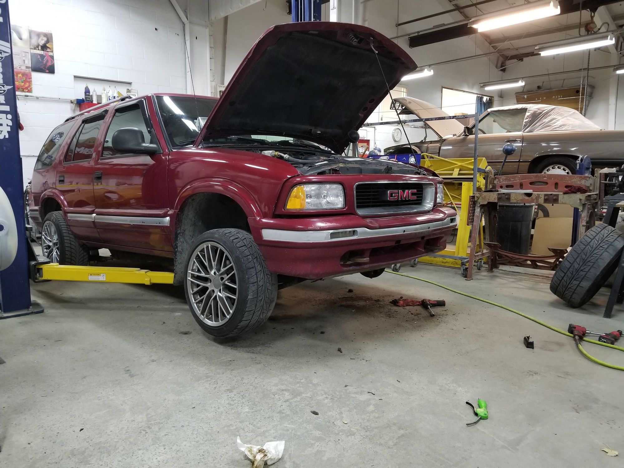

Today I got surprised with half of the day off for Thanksgiving ...so I made use of the time by painting the rear window vents body color.
https://cimg6.ibsrv.net/gimg/blazerf...9bf96d6afe.jpg
The color looks slightly off, but the quarter panel paint is super oxidized because it hasn't been buffed yet- so I think it'll match much better once I buffed the rest of the truck
stevbre1 11-22-2017 08:18 PM
It looks great with the spacers on the rear wheels!

While the truck is suck on the lift , I figured it would be a good time to a dress the sagging bumper issue.....a little bit of adjustment, reattached a bumper guide that pulled off, and bent back a bumper support bar....And it looks much better now!
https://cimg2.ibsrv.net/gimg/blazerf...649c2b77ec.jpg
https://cimg5.ibsrv.net/gimg/blazerf...eb8ea3bb7f.jpg
Not perfect, but it will do until I get a replacement bumper....still haven't had any luck with an envoy bumper, so I may just get a factory in replacement, or a bravada bumper until I can source an envoy one.

I've been looking at this grille since I took it off the range rover wondering how it'd look modded with the gmc grille.. So I started playing now that the range rover is done.
https://cimg1.ibsrv.net/gimg/blazerf...806065a0fb.jpg
Just rough cut and tossed in to get an idea, it would have the tapered ends on all 3 rows, not just the upper 2- and the ends would start in line vertically....painted either bodycolor or the same color silver as the roofrack...... but general idea is:
https://cimg4.ibsrv.net/gimg/blazerf...2b05c6f9e2.jpg
Not 100% if I'm gonna run it or not.
Open to hearing opinions on it, good or bad.
DonL 11-30-2017 10:24 PM
Love that grill look... wanna make one for Chevy? Lol

Modified my headlights today to make my directional lens clear
Before
https://cimg8.ibsrv.net/gimg/blazerf...e174f187ce.jpg
After
https://cimg1.ibsrv.net/gimg/blazerf...c5679d7d3d.jpg

I sort of like the Range Rover grill. It is different.
chevyriders 12-05-2017 11:41 AM
Thanks, I have mixed feelings about it so I haven't continued on it yet
Look at what I found finally
https://cimg6.ibsrv.net/gimg/blazerf...8e49486f7e.jpg
Little envoy bumper action
stevbre1 12-05-2017 01:41 PM
Nice! Looks like it’s in good shape!
chevyriders 12-05-2017 08:43 PM
Thanks! It needs a lil work but not too bad.
