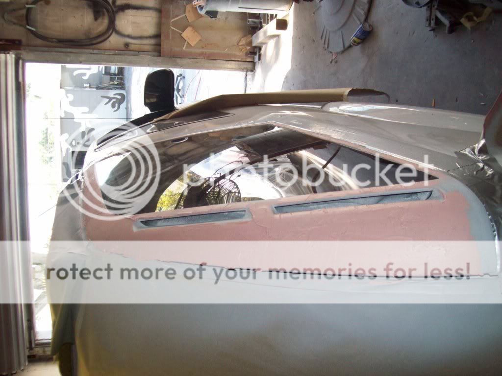

next step is to sand the first coat of primer with 180 grit sandpaper (you have to do this to get the glossyness (for lack of a better word) off the primer and give the body filler something to bite to then go ahead and using THIN coats cover and fill the holes.
i know it looks thick but i kinda messed up and spread it too thick. all you need is a thin coat to fill the holes.
sand the filler down with 180 grit paperso a smooth even surface. once all the high and low spots are taken care of go ahead and give the whole thing another sand down with 220 grit paper and reprime.

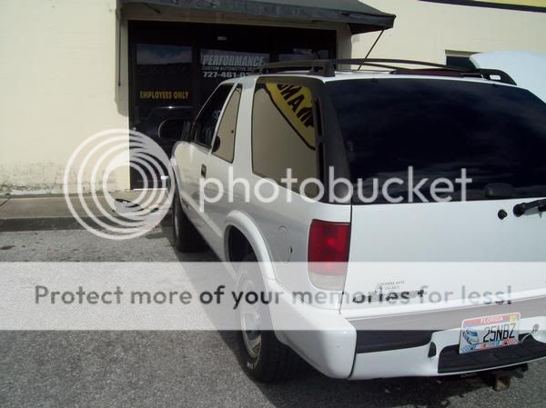

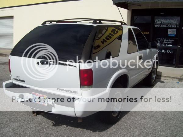

there ya go finished painted (to match) rear window trim.
