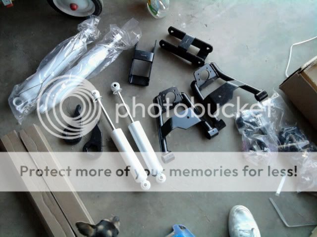

Got my 2" Rough Country lift kit today:
gonna start lifting it the next couple days in my auto class

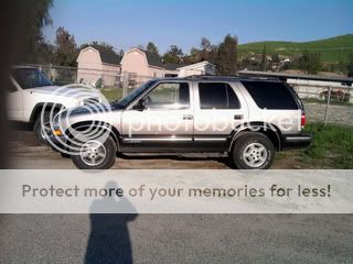

heres how she sits now:
also gonna put a new rotor and cap on it, as i got the p300 >:/

i think you mean rough country, those shocks don't look rancho.

you really only need one part out of that kit to achieve the 2" lift you know?
Old 02-08-2010, 09:30 PM
Dbam31's Avatar
Join Date: Jan 2010
Location: Socal, CA
Posts: 151
Dbam31 is on a distinguished road
yah the shackles
and while i wanted the cheap lift.
I decided to go with something that would give me new parts, to replace the old worn stock parts.
As an extra precaution, I want this truck to last awhile without blowing out parts all the time. So I figured it would pay off in the long run.
And I got a good deal IMOP.
Old 02-08-2010, 09:33 PM
Banned
Join Date: Aug 2009
Posts: 1,162
Spectreblazer is on a distinguished road
yeah i was wondering if you knew about the shackels or not. good to know, those keys are still not going to solve your cv and balljoint issues though. any ifs lift you're gonna run into problems. just don't crank those t-bars to high. i'd only go 1.5" maximum, the keys should be indexed too.

yah i wont go higher than a 1.5"
I just wanted a bit more higher profile, and enough to get my 30's on it.
You know for the record, how would I solve the joint wear out problem? And please don't a BL...
Like if I wanted to do a 4" or 6" (which I might do in the future). How would these problems be solved? Or would they be the same?
I also didn't understand the new keys...are they different from the stock? Thats the only thing I didn't understand why it came with the kit?

there the same they just can charge you more(keys), you want to go bigger you would have to do an straight axle conversion. i considered doing it on mine. its easier just to go buy and old straight axle truck and start with that then hacking your blazer apart. thats what i did, got an old k5, i like the lifted look thought.
