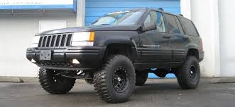

The jeeps you are looking for looks like this
The one off this will NOT work
