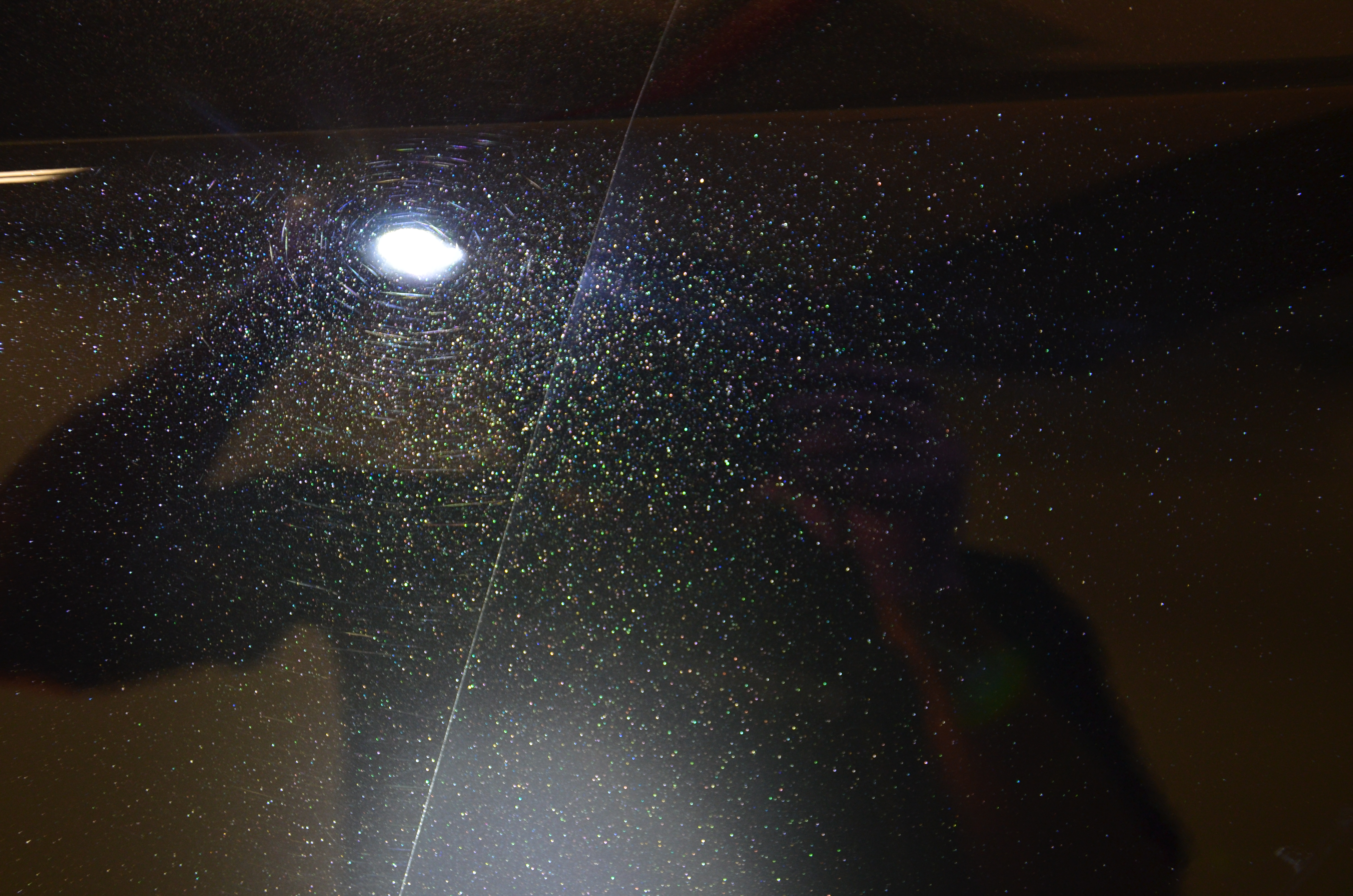

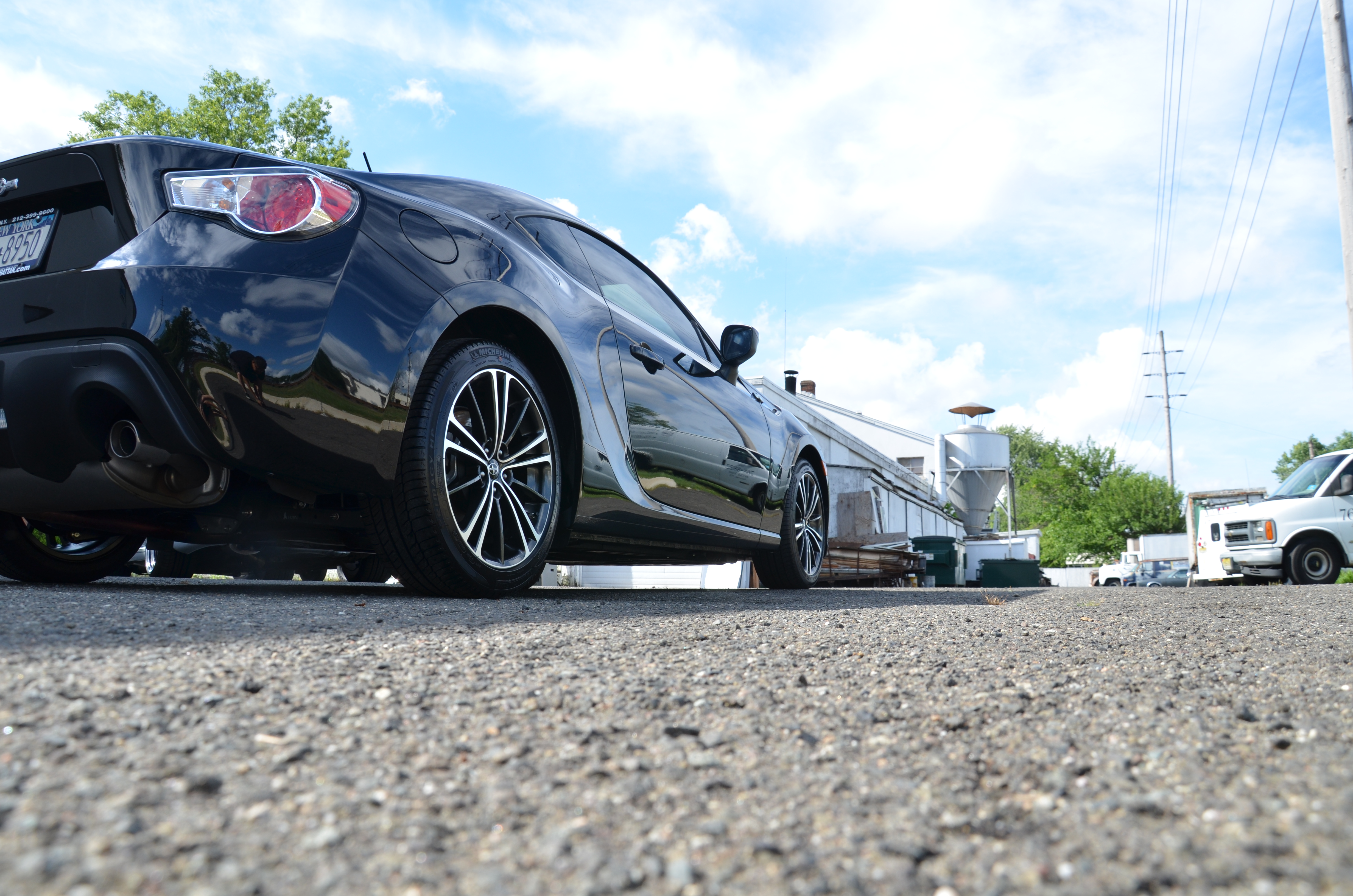

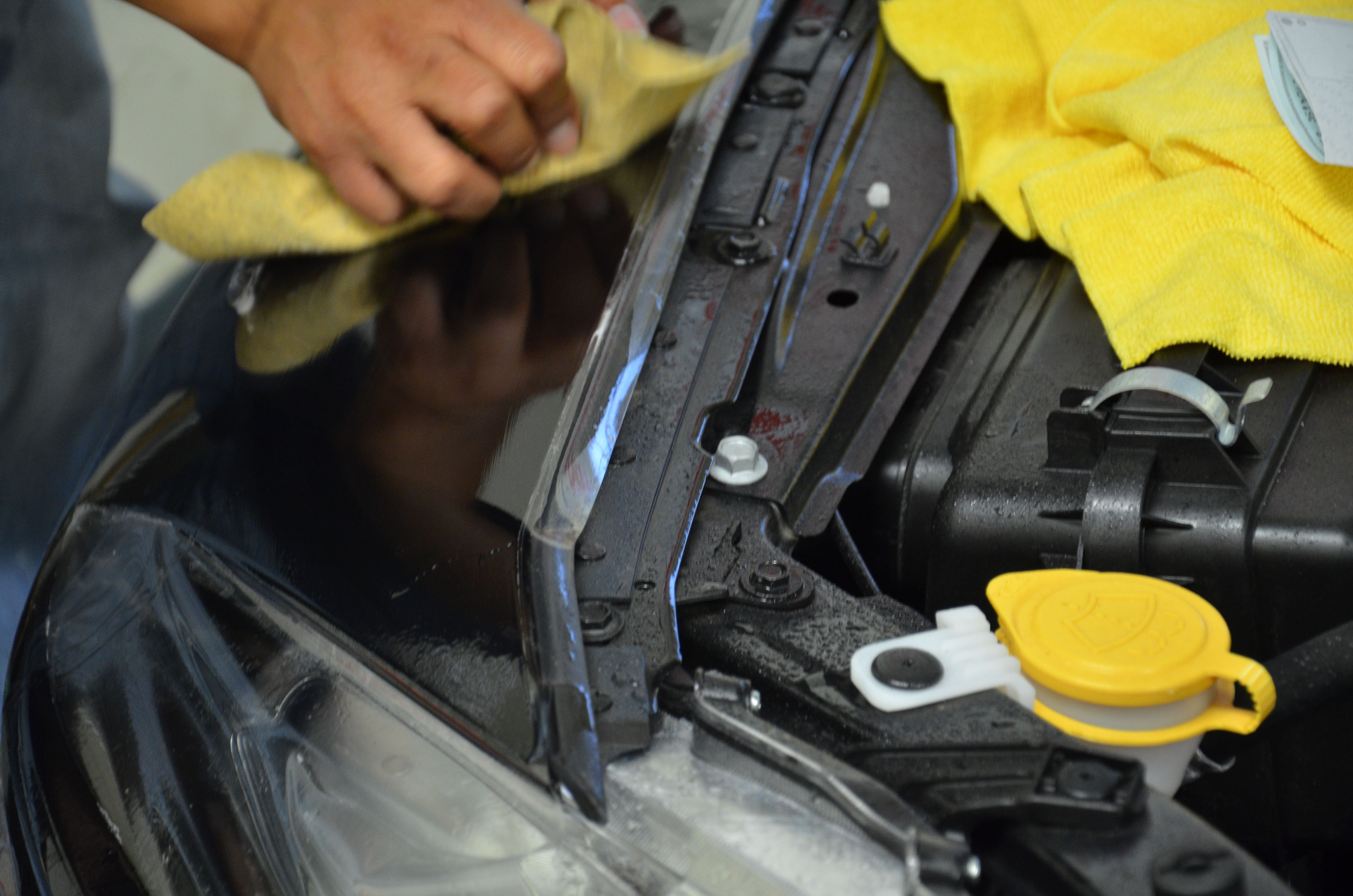

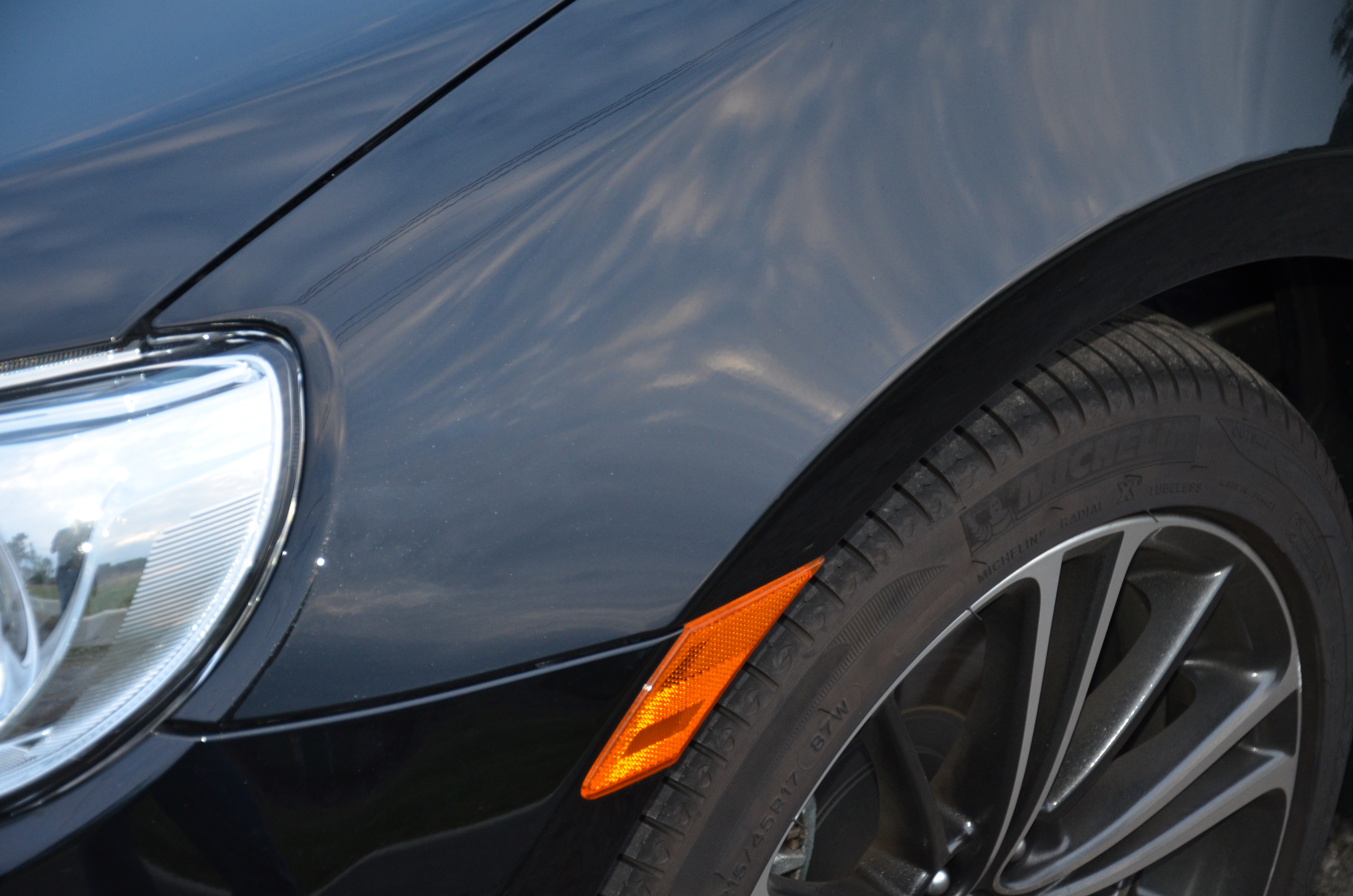

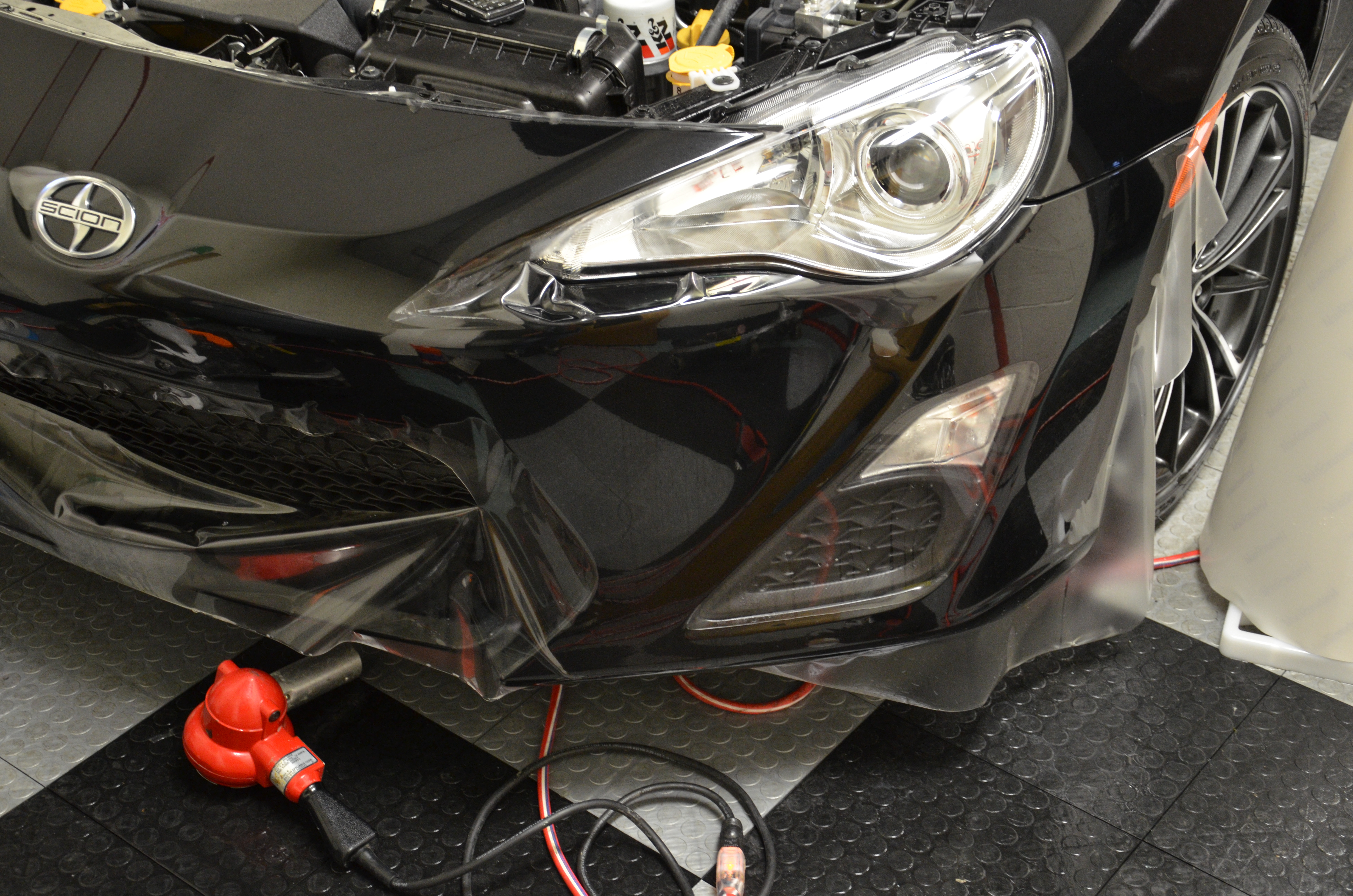

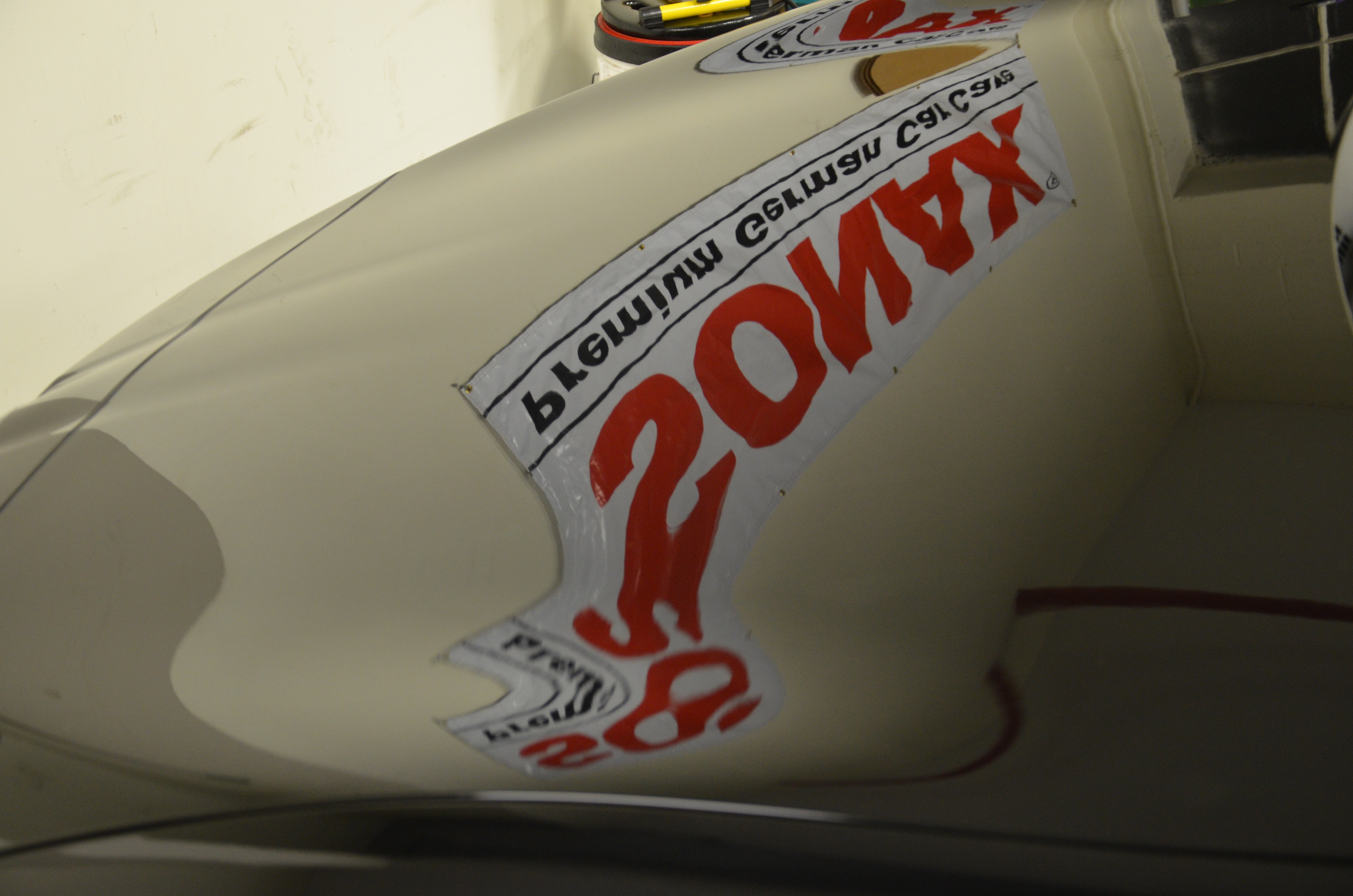

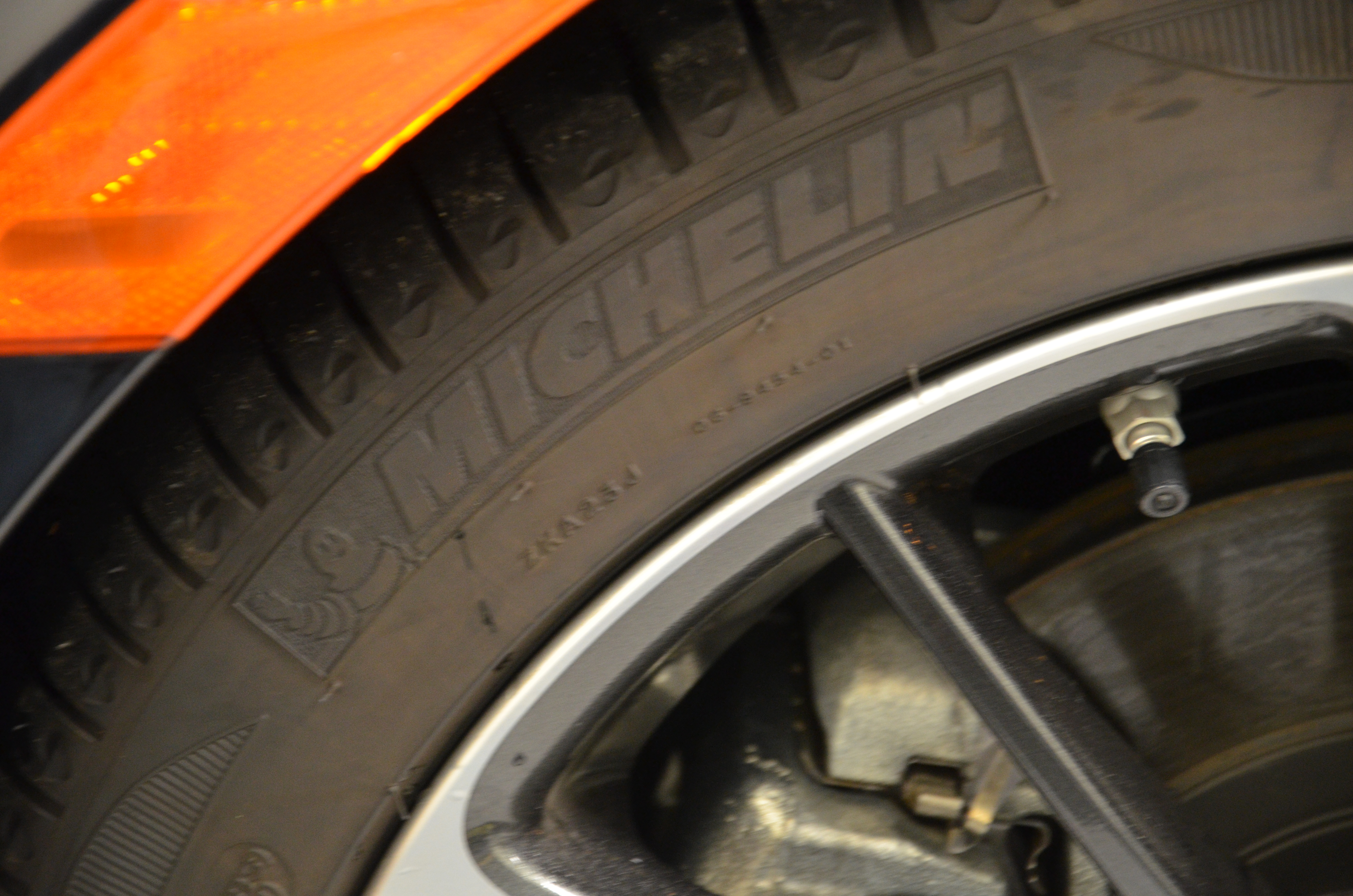

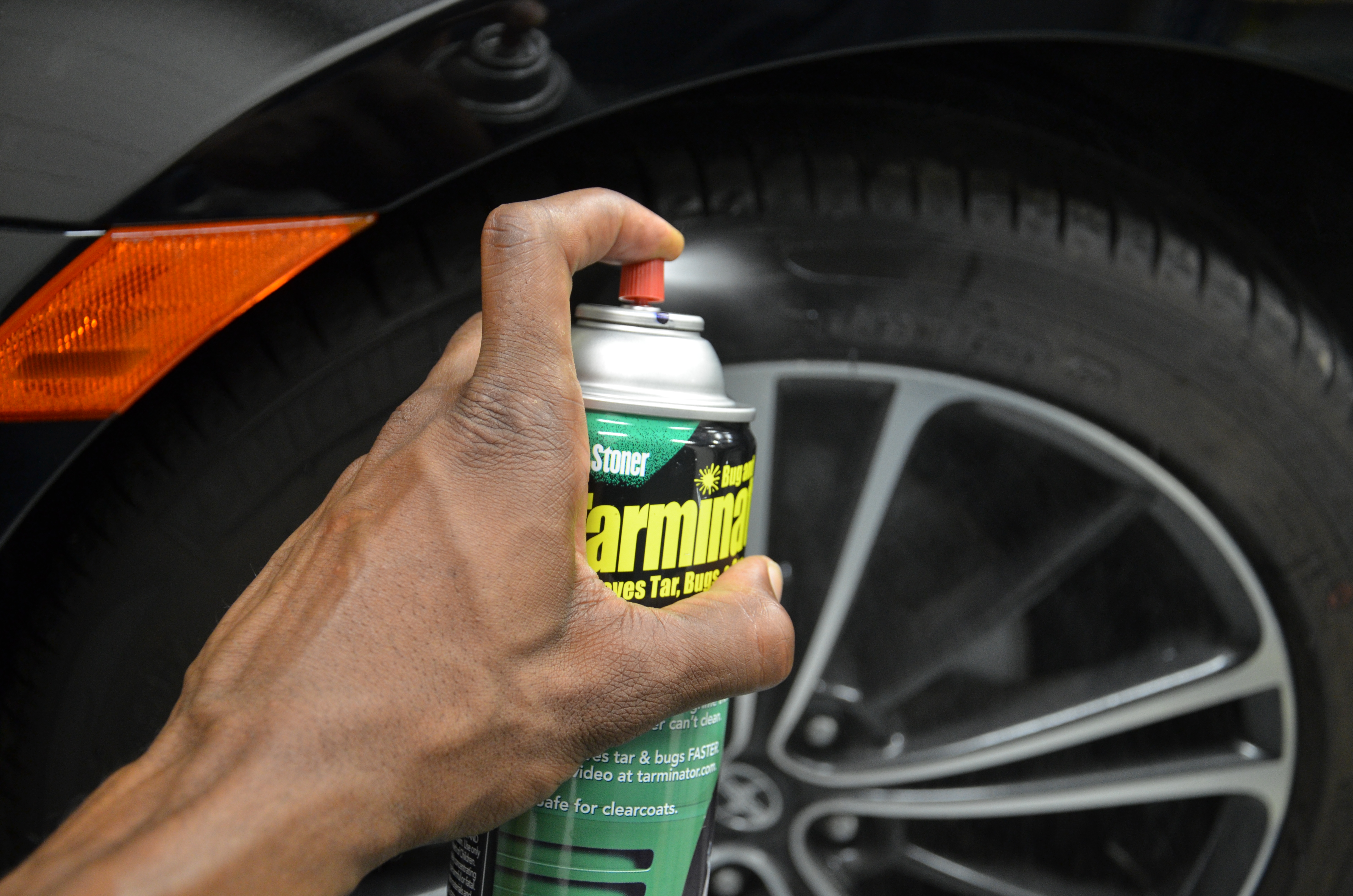

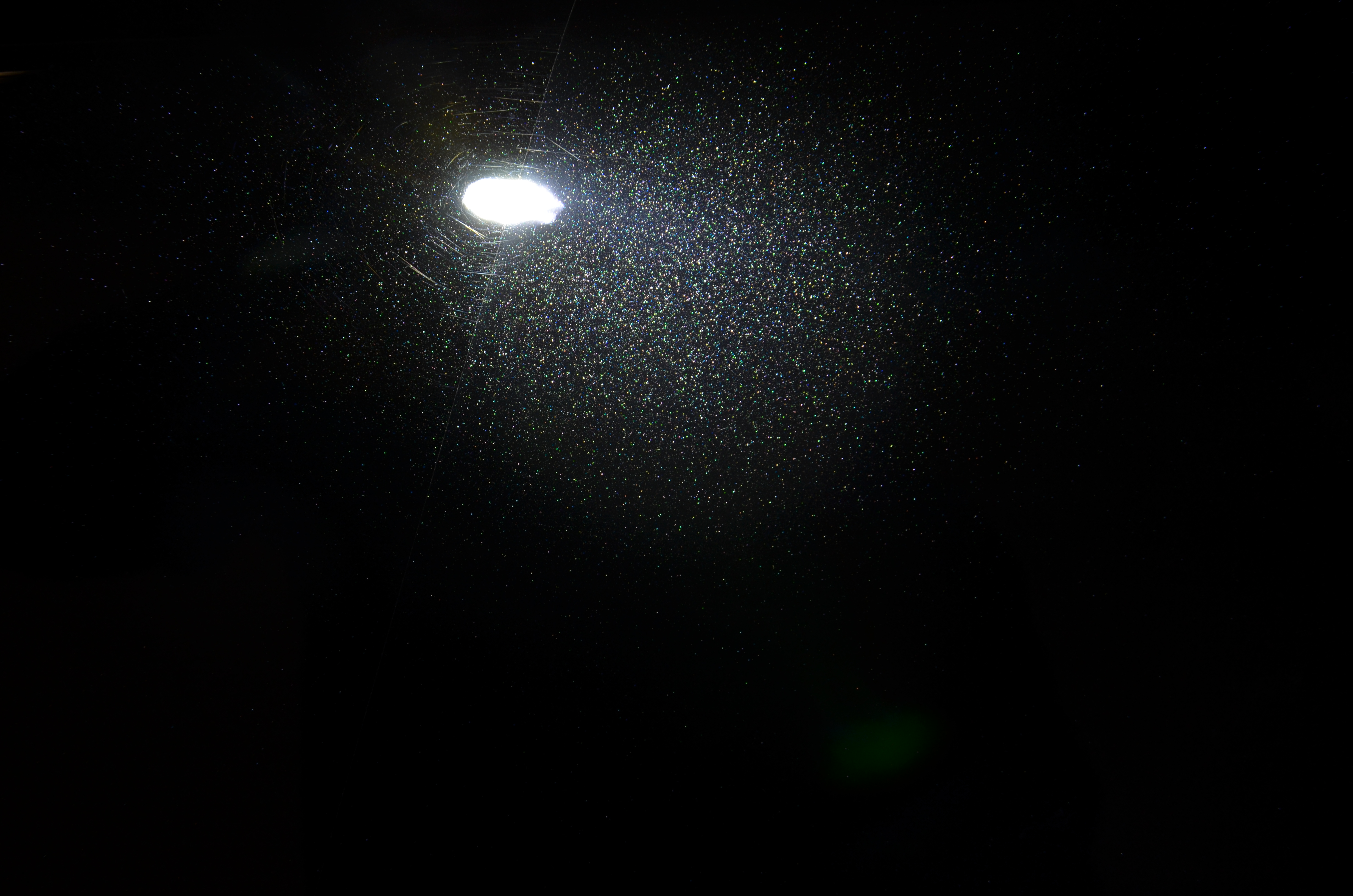

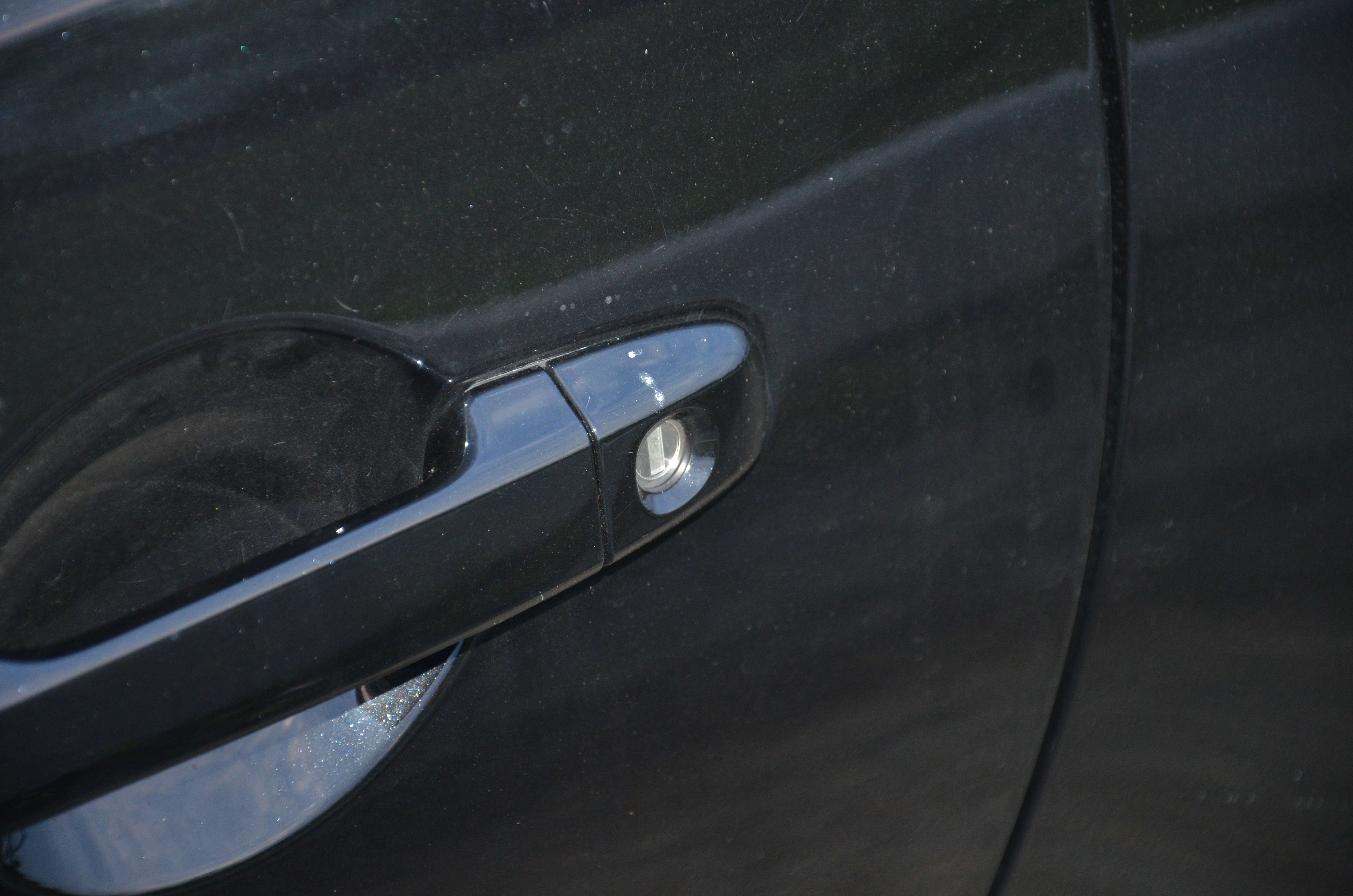

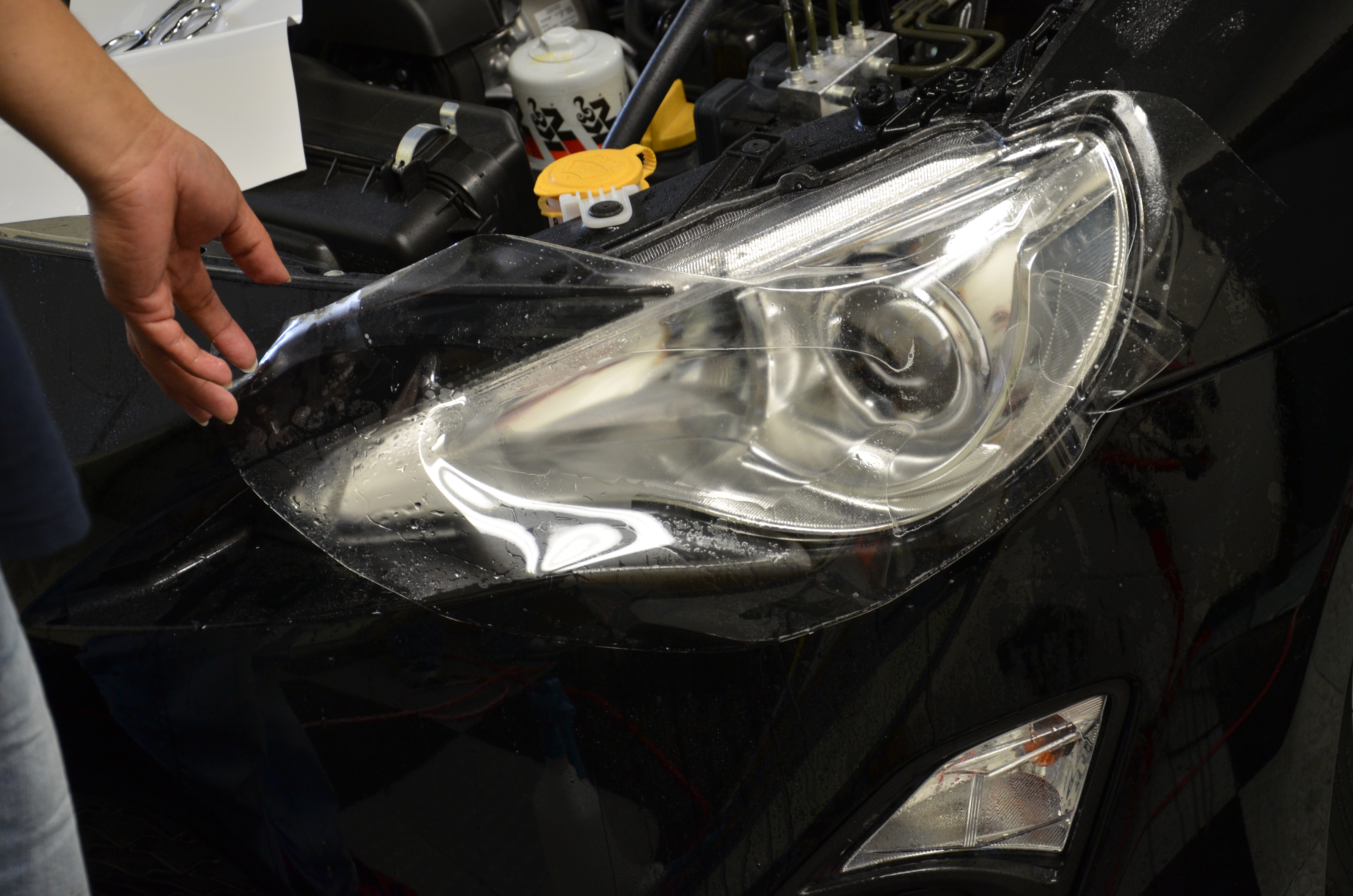

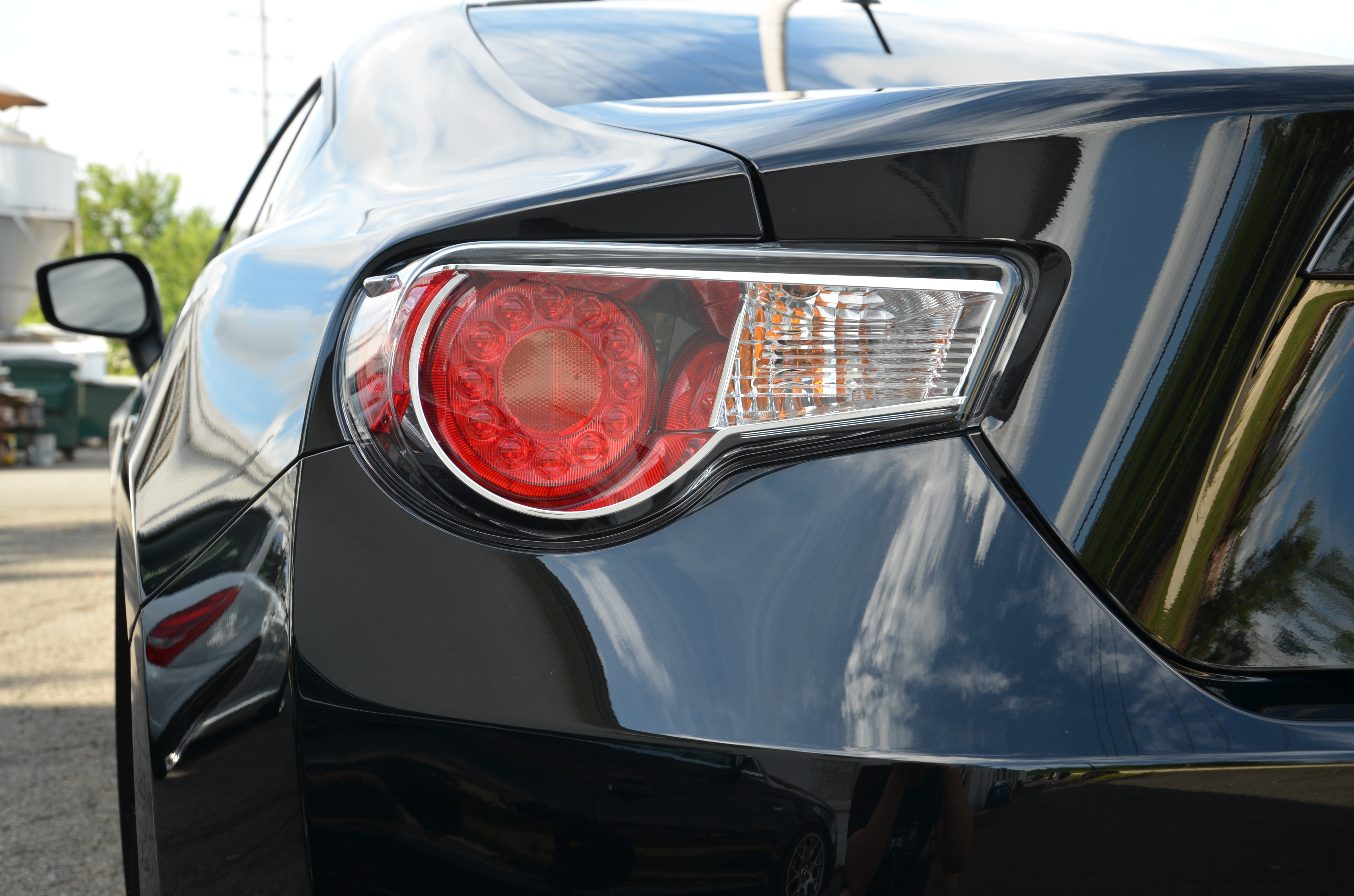

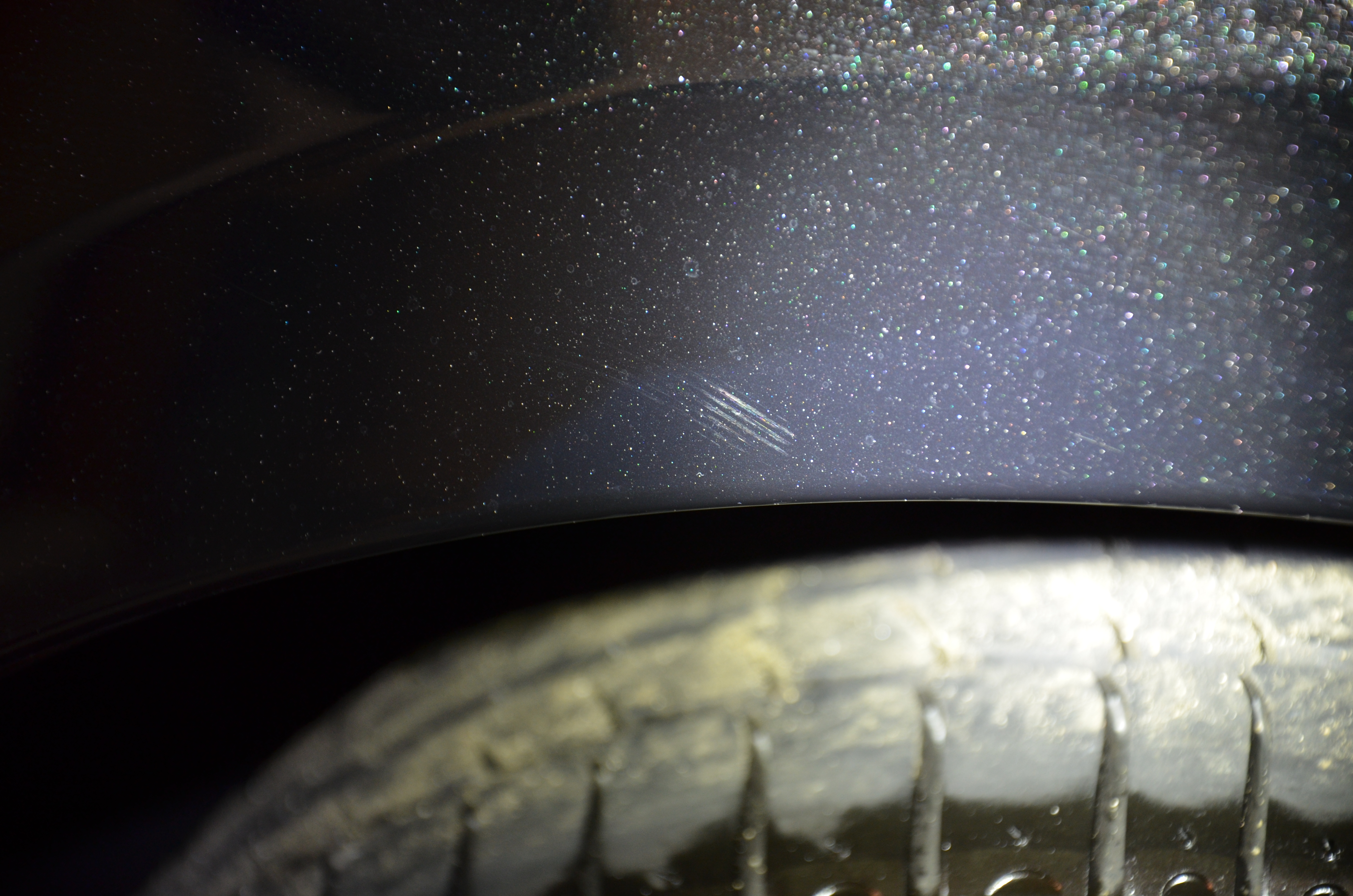

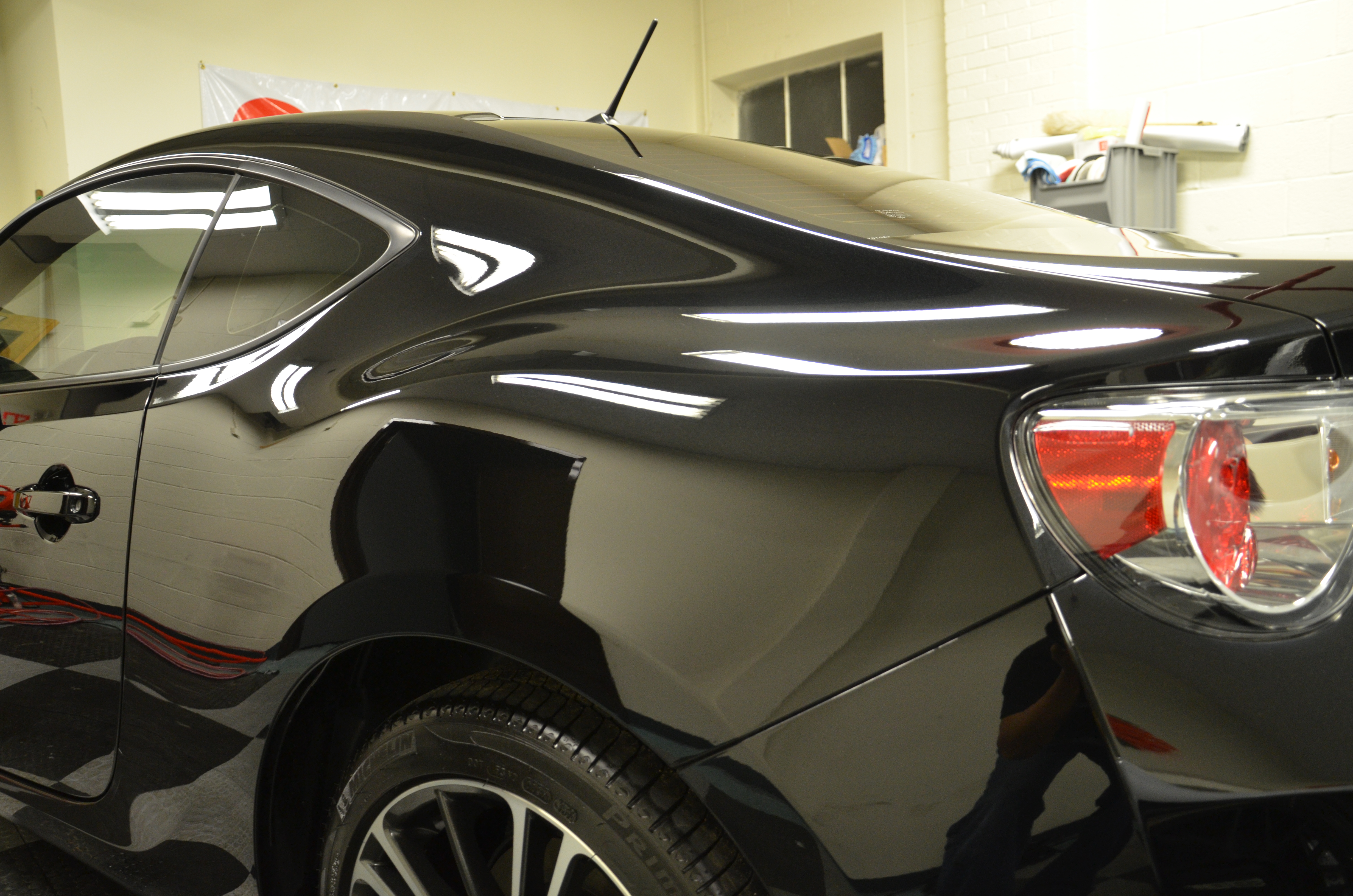

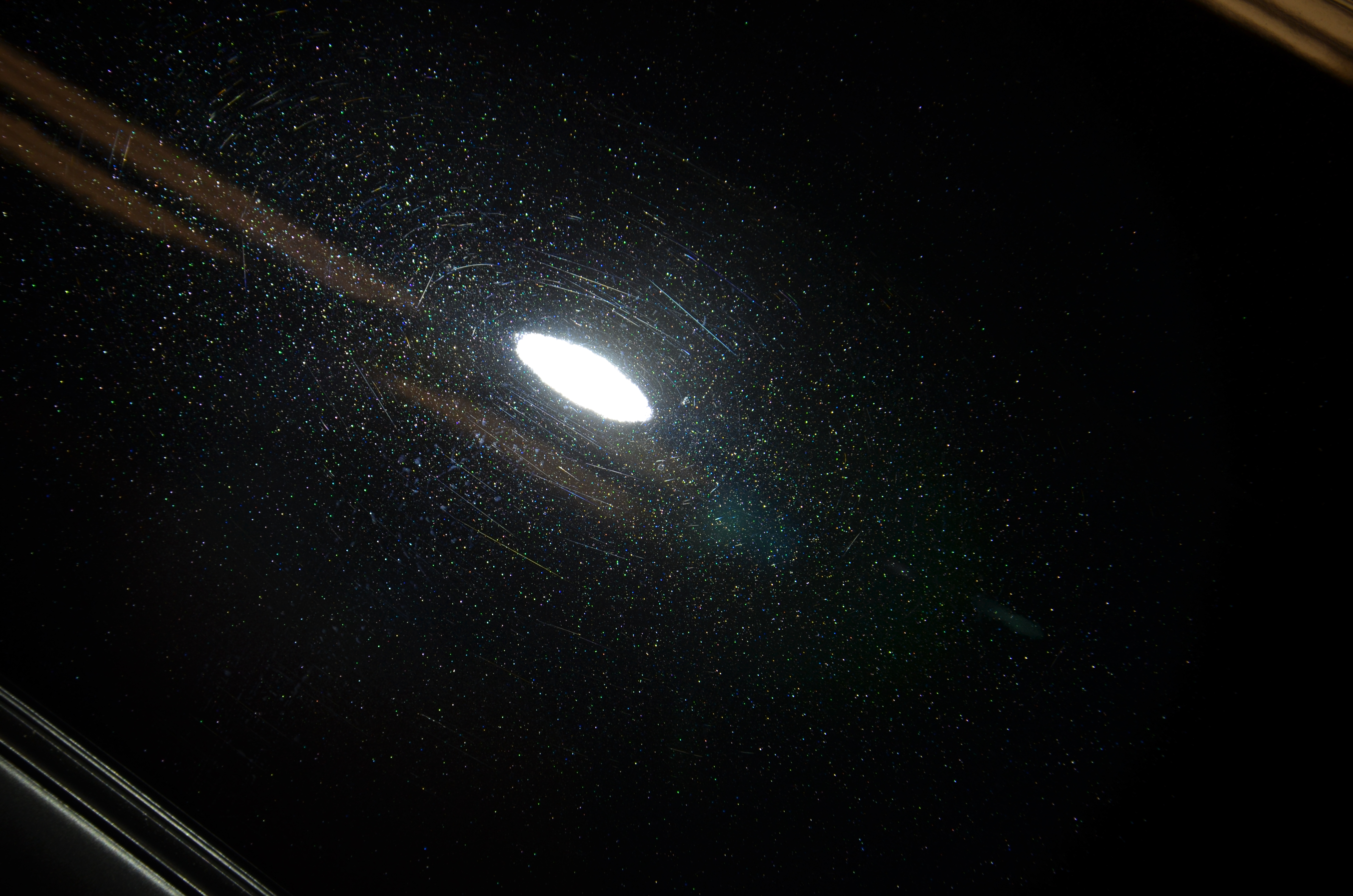

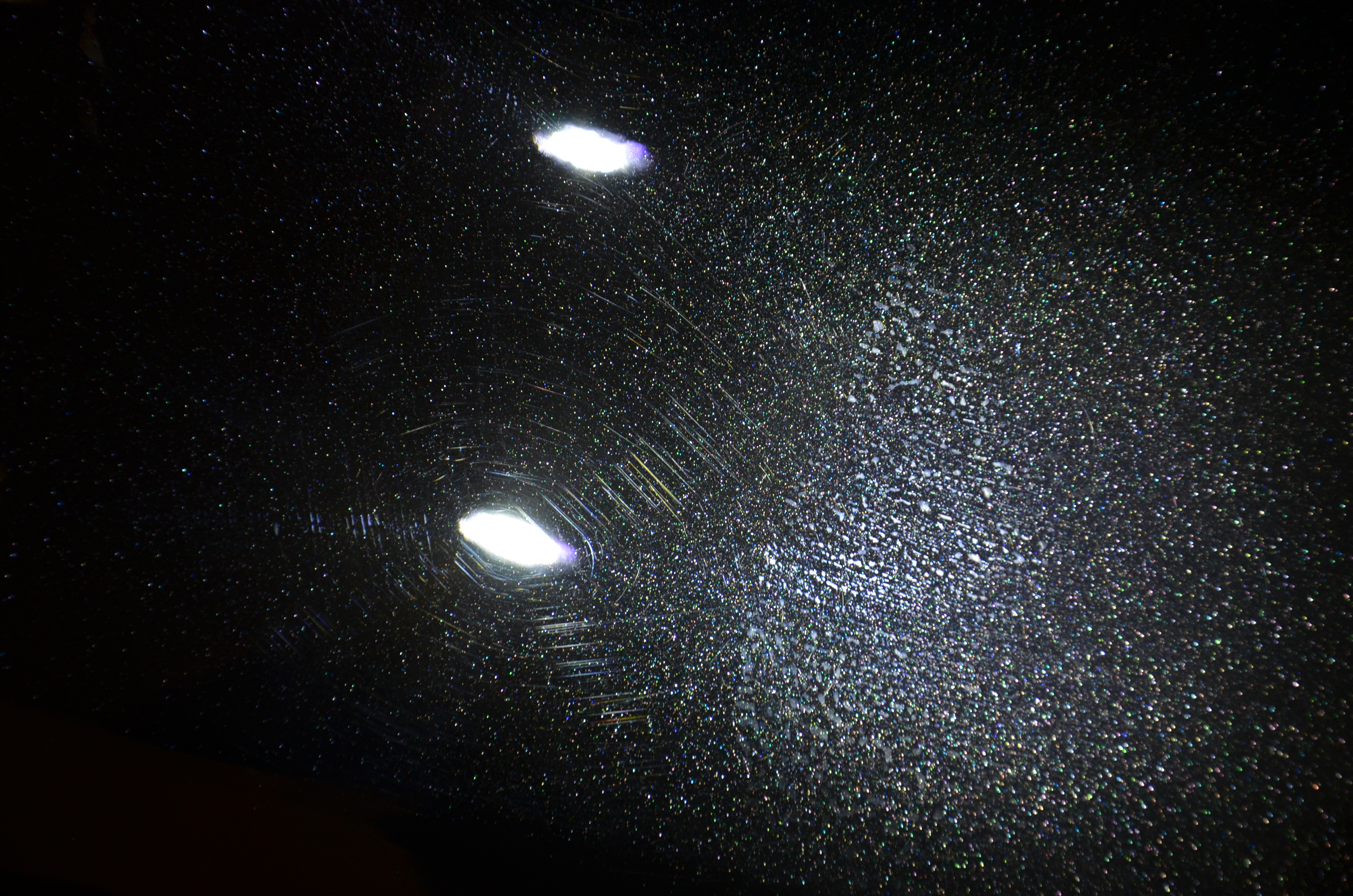

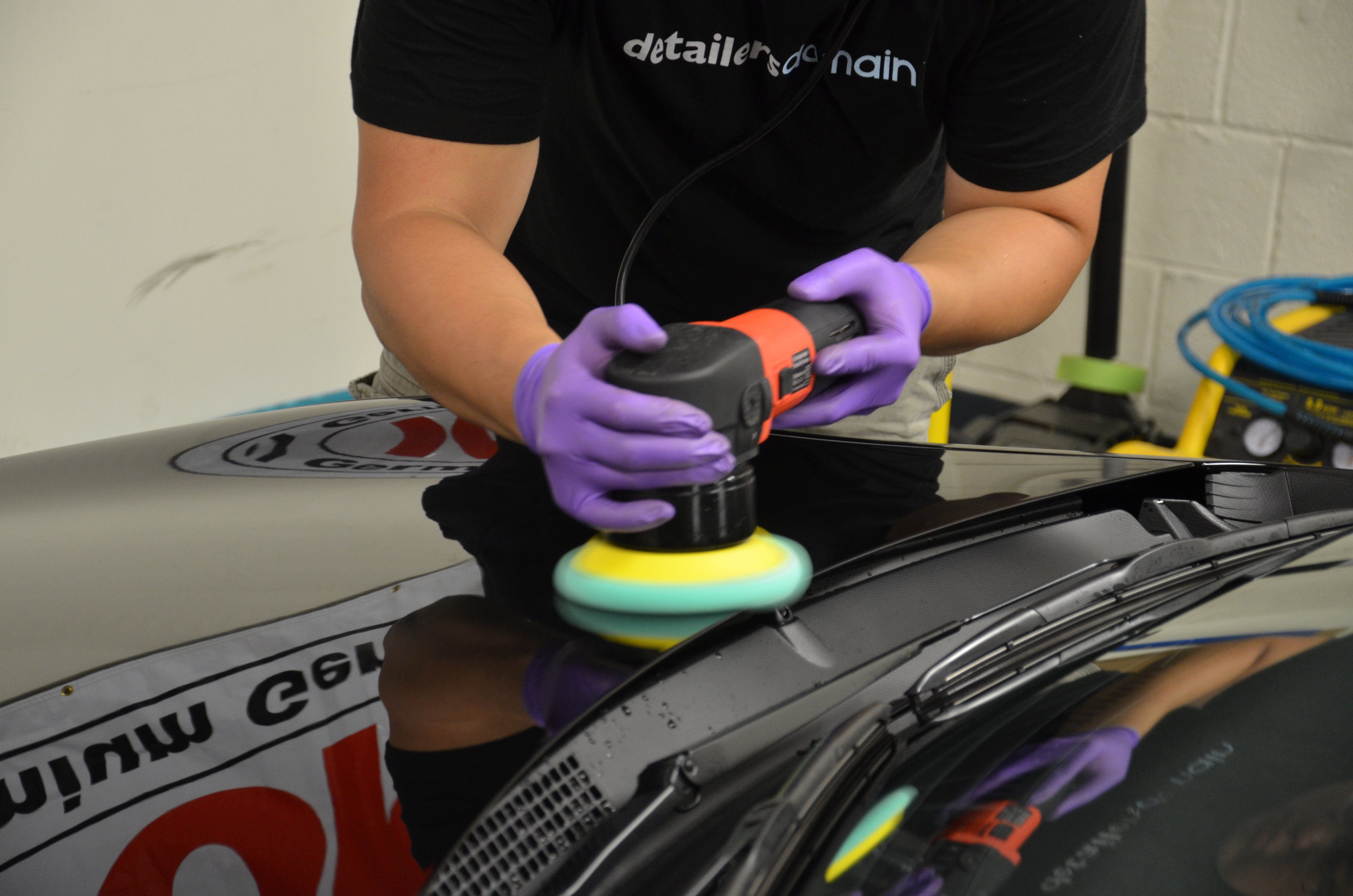

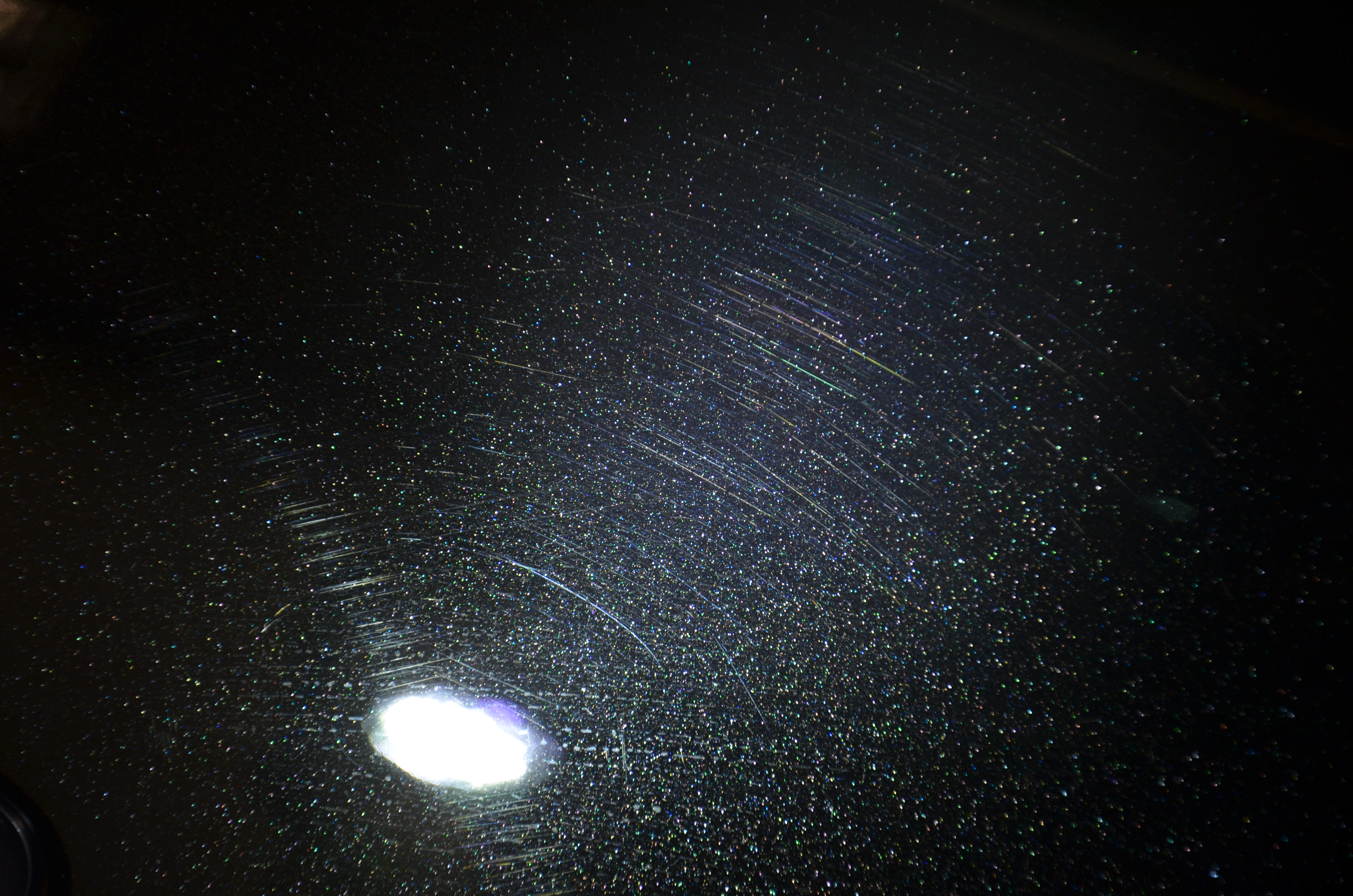

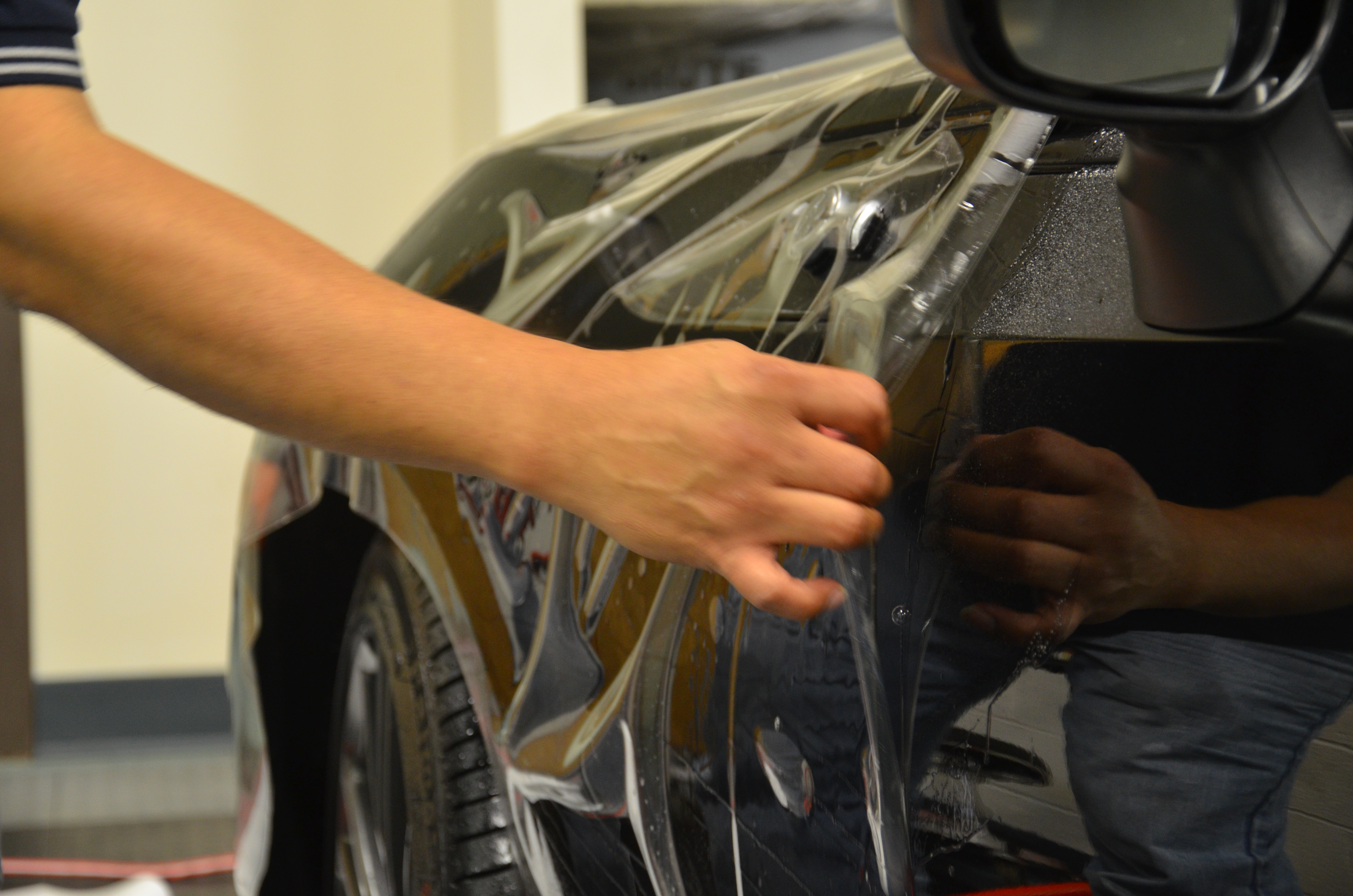

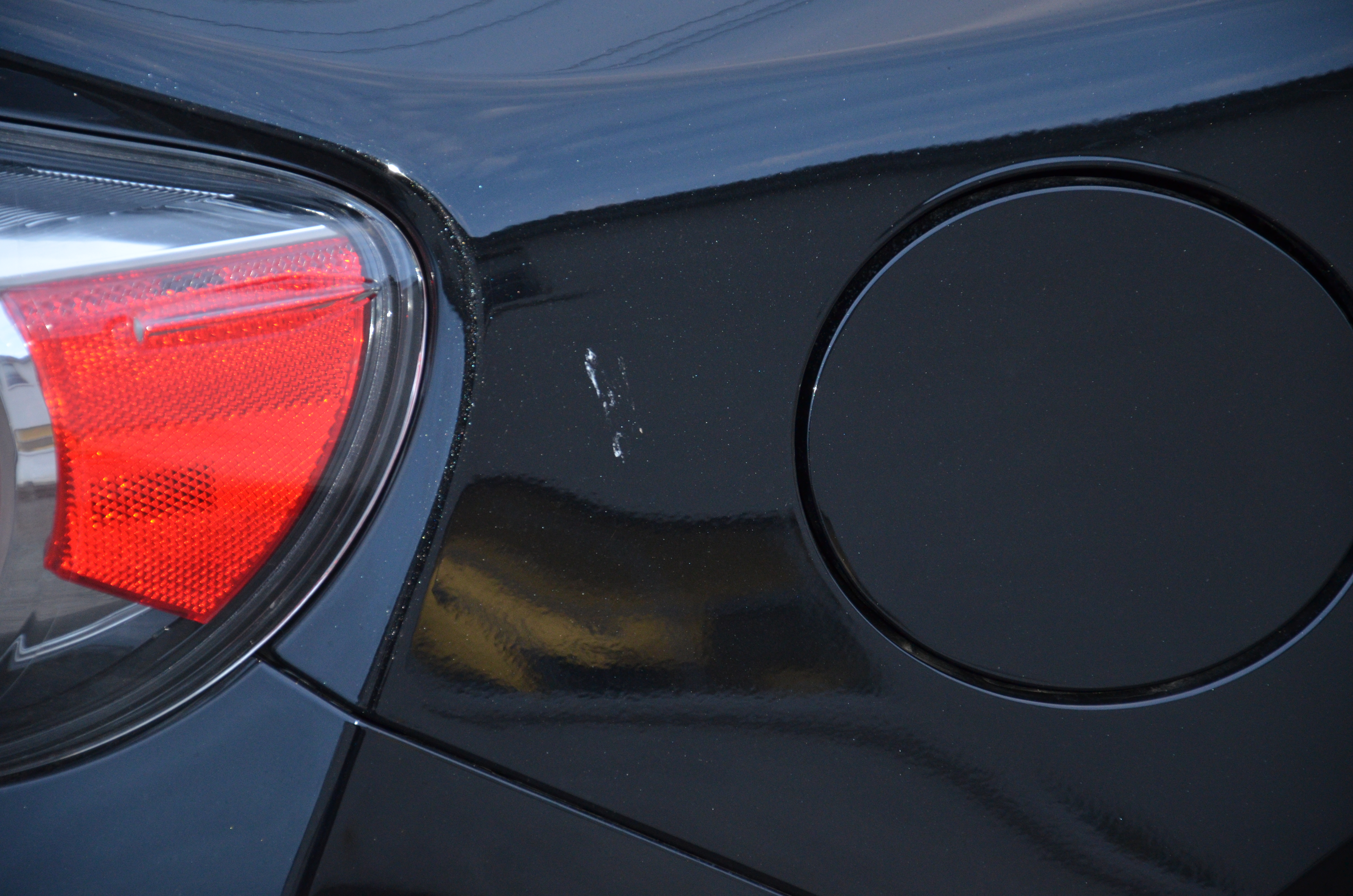

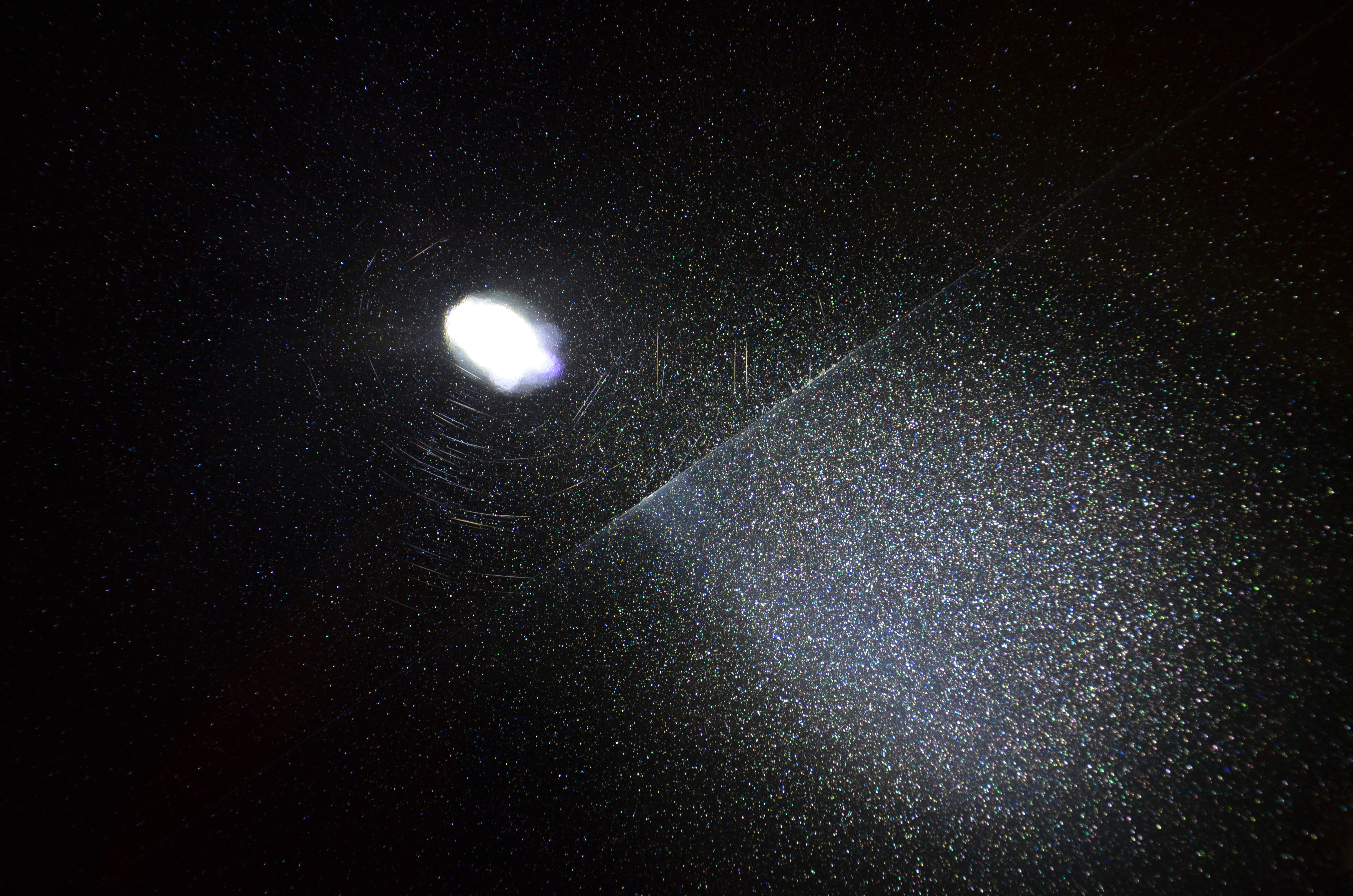

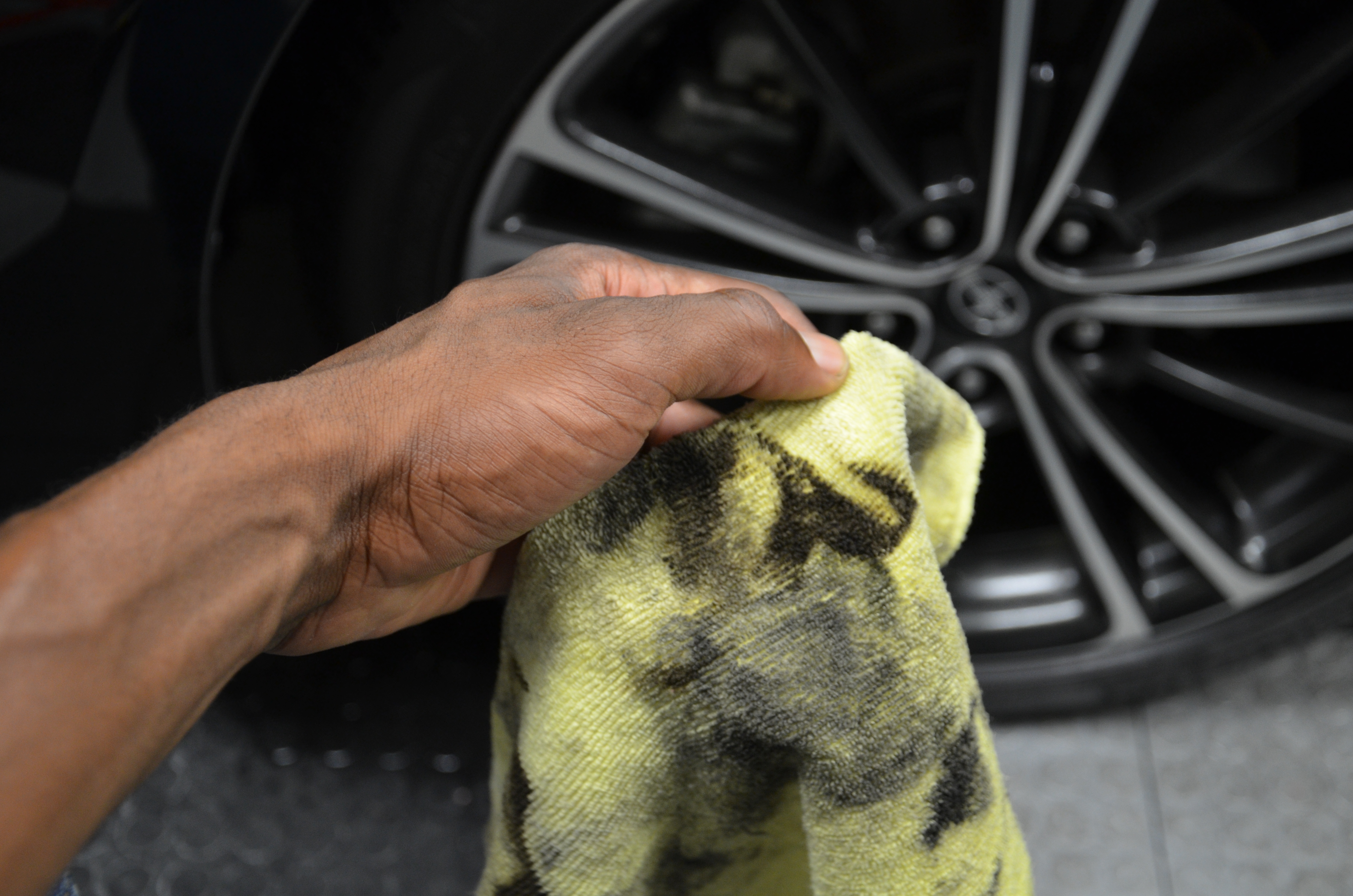

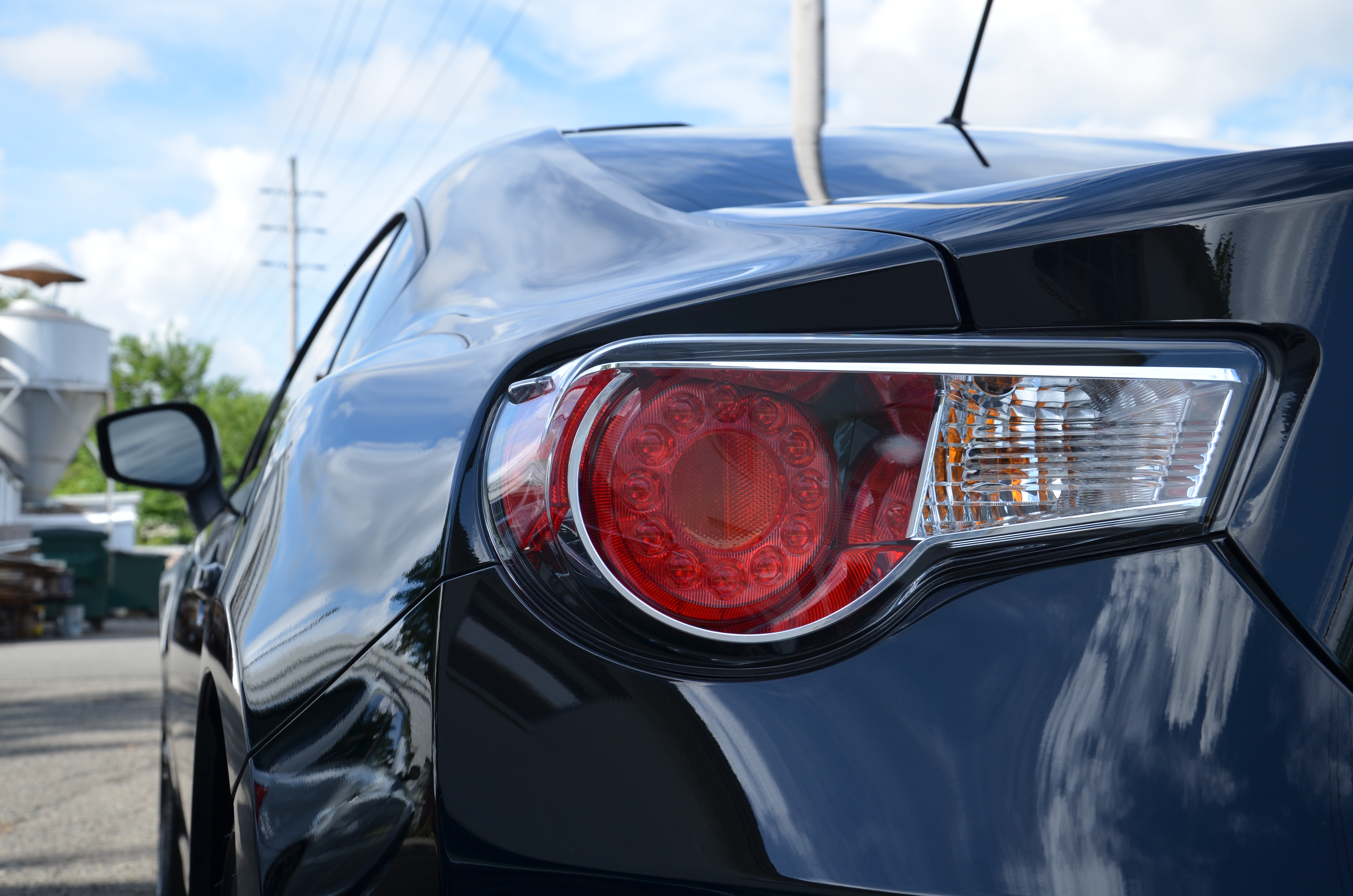

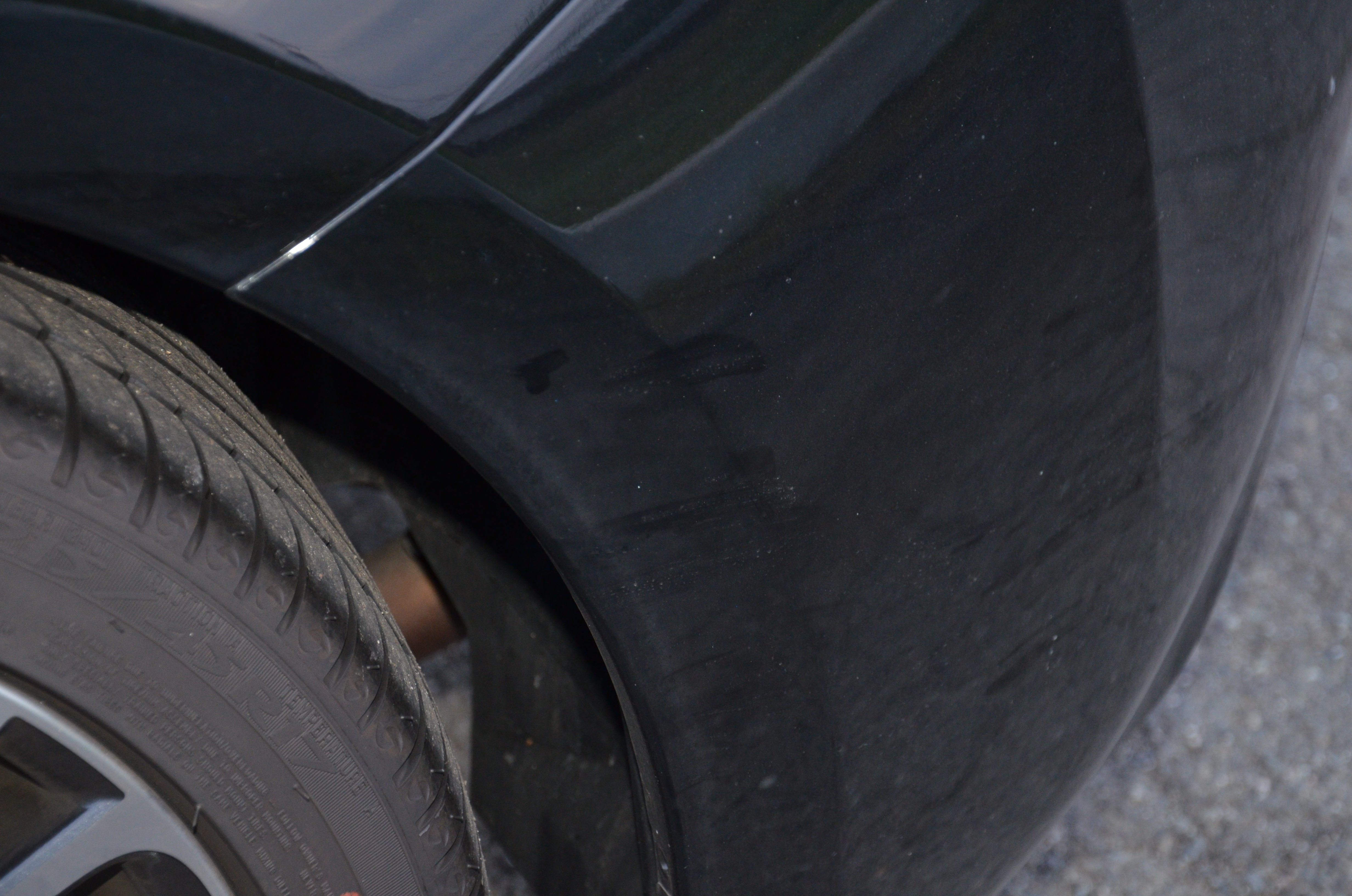

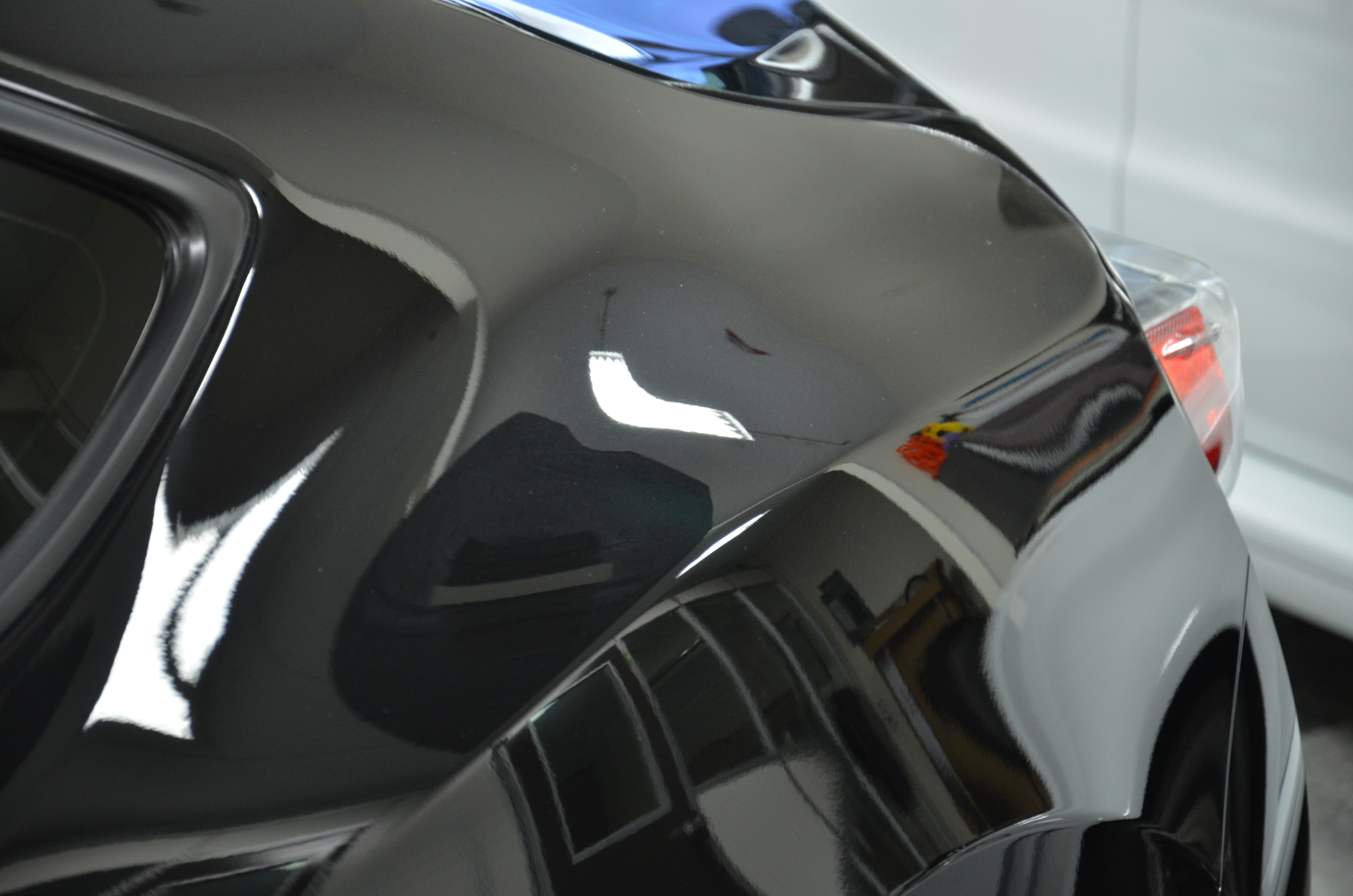

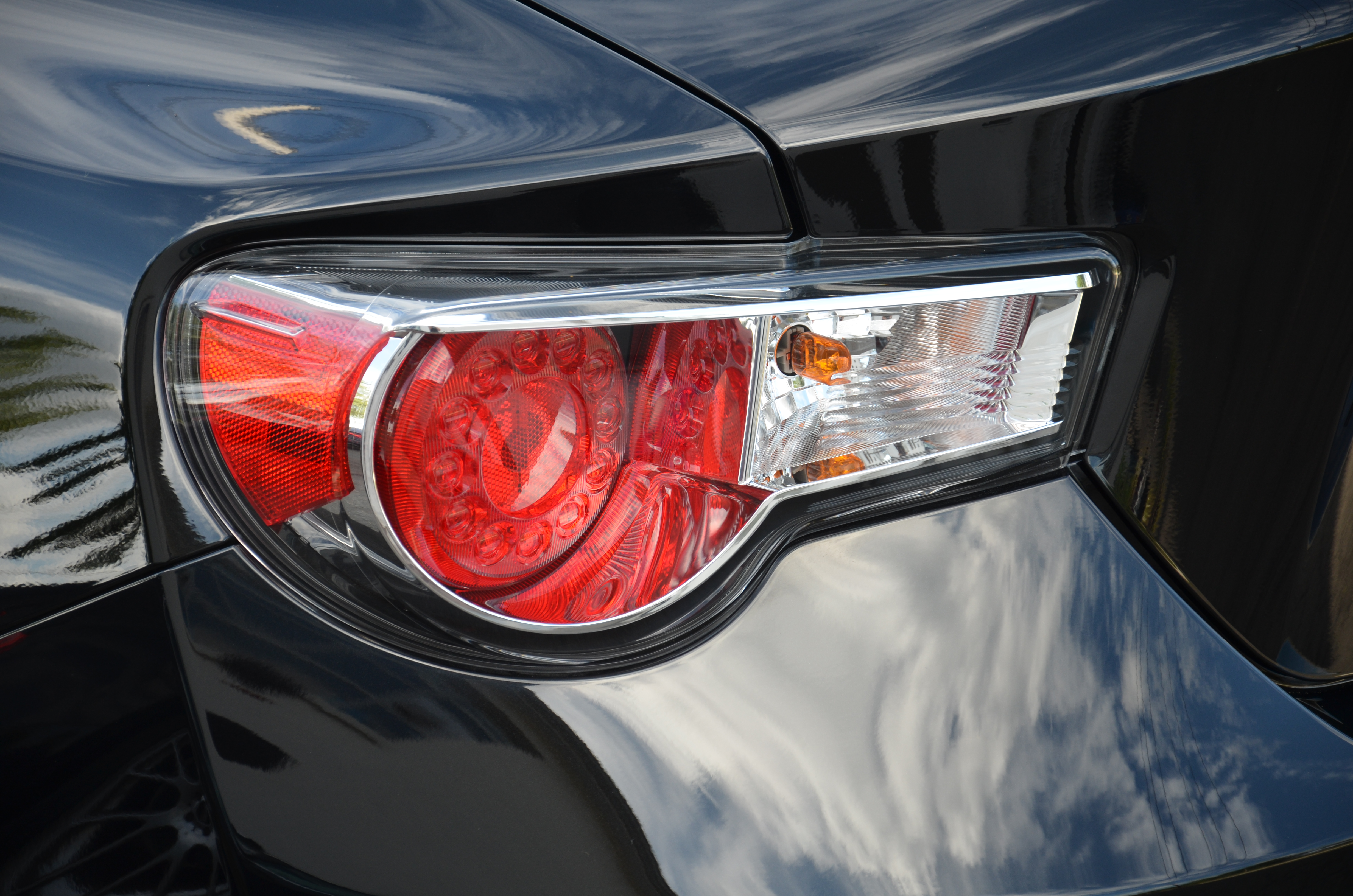

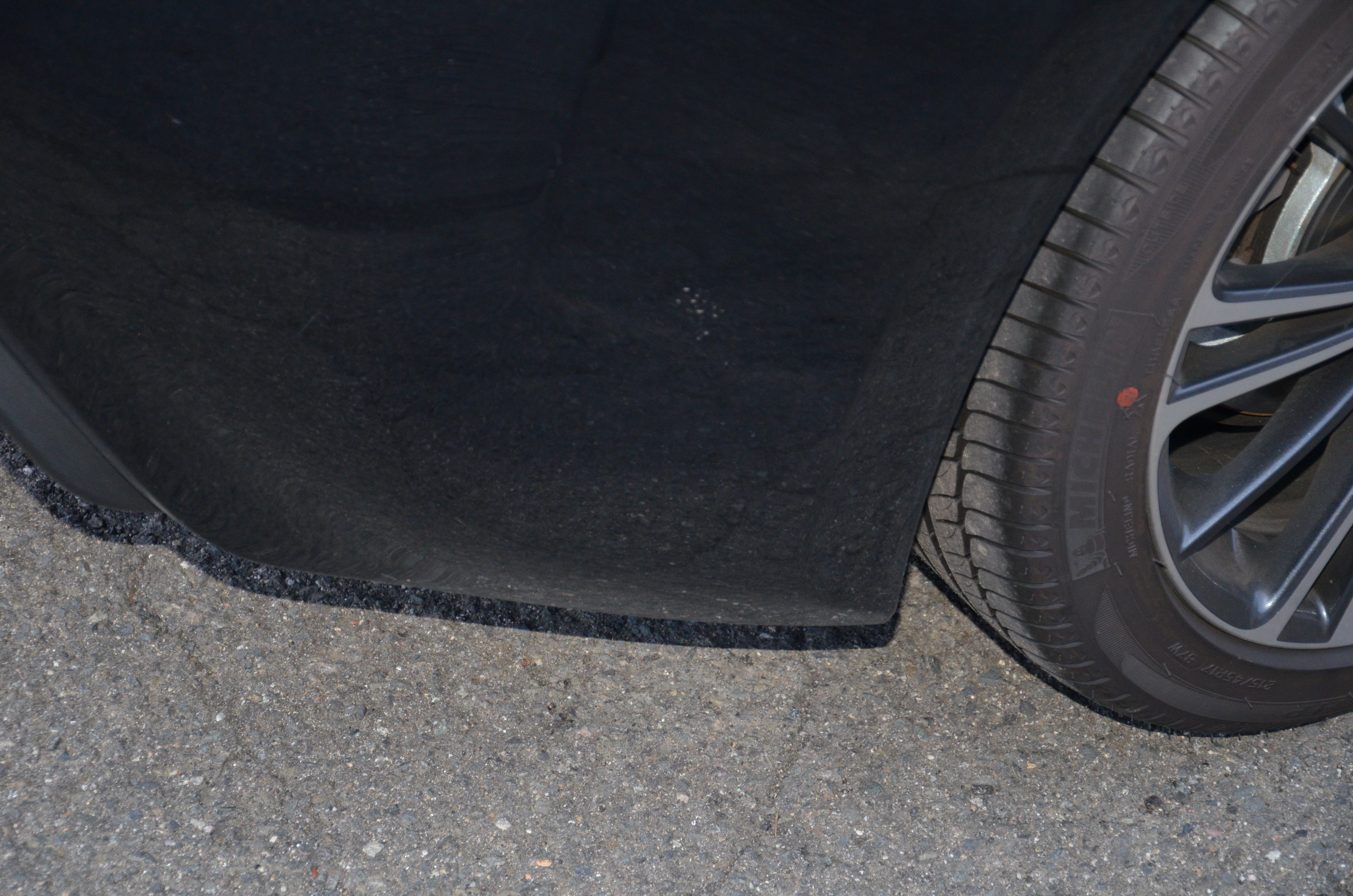

Requirements - Full Exterior Paint Correction/Opti Coat/ Clear Film installation. (Full Hood, Full Fenders, Mirrors, Lights, Door Cups) For a new car this one was in pretty bad shape. The typical sticky paint from the imports made this one tedious to work on Exterior - Wheels were prepped with Sonax Wheel Cleaner and cleaned up with various brushes - Tires were spritzed down with Adam’s All Purpose Cleaner and washed down - Wheel wells were cleaned up - Washed with 1Z einszett W99 - Wolf's Decon Gel - Wash down and rinsed - Door jambs were cleaned up - Nano Scrub AutoScrub - Dried - Tires dressed - Masking - Paint Measurement - Sonax 5/5 Fine Abrasive Paste - Microfiber DA Cut Pad - Griots Orbital - Sonax 3/6 Nano Polish - Uber Green Pad - Griots Orbital - Opti Coat - Inspection with Fenix, 3m Sun Gun, Infratech, and natural sunlight - Wheel wells were cleaned and dressed - Rubber and Plastics Treated - Exterior windows and mirrors cleaned and sealed - Exhaust tips cleaned - Windows were autoscrubed, cleaned, and sealed Products used Links to products used - 1Z einszett W99 Wolf's Decon Gel Sonax Full Effect Wheel Cleaner NanoSkin AutoScrub System Sonax Compound 5/5 - Coming Soon Sonax Nano Polish 3/6 - Coming Soon Opti Coat Adam's Super VRT Optimum Metal Polish Tools used Uber Wool Wash Mitt Uber No Name MF Towels Griot's 6 inch Random Orbital Polisher Uber Buffing Pads Defelsko Paint Meter Fenix TK35 Brinkmann Kranzle Pressure Washer Cam Spray Foam Canon 2 Grit Guard Buckets with Caddies Uber Firehose Nozzle Metro Air Force Blaster Before Attachment 33926 Attachment 33928 Attachment 33931 Attachment 33932 Attachment 33934 Attachment 33937 Attachment 33939 Attachment 33941 Attachment 33943 Attachment 33945 Attachment 33947 Attachment 33949 Attachment 33951 |

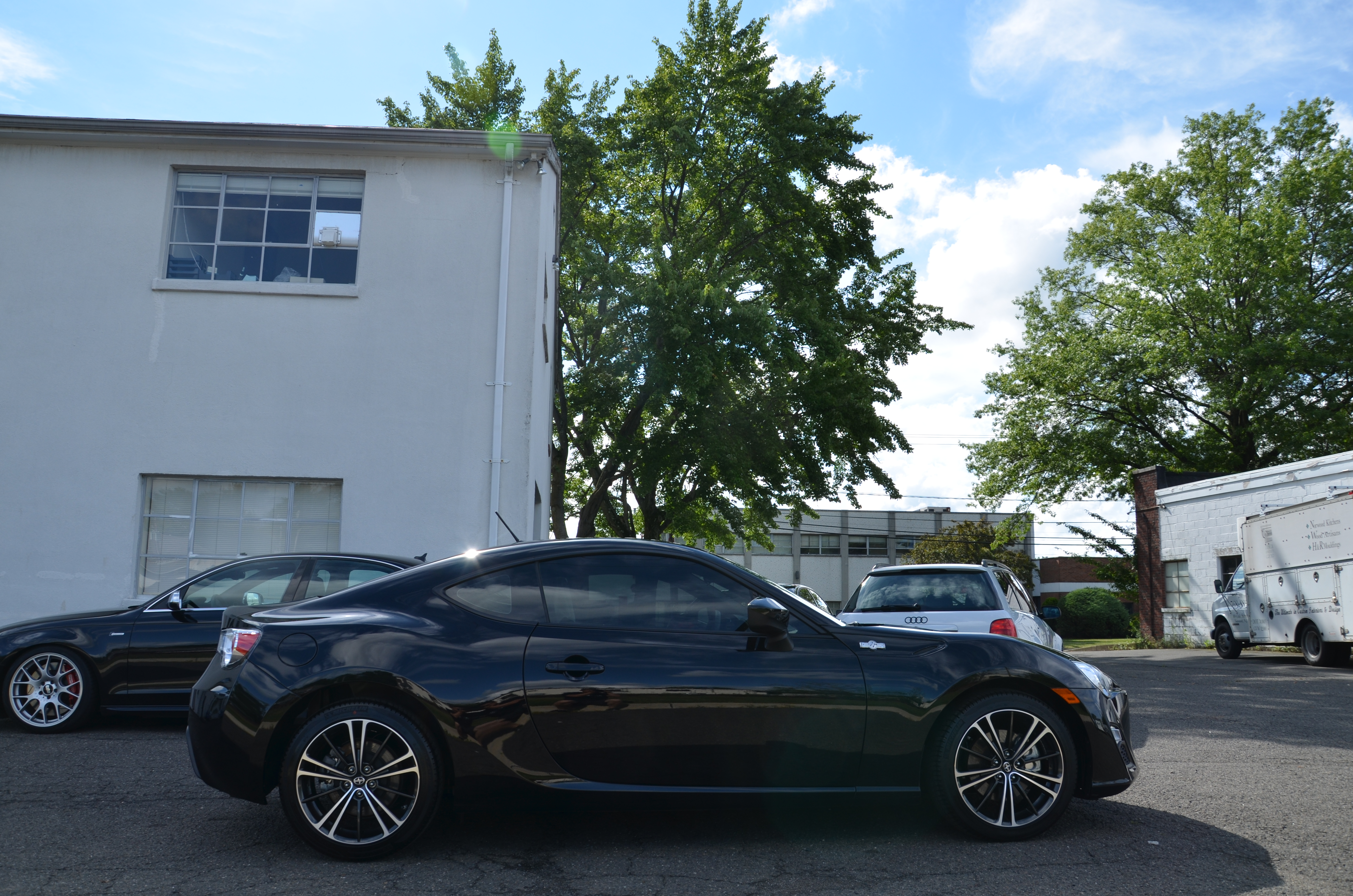

Wow, nice! Cleaned everything up from the factory, and sealed it up!
Thats what im talking about. Great job
looks perfect. awesome job! what did you use on the tires to get the "brown" off of it?
