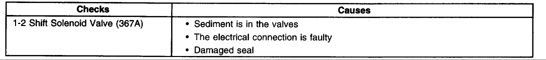

I was unable to find symptoms exactly as you stated in the symptoms diagnosis of my 4L60E ATSG manuals.
Here is one for 2nd & 3rd ONLY or 1st & 4th ONLY:
http://i11.photobucket.com/albums/a1...or_1-4only.gif

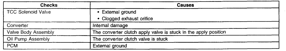

I did find a symptom chart for a "No TCC Release" condition which sounds like what you are experiencing with the "stays locked up" comment.
http://i11.photobucket.com/albums/a1...CC_release.gif
