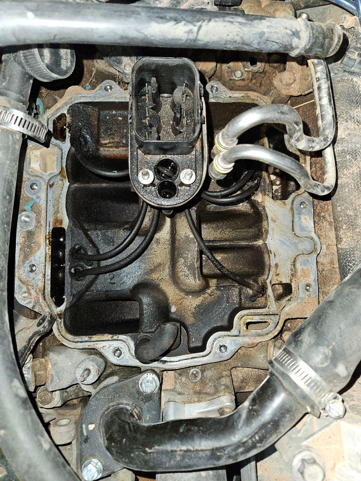

I decided to just get into the plenum. Here is what I can see, please disregard all the crap I dropped in there lol. It seems wet and greasy, like maybe fuel was in there at some point. Im not sure how it is supposed to look. Thanks for looking again! If you look just to the top left, you will see the one connector that decided to disintegrate in my hand.

You are focused, I like it. That is pretty greasy. That cleanish streak up the middle is probably where the current leak is or has been. How many miles are on that spider?

coastie May 11, 2024 08:18 PM
George
Well, I don't know the answer to that. It has 208K on it, I assumed it was never changed. It did have a NAPA fuel pump before I changed it, so maybe it has been replaced. One of the bolts was slightly rounded off on a bracket when I was disassembling, so it could have been gotten into before.
Also on the left side, there are pools in there, like raw fuel maybe, looked pretty nasty I wasn't digging around it just yet.
