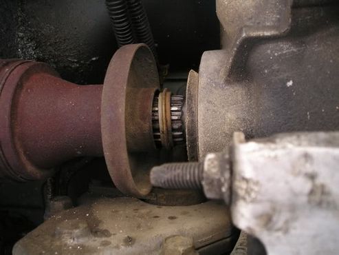

Finally finishing up my transfer case rebuild on my np236. When I removed the front seal to replace, this little ring crumbled. I haven't been able to identify this, or even figure out what it does. Would anybody happen to know what it's called or a part number so I can replace it. Or should I not even worry about it?
I found this picture on here that shows the ring nicely and it's location.

https://cimg0.ibsrv.net/gimg/blazerf...12732930b.jpeg
That’s a dust/water wiper. I don’t think you can buy one. Not 100% sure, if another member has that information and would care to share it would be appreciated. What I have been using for years it this waterproof grease . Put a dob of grease on the end of stub shaft.
