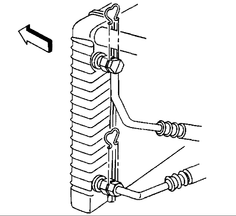

Edit: I was reading the guys problem below me with the leaky rad line. The aluminum lines that go to the oil and the tranny, I am leery on trying to figure them out on how to disconnect them. Chilton's says undo the clip and pull it out; but after fumbling with some needle nose pliers, I'm scared to pry and break an expensive part. (as if this isn't expensive enough). Any advice? They have a threaded 'rosan' type fitting, but also has a paperclip sized clip thats around it. I'd really like to not break these. Thanks.

As far as the clips on the oil lines go, hopefully the illustrations below help:

The illustrations do help; thank you.

Like swart said, the tranny cooler lines are easy to get off, even at the tranny end with the quick clips. I had to pull my tranny to rebuild it and didn't know aobut the quick clips until after I got it out. Trust me, the quick clips are much easier than removing the exhaust system to get a wrench in there.
