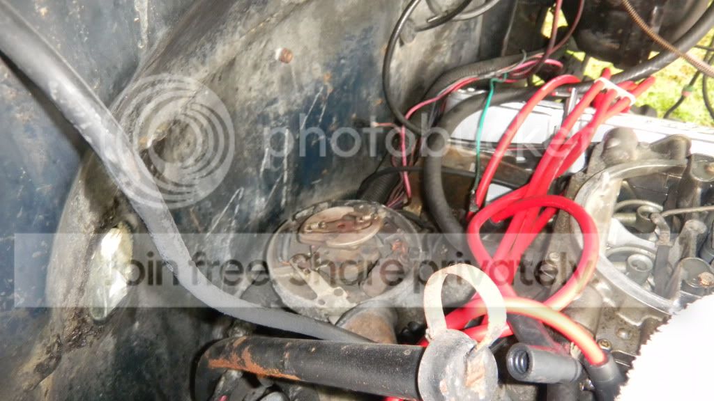

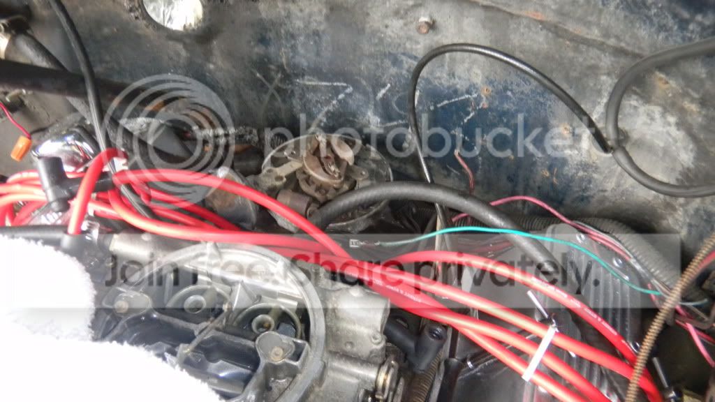

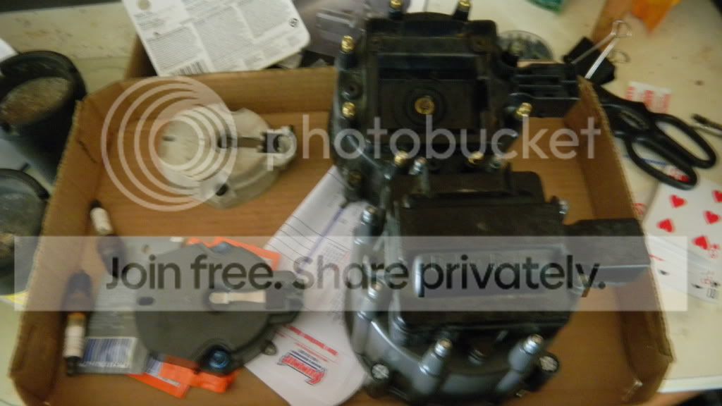

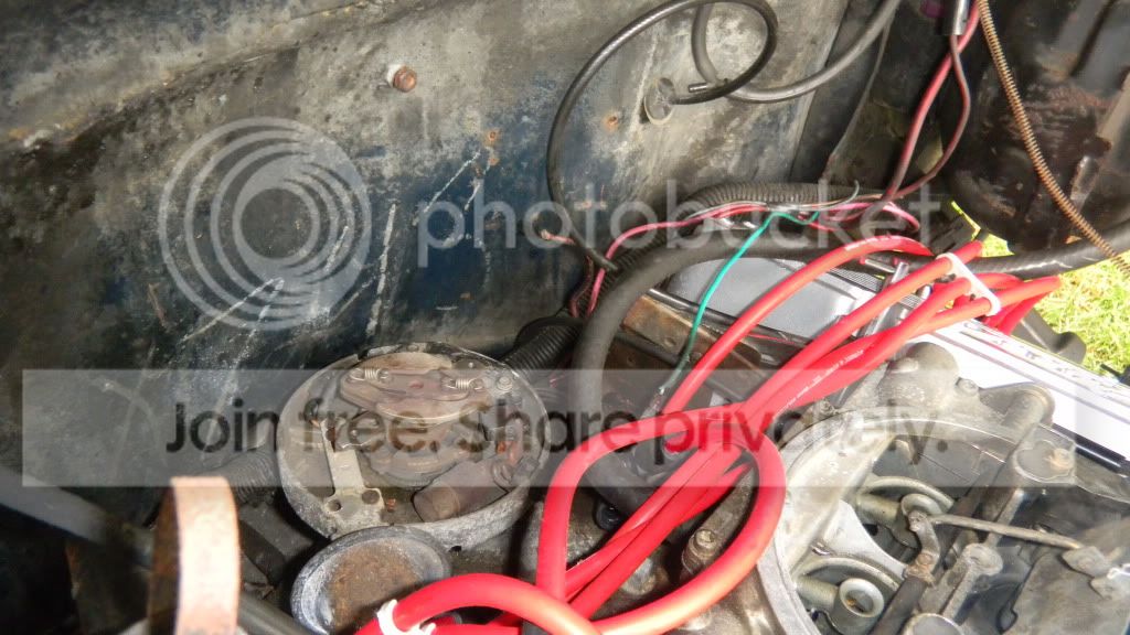

I've looked all over for the casting number and still cant find it, so all I can really say is its a 400, according to him. So honestly I could say I am not 100% sure whether it is a 400 or not.
Here are some pictures of the setup, hopefully they help...
Old One on top
Any help is appreciated...thanks!
Sometimes it can be difficult to get the distributor cap to sit properly onto the base of the distributor. This is especially true on lifted trucks (never had an issue with this on my Chevelle).
I am wondering if you may have not gotten either the cap or the rotor fully seated into its proper position which may have caused the collision...
Yea that could definitely be it. I am taking off the fender today(it needs replacement), so once I take that out I will be able to walk right into the engine compartment and make sure it is set right.
I also want to mention the engine did have a tap before, when I first got it, but I took that to be a valve or something, but I wonder if it was the distributor cap as well? The old distributor cap had a spot carved out too for the rotor to spin. Which really makes me wonder if I have the correct cap.
