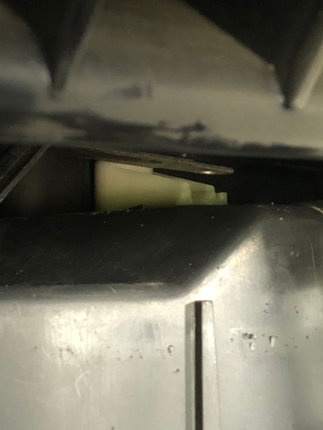

The upper hose is too hot too touch at the moment. I still don’t get the heat it supposed to give. I read the codes and it’s giving me a P0128 which is coolant thermostat. However, I replaced the thermostat so not sure why I’m getting that. The engine light did come off but still don’t get heat. I had a look at my HVAC motor, I see all the actuators moving but I did discover that a little piece of the motor broke off. See pictures. This probably needs to be attached? I’m not sure if these problems can relate.
https://cimg9.ibsrv.net/gimg/blazerf...45ee6a0d9.jpeg
https://cimg2.ibsrv.net/gimg/blazerf...1cbc65bbb.jpeg
