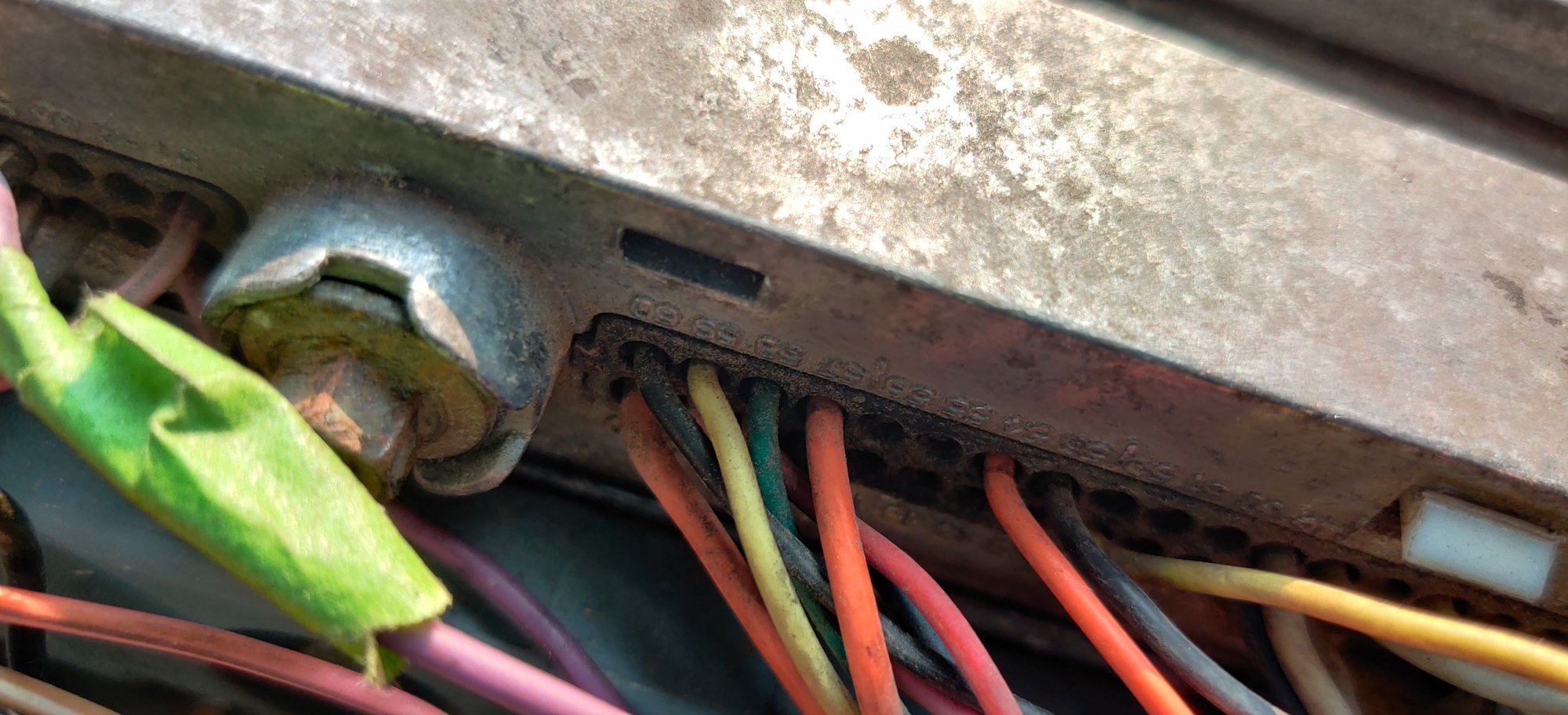

Hey I posted here a few months ago about a blazer I got, some mice chewed through the PCM harness. I'll have to go back and refer to my diagram (haven't looked at it in a while), but when rewiring the PCM I had one leftover wire coming out of the harness that was SUPPOSED to go to the EGR. I want to say it was brown. The problem I had is, there is no pin in that slot on the PCM connector and no severed brown wire anywhere to tie into. What's up with that?
Do I really need it?
my mpg is only 17mpg at the moment which seems low to me... But it's my first 4.3 and blazer. so is the the fact that the egr is physically still hooked up and potentially allowing unmetered hot exhaust back in affecting my MPG?

Ok here was my OP back in May, it has the diagram I am referring to. The 2001blazer.pdf. If I remember right I have a brown EGR wire and no pin in 55. It's not just missing, it's capped off like all the other slots that don't have wires.

I don't have a cut brown wire, or a pin, only a plug in slot 55. That's my issue lol. I'm wondering if it was tied into another wire somewhere, not necessarily on pin 55. Like a voltage wire or something.

To clarify, I was mistaken about the year in my OP I linked. i hadn't picked up the truck yet or the title. So it is a 2001 and I followed the 2001 diagram.
I'll snap a pic later. Break is almost up. But most, if not all of the red pcm connector was eaten by mice. I backprobed everything with multimeter, every sensor and wire, and found continuity between sensor and the split at the pcm. Everything works and is accounted for except for that weird brown EGR wire.

In Post #7 of your original thread that you linked to you said you used a 2000 wiring harness in your 2001. Well, year 2000 does not use pin 55 for the EGR (hence the plug), and the rest of the EGR wiring is wrong as well. You need the 2001 wiring harness.
Compare the two schematics - 2000 vs 2001. All the wires go to different pins on the PCM.
What split are you talking about - there is no split I can identify. Brown wire goes to Connector C1 pin 55 to tell the PCM what position the EGR valve is in. I think you will find a brown wire in connector C2 pin 10 of the 2000 harness - but it's not so simple as switching that one wire (all of them are wrong).
2001 Blazer used the 12200411 PCM (this is the 411 PCM the tuners talk about swapping in). 2000 did not. Different PCMs. Not the same PCM and not the same wiring!
