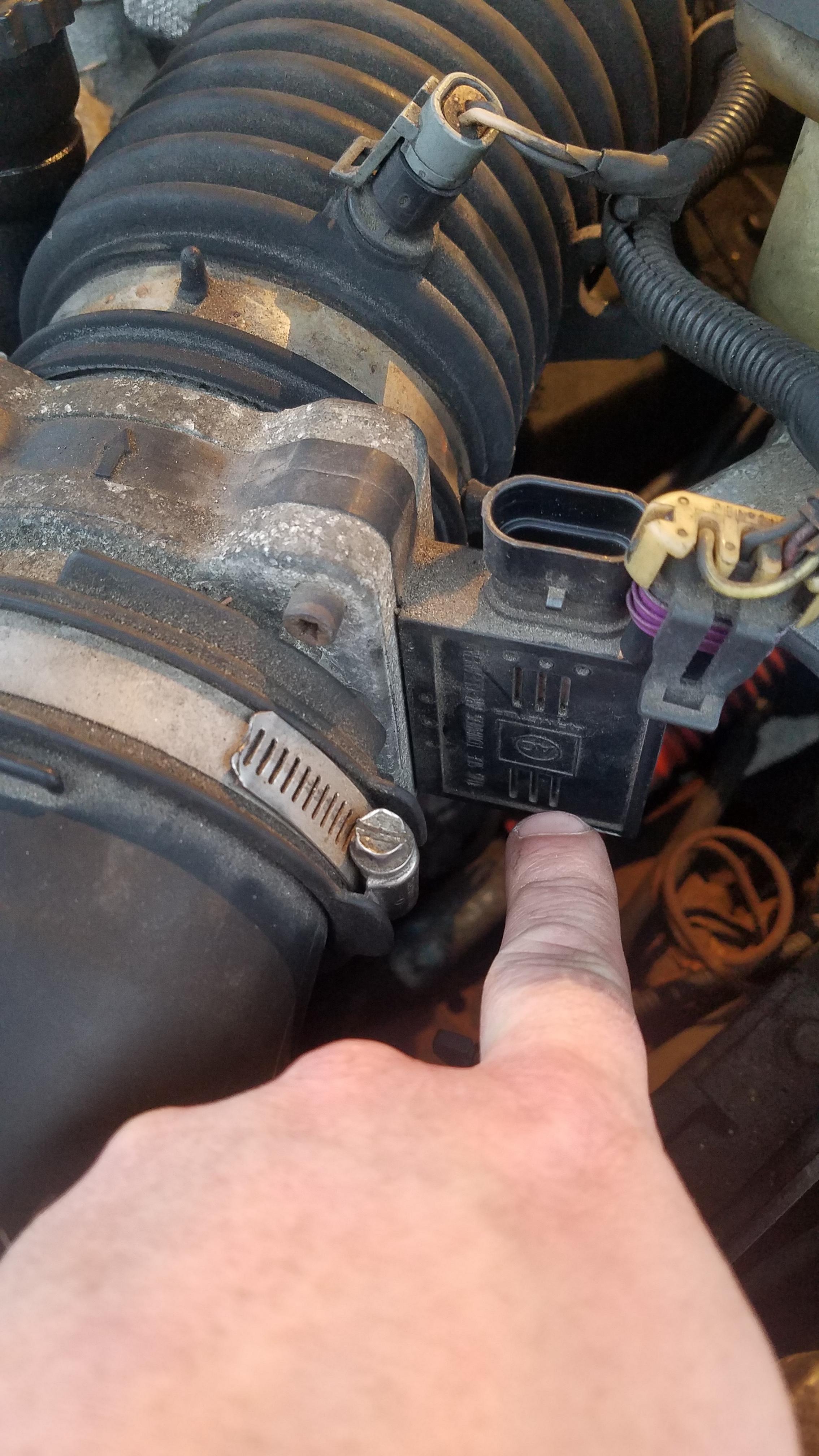

What sensor is this?
Hi there. Presently.. When I unplug this sensor.. it sets a code, yes, but it idles fine and does not stall at lights.
When I plug it back in, it runs somewhat irregularly, surges sometimes, sometimes stalled at lights, and makes an intermittent misfire that seems to be localized to Cylinder #2. But it does not misfire all the time. (Thankful to the Lord for that.)
What is that sensor called? And what is up with the intermittent misfiring, that started as P0300 ?

That is your MAF sensor, as in Mass Airflow Sensor. I would do a search on here as more than a few folks have had the same problem you are now experiencing. First thing I would do is to clean the wire, again, do a search as this has been covered many times on here.
blazen_red_4x4 03-31-2020 08:24 PM
As AJ said, MAF, or Mass Air Flow. And you can try pulling it off and cleaning it, there are spray cleaners specifically for it. If you end up replacing it, I would suggest trying to buy an OEM used one from a junk yard before putting a brand new aftermarket one made in China on it. The original ones really don't have too many issues, it's not super common for them to actually go bad. But the knock-offs are known to give people issues...
The engine computer relies on readings from the MAF to adjust fuel delivery and spark. A misreading one because it's dirty or if it's just bad, can definitely cause worse running conditions if it's plugged in because it's sending bad readings to the engine computer. When it's unplugged, the computer resorts to a default set of parameters, that although are not optimized and that's what will cause the running issues and terrible gas mileage with it unplugged, it will at least run.

While cleaning the MAF might be a good idea if diagnosis shows that it is an issue, if not done carefully, you could damage it rendering it inoperable. So until you fix the other glaringly obvious issues with the intake ductwork and missing throttle body retaining bolt, I wouldn't poke that bear...
As far as running with the MAF disconnected... You certainly can, but as I stated previously, I would not recommend driving the truck around with a massive unfiltered air leak in the intake ductwork that could suck in all kinds of unknown crap floating around under the hood. That is unless you want to be looking for another engine if something nasty gets pulled in. Currently, the closest thing holding your 'hat' on is your hood...

Okay, cool. I actually did also obtain the screw. I ca. try cleaning it carefully...
My only next question would be.. would a wonky MAF sensor also give random misfires?

And a bad MAF can cause random misfires if it causes the engine to run too lean. But a loose intake "hat" can cause the exact same symptoms.
